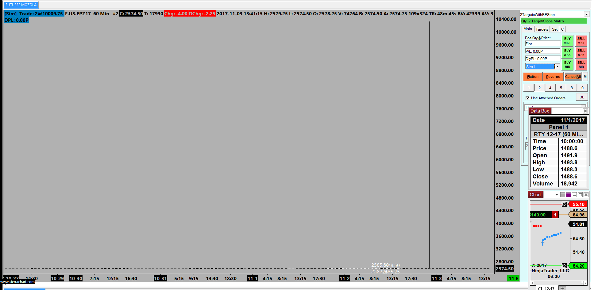

- when I scroll the chart horizontally, when the scroll bar is all the way at the right side, the chart and the bars suddenly goes flat, the screen only shows a flat line - so you have to be very specific, where to stop scrolling and this is a bit annoying - is there a fix or setting for this?
This is not normal. There must be some kind of data problem or multiplier setting issue. When you notice this, provide an image of the chart following these instructions:

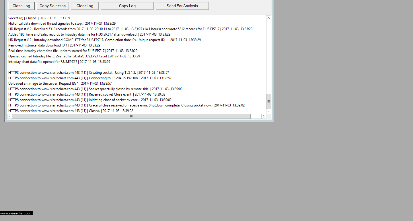

http://www.sierrachart.com/image.php?Image=150971637599.png
[2017-11-03 13:41:28]
User859795 - Posts: 51
http://www.sierrachart.com/image.php?Image=1509716475898.png
[2017-11-03 16:02:30]
Sent the requested chart screen image above!
In addition to the collapse of the bars problem, i tried and installed the platform on my laptop - i don't have any issues!!!
this problem only occurs on my VPS or like you said, i changed something in the platform settings that causes the issue.

[2017-11-03 16:30:28]
There is a data error in the chart. Refer to help topic 2.1.2 about this:
https://www.sierrachart.com/index.php?page=doc/helpdetails2.html#h2.1.2
[2017-11-03 17:53:51]
This fixed the problem, thank you for the quick help!!!
