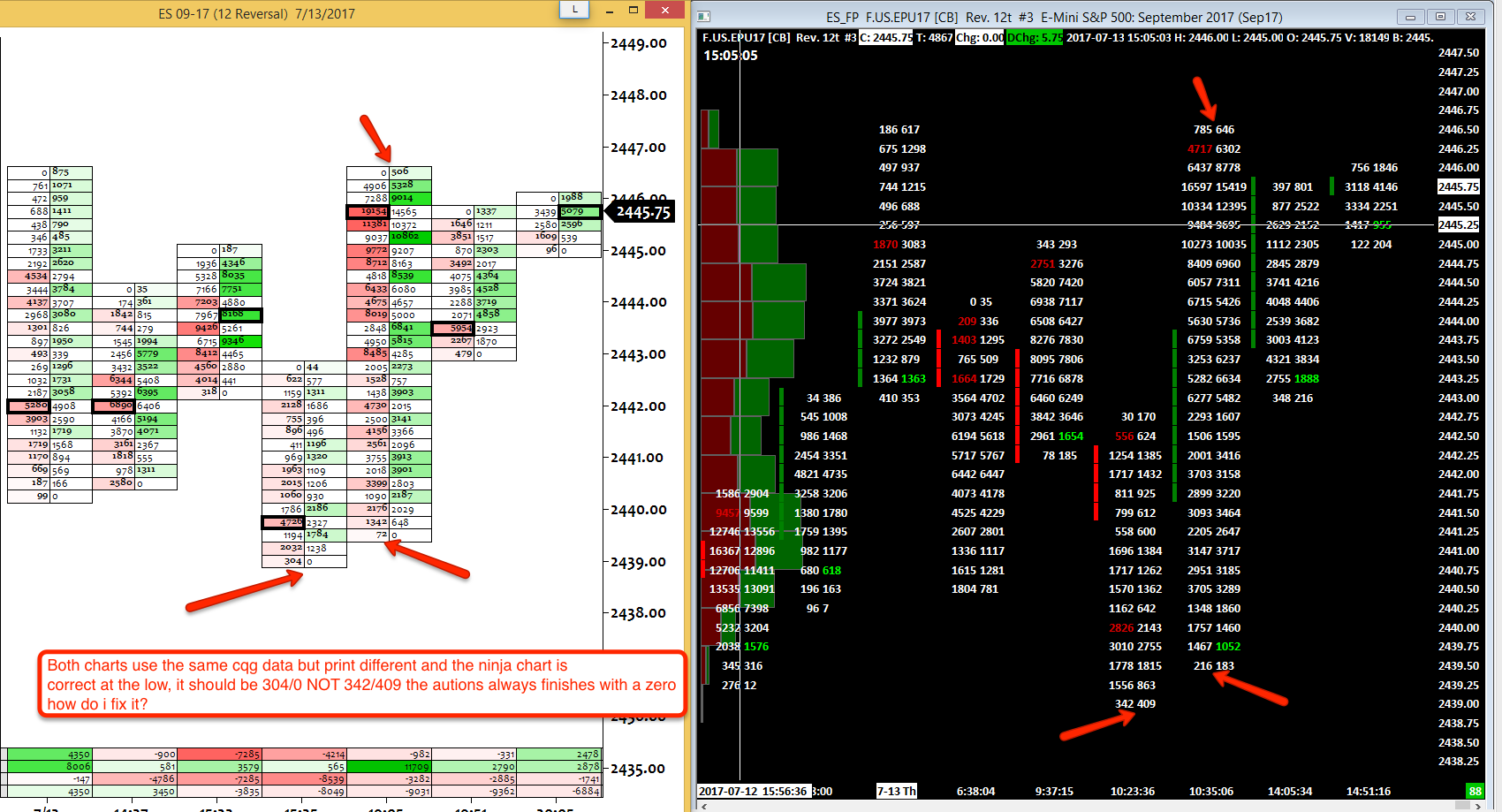

The footprint chart does not print the correct data at the top and low of a bar?
image2017-07-13_2005.png / V - Attached On 2017-07-13 22:01:43 UTC - Size: 271.19 KB - 2902 views

You need to set Sierra Chart to a tick by tick data configuration. Refer to:
This is what we see:
http://www.sierrachart.com/image.php?Image=1499984622854.png

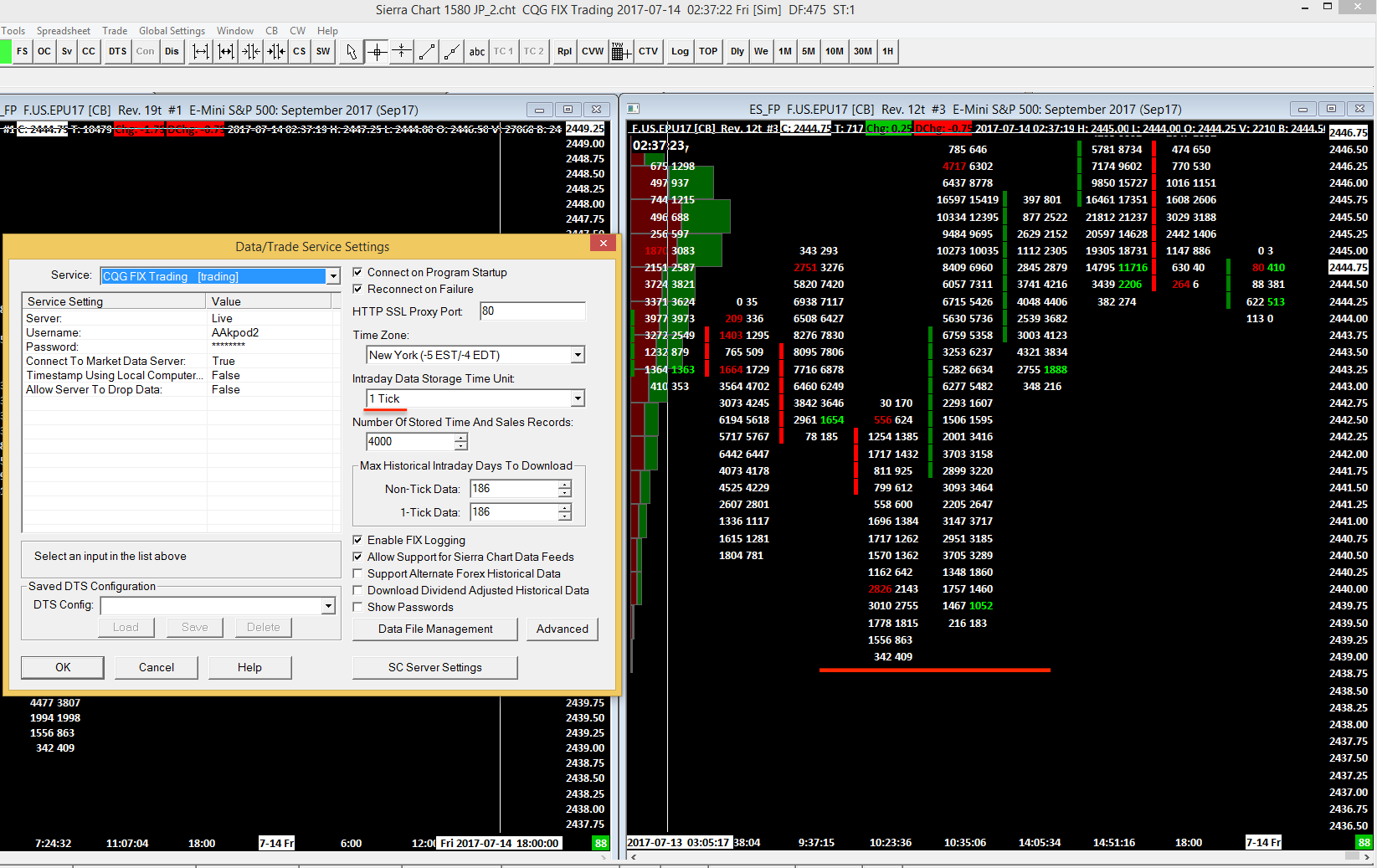

User840004 - Posts: 30
It is set to 1tick but still having the same issue?
Second question how do I reduce the gap between the price axis and the footprint chart?
image2017-07-14_0737.png / V - Attached On 2017-07-14 06:43:16 UTC - Size: 221.23 KB - 607 views

You also need to re-download data explained at step 7 here:
Tick by Tick Data Configuration: Instructions
For the second question, refer to:
Working With Charts: Removing Right Side Fill Space

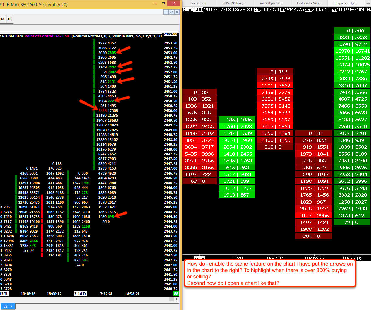

[2017-07-15 08:08:42]
How do I enable the features on the attached chart?
image2017-07-15_0859.png / V - Attached On 2017-07-15 08:08:05 UTC - Size: 188.29 KB - 771 views

Here are the instructions to use the Numbers Bars study:
Numbers Bars: Step-By-Step Instructions
You need to use the Text Coloring Based on Dominant Side AskVol BidVol Percentage Text Coloring Method:
Numbers Bars: Text Coloring Based on Dominant Side AskVol BidVol Percentage
Make sure you are on the latest version of Sierra Chart. Update with Help >> Download Prerelease.
Date Time Of Last Edit: 2017-07-17 15:14:22
