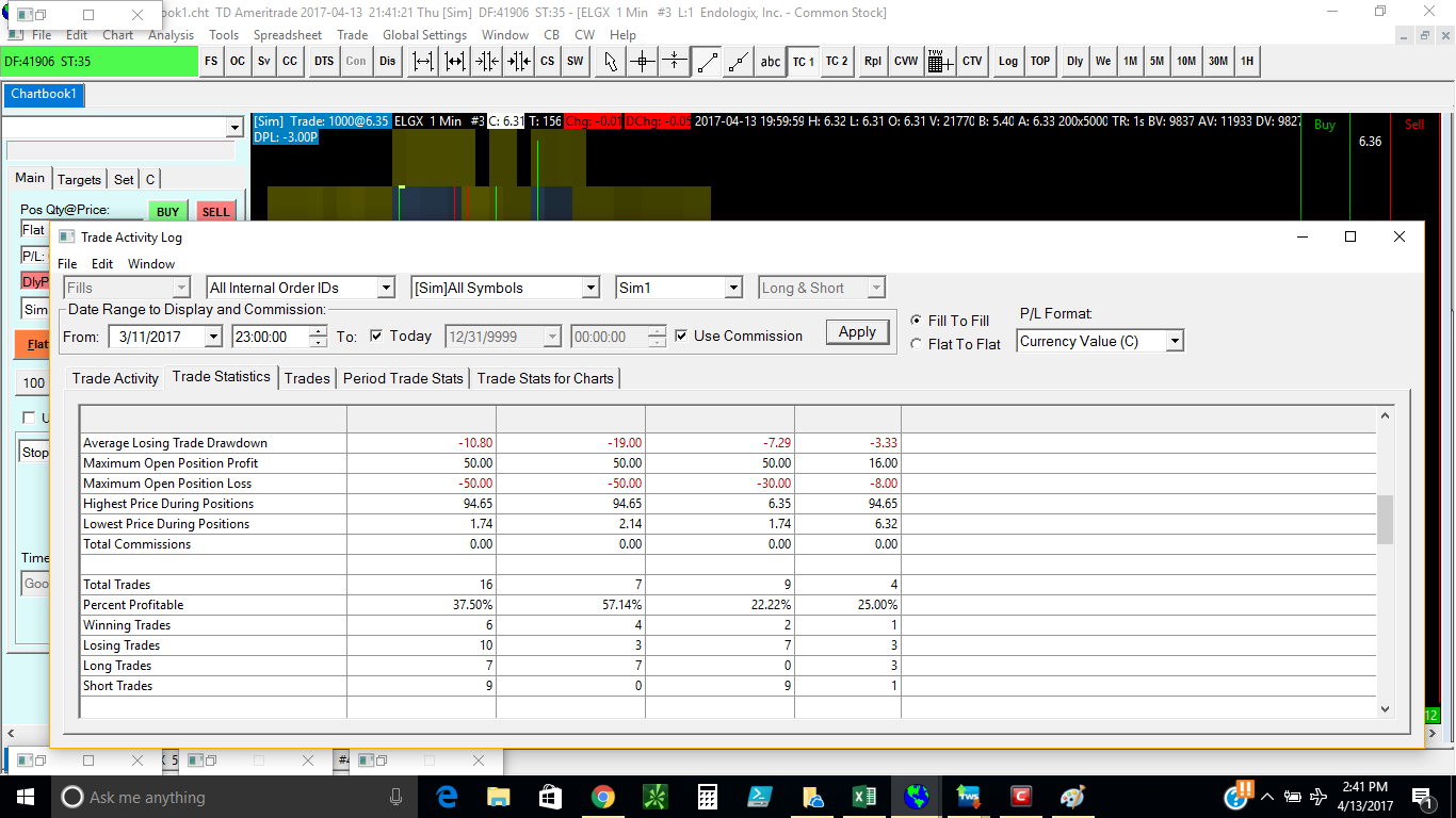

I can't seem to get any commissions to show using the steps provided. Is there a preferred method to entering a US equity symbol? e.g. $GNC or GNC?

Specifically you will need to use the Trade Statistics tab of the Trade Activity Log:
http://www.sierrachart.com/index.php?page=doc/TradeActivityLog.php#TradeStatisticsTab
Here is the information about the Use Commission setting:
http://www.sierrachart.com/index.php?page=doc/TradeActivityLog.php#UseCommission
The symbol should be entered in the Global Symbol Settings exactly as it is used with the chart.

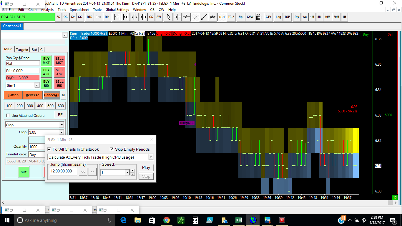

I still don't know what I'm not doing right here. I'm stumped. Here's my screenshots of how I have made a simulated trade and I believe I have the settings right, but no commissions added. Thanks for the help with this.

[2017-04-13 23:17:57]
At the top of the Trade Activity Log, for clarity you really need to select a specific symbol instead of "All Symbols". That may not be the issue but do that anyway.
This is also from the documentation:
Since this is a round turn commission, it applies for every 2 units of the total filled quantity for a Trade. Therefore, if you set a Round Turn Commission of 1.00 and you buy and sell 10 shares or contracts, then this will be a total quantity traded of 20. The commission will be 10 in this case and the amount will be deducted from the Profit/Loss reducing the profit and increasing the loss.
In the case of stock shares where the quantities are much higher than futures, you need to take this into consideration when determining the commission value. For example, you may want to set a commission of .01 which would apply per share. So a trade of 1000 shares would have a commission of 10.
If there are any changes to the commission value in the Global Symbol Settings window, then to see these changes applied to the Profit/Loss calculations, select Edit >> Refresh Log on the Trade Activity Log menu when the Trade Activity tab is selected.

Hi, changing to a specific symbol doesn't change whether or not the commissions are shown, no commissions are visible. Changing the Round Turn Commission value and refreshing the Trade Activity Log also does nothing. Thanks.

There must be something not correct about the Symbol Settings for that symbol you added. We also see that you apparently deleted symbol settings.
Perform a Full Reset of the symbol settings following the instructions here:
https://www.sierrachart.com/index.php?page=doc/GlobalSymbolSettings.php#FullResetSymbolSettingsSteps
Enter the Round Turn Commission on the ???? symbol pattern to match 4 character symbols. This will work.

I preformed a full reset as directed. Can you please clarify what you mean by "Enter the Round Turn Commission on the ???? symbol pattern to match 4 character symbols." Thank you.

In the list of symbols on the Global Symbol Settings window, you will see a ???? symbol.
It definitely should be listed there.

Yes, I see it but what do you mean by Enter the Round Turn Commission on the ???? symbol pattern to match 4 character symbols.
[2017-04-14 08:08:26]
After selecting that symbol in the list, then you go to the Additional tab and enter the Round Turn commission there.

Unfortunately, it's still not working. I think I've about given up on it. Thanks for trying.

There should be absolutely no trouble with this at all. We just ran a test without any problem. We set a Round Turn Commission of 1 on the ???? symbol pattern which matches with four letter stock symbols.
We went back to the Trade Activity Log and selected the Trade Activity Tab and selected Edit >> Refresh Log and then went back to Trade Statistics tab to view prior taken trades for a four letter stock symbol and there was a nonzero Commission value.
We could use a brief remote assistance session to see where you are going wrong.
