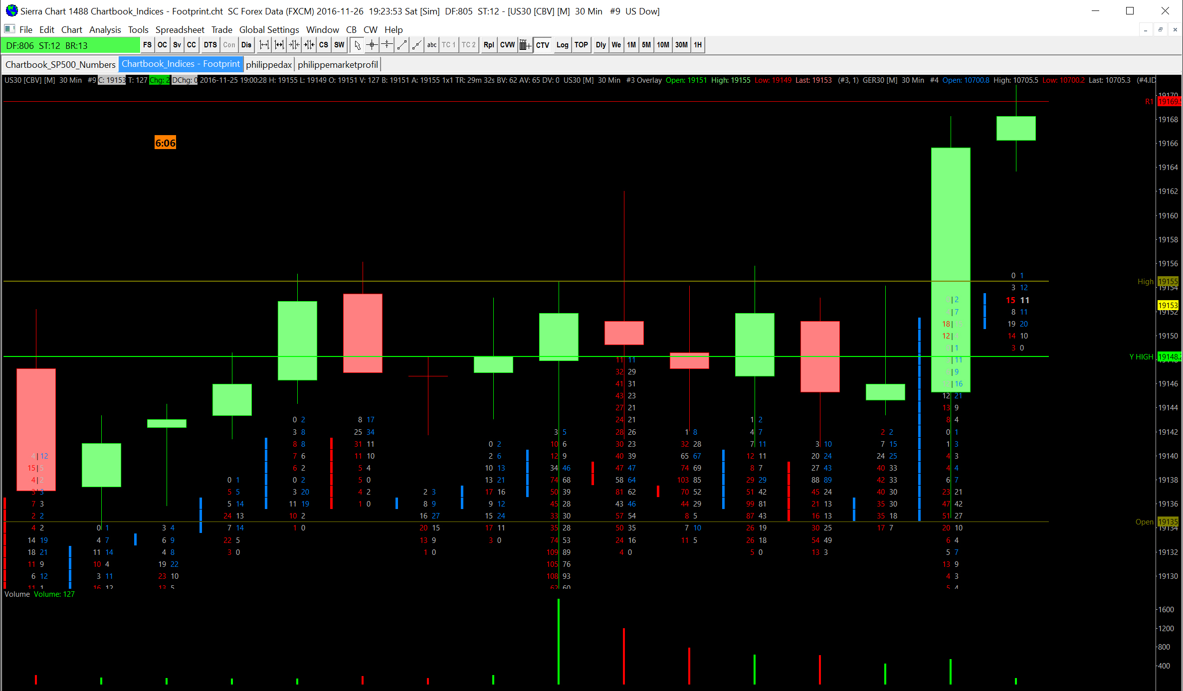

[2016-11-26 18:29:05]
isa74 - Posts: 54
Sir,
I have used the Overlay Bar and choose the right chart number and region.
2 questions:
> according to the height i decide to choose on my graph( by control+ left mouse click on the right vertical tab values), my footprint and the candle are not 'synchronised'.
I might all the footprint datas to up or too down. How can I be sure that the candles and the values are placed perfectly ?
> how can i change the fill colors of the candles ? can I set up a level of transparency ?
If I want to have only the outlines of each candles and keep the fill the same color as background ?
I have modified the colors on Global Settings > Graphic Settings, but nothing occurs.
Thanks !
imagesc_Sierracharts_Interface_Footprint_Overlay.jpg / V - Attached On 2016-11-26 18:25:07 UTC - Size: 921.66 KB - 527 views
[2016-11-26 20:07:22]
Based upon what you want to do, remove the Overlay study from the chart.
Follow the instructions here to open the Input Settings for the Numbers Bars study:
Numbers Bars: Input Settings for Numbers Bars
Set the Open and Close Marker Style to Candlestick Outline. Be sure to read the documentation for this particular Input setting to understand other related settings you need to set.
