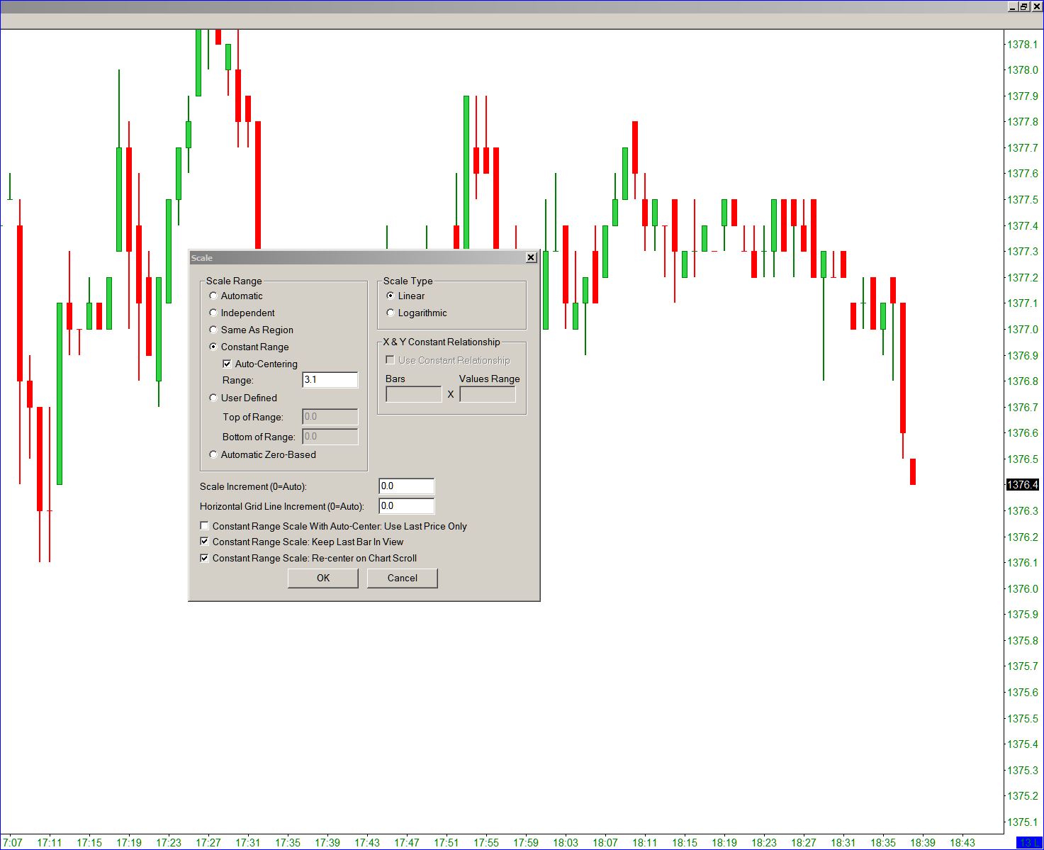

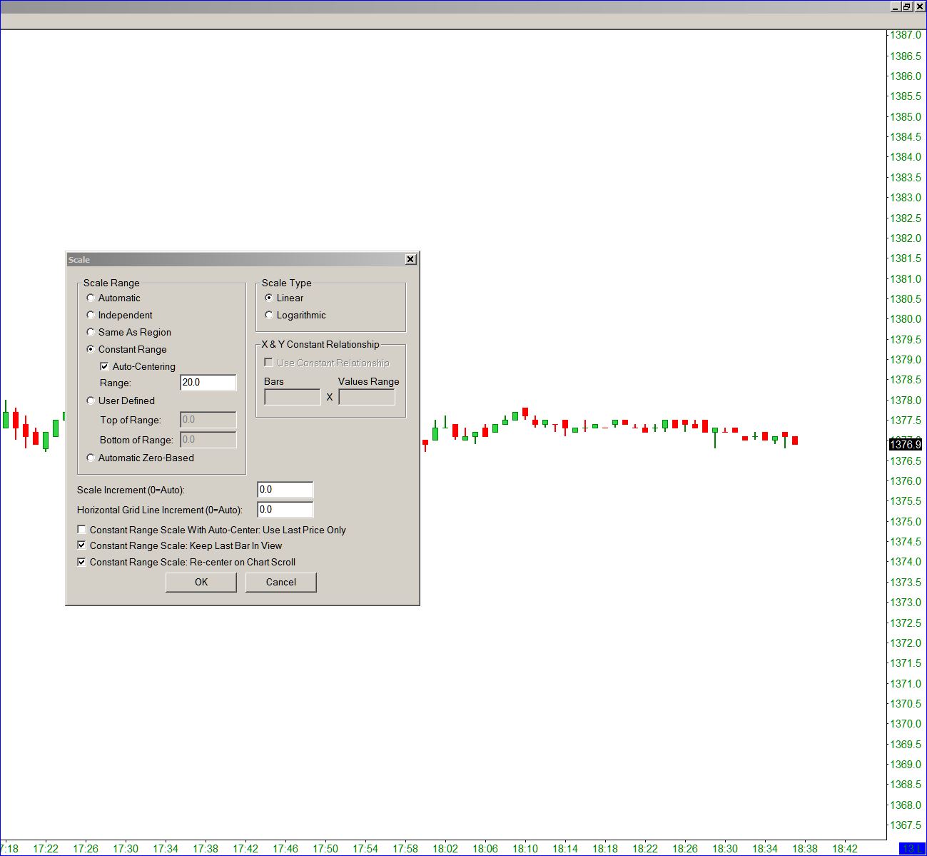

Hi Guys,
Does anyone have this scale setting issue on the chart...
I show 2 cut outs , one is originally set to scale value 20, suppose when closing the chart, using "save before close" should when reopen the same chart, the scale remains at value 20, right?
But the scale changed to 3.1, pls see 2nd cut out.. Have to change manually to 20, it cannot remember the setting...
try many times, still back to square one??
pls help to solve, thanks!
imagescalesetting.JPG / V - Attached On 2013-06-18 10:51:30 UTC - Size: 128.96 KB - 922 views
imagescalesetting2.JPG / V - Attached On 2013-06-18 10:51:38 UTC - Size: 152.42 KB - 939 views

[2013-06-18 16:29:37]
Vergina Star - Posts: 9
In the first image. The scale is from 1387.0 to 1367.0. That is a 20 point constant range. What are you looking for it to do?
I am on version 988. I made a change to the scale, saved the chartbook & closed it, when I reopened the chartbook it had the correct scale settings. I'm not sure what you are talking about.
[2013-06-19 01:28:59]
teowinner - Posts: 16
Let me explain...
In the first image , i had set the scale to 20, the candlesticks is small and can see all in the middle of chart.
After saved and close, then open the same chart, the scale setting goes to 3.1, and the candlesticks spread all over the chart...The scale setting cannot set to what I want, instead it just auto set to any value once you re-open the chart.
What I show now is a simple chart for problem solving, but there are over 10 studies and 50 overlays which I have not put in, since a simple chart had this scale issue is which I after upgrade to the latest version 988, I use back the older previous version, it is OK with my full chartings and scale settings are intact...I had been using this setups for the past 1 year why it happen now?
pls advise!
