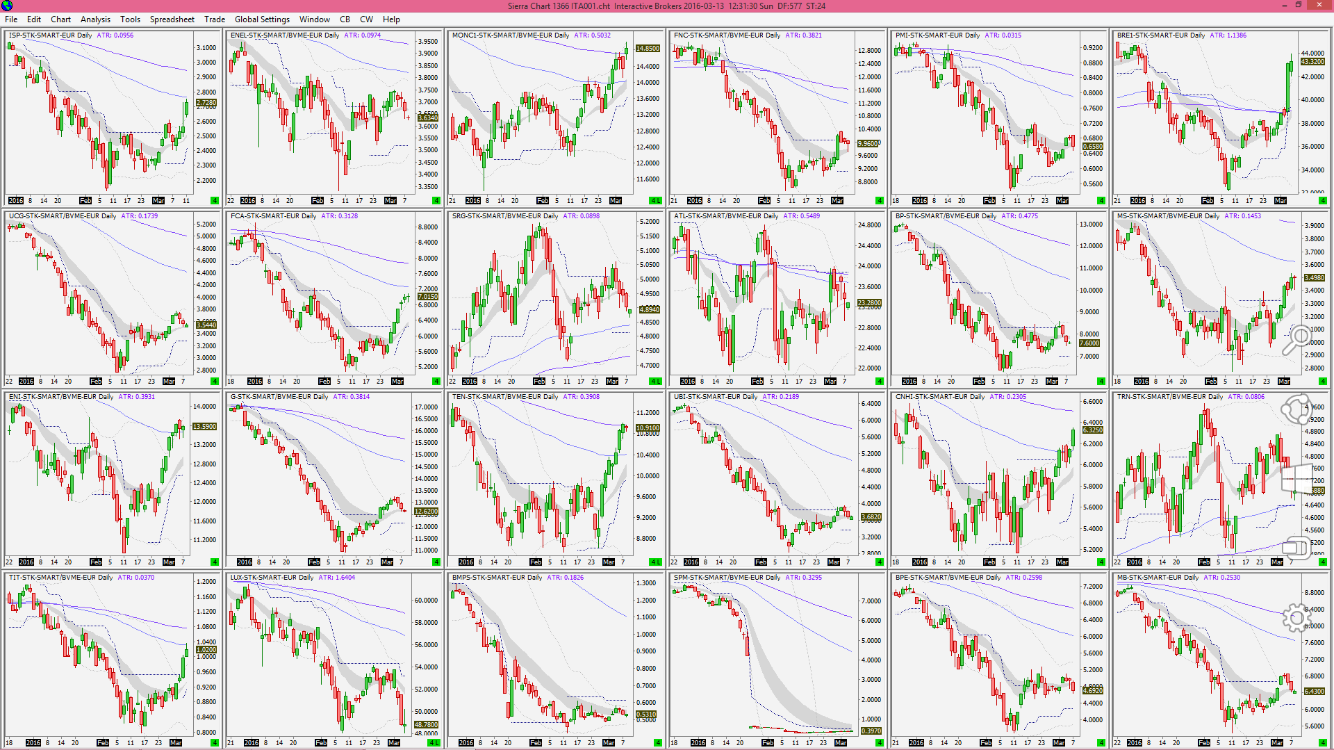

However, it seems to be a problem when opening a chartbook with many charts in it.
I created a chartbook containing 24 small stock daily charts (HISTORICAL CHARTS), to have a quick visualization of the stocks I'm following (see attached screenshot chartbook.png).
When I open this chartbook, SC tries to update all the 24 charts, but only the first one gets updated, and the remaining 23 display a DOWNLOAD CANCELED error.
See attached SC log file (SC LOG.txt).

So, to test if this is a symbol problem, I select EDIT => DELETE ALL DATA AND DOWNLOAD on the UCG-STK-SMART/BVME-EUR chart, and it gets correctly updated (see last lines of the log file).
imagechartbook.png / V - Attached On 2016-03-13 11:32:51 UTC - Size: 241.41 KB - 635 views
