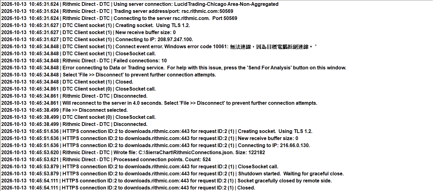

Hello Sierra Chart Support,
I am experiencing intermittent real-time market data delays (10 seconds to several minutes) and repeated connection failures when using Sierra Chart with Lucid Trading Rithmic Direct-DTC.
Connection settings:
- Sierra Chart version: 2920
- Service: Rithmic Direct - DTC [trading]
- Server: LucidTrading-Chicago Area-Non-Aggregated
- Host: rsc.rithmic.com
- Port: 50569
- Symbol: NQZ6.CME
Issue observed:
Sierra Chart repeatedly attempts to connect to `208.97.247.100:50569` and fails with Windows error 10061 (Connection Refused).

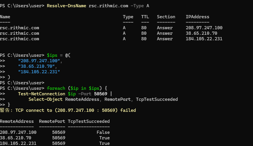

Network tests:
DNS resolution returns three IP addresses:
| IP Address | TCP Port 50569 |
| 208.97.247.100 | Failed |
| 38.65.210.70 | Successful |
| 184.105.22.231 | Not yet tested |
I repeated the TCP tests using both my home Wi-Fi and mobile hotspot, with identical results.

image螢幕擷取畫面 2026-10-13 225126.png / V - Attached On 2026-10-13 14:51:43 UTC - Size: 57.01 KB - 4 views
image螢幕擷取畫面 2026-10-13 225319.png / V - Attached On 2026-10-13 14:53:31 UTC - Size: 102.36 KB - 2 views
[2026-10-13 15:52:41]
User168271 - Posts: 2
Hi Sierra Chart Support,
I have completed additional TCP connectivity tests with Surfshark VPN enabled and disconnected.
The results were identical in both environments:
- 208.97.247.100:50569 — Failed (Winsock 10061, 2/2 attempts)
- 38.65.210.70:50569 — Successful (2/2 attempts)
- 184.105.22.231:50569 — Successful (2/2 attempts)
With the VPN disconnected, Windows routing selected my physical Wi-Fi adapter, and successful TCP connections used its local IP address.
Although residual VPN filtering has not been fully ruled out, the same connection failure persisted without an active VPN tunnel.
Could you please confirm whether all three IP addresses are valid Rithmic DTC endpoints on port 50569, and whether Sierra Chart automatically retries alternative IP addresses when a connection is refused?
Thank you.
[2026-10-13 16:00:38]
Sierra_Chart Engineering - Posts: 25161
We understand the reason for the problem. We will have a solution out later today. You will need to update to the latest prerelease.
