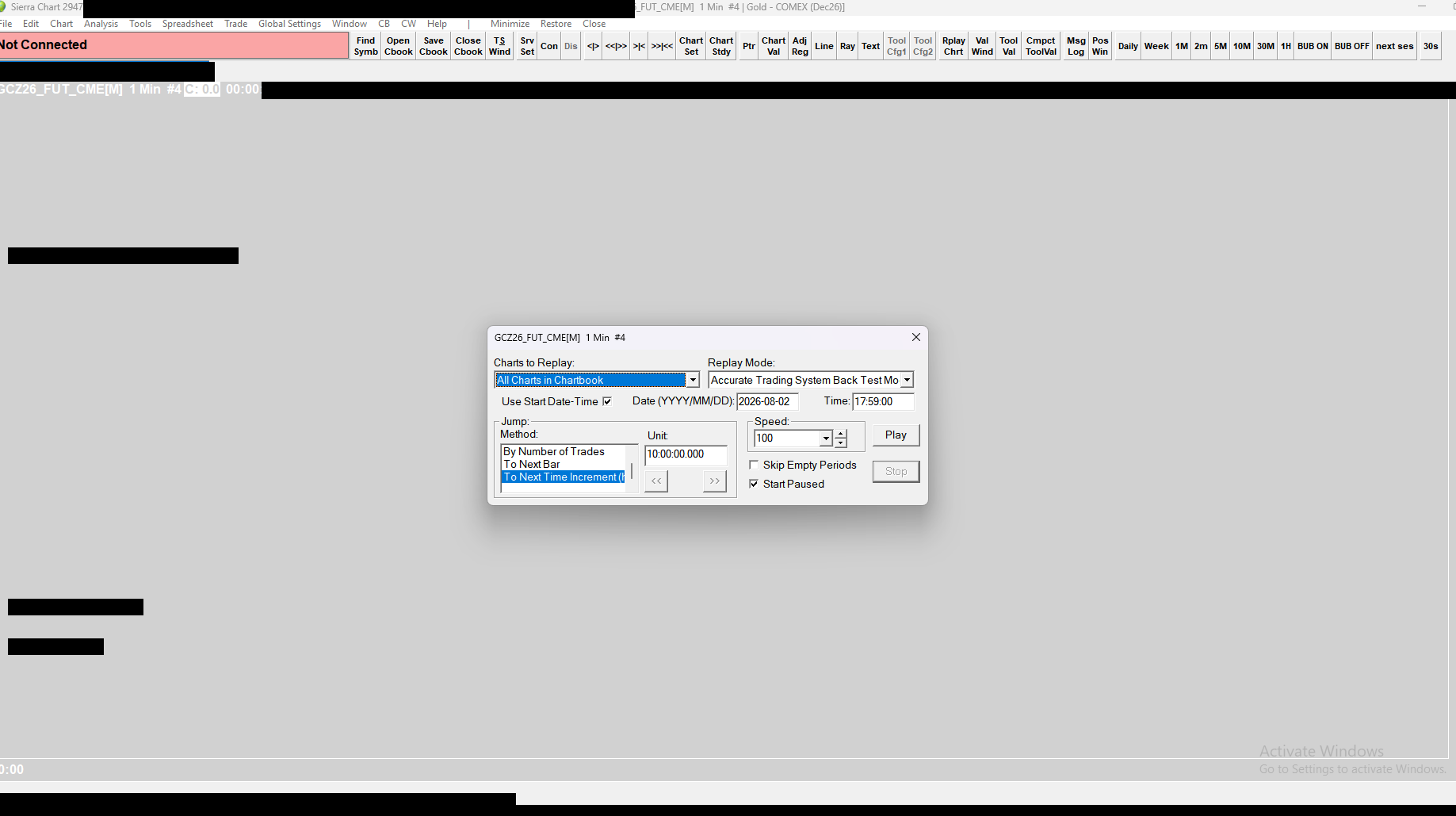

(a) With Replay Start 17:59 (inside data), study calculation was invoked once and then never again from 38 s after Play (bars static). After Stop, the charts logged loading complete, but the full recalculation that chart #1/#2 had tagged for chart #4 never ran: "Base Graph ... Array is unallocated", no heartbeat, chart #4 stayed blank until Exit.
(b) Separately: starting the replay at a date-time inside a no-data period (Start 08-02 00:00, a Saturday) leaves the replay position at the prior Friday close (07-31 16:59:54) indefinitely - 25 min observed, studies alive, Stop/reload normal. On 2922 the same start advances immediately. We found nothing about this change in What's New 2923-2947 - is it intended?

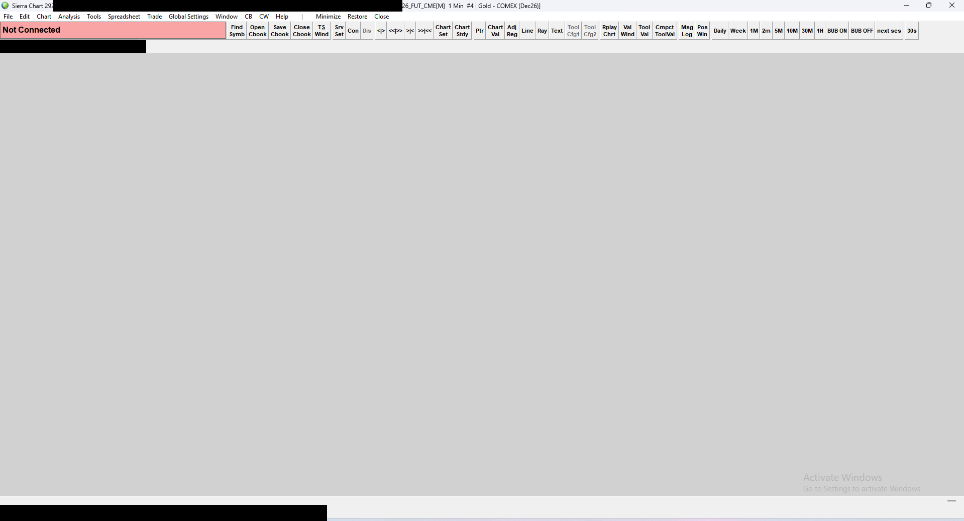

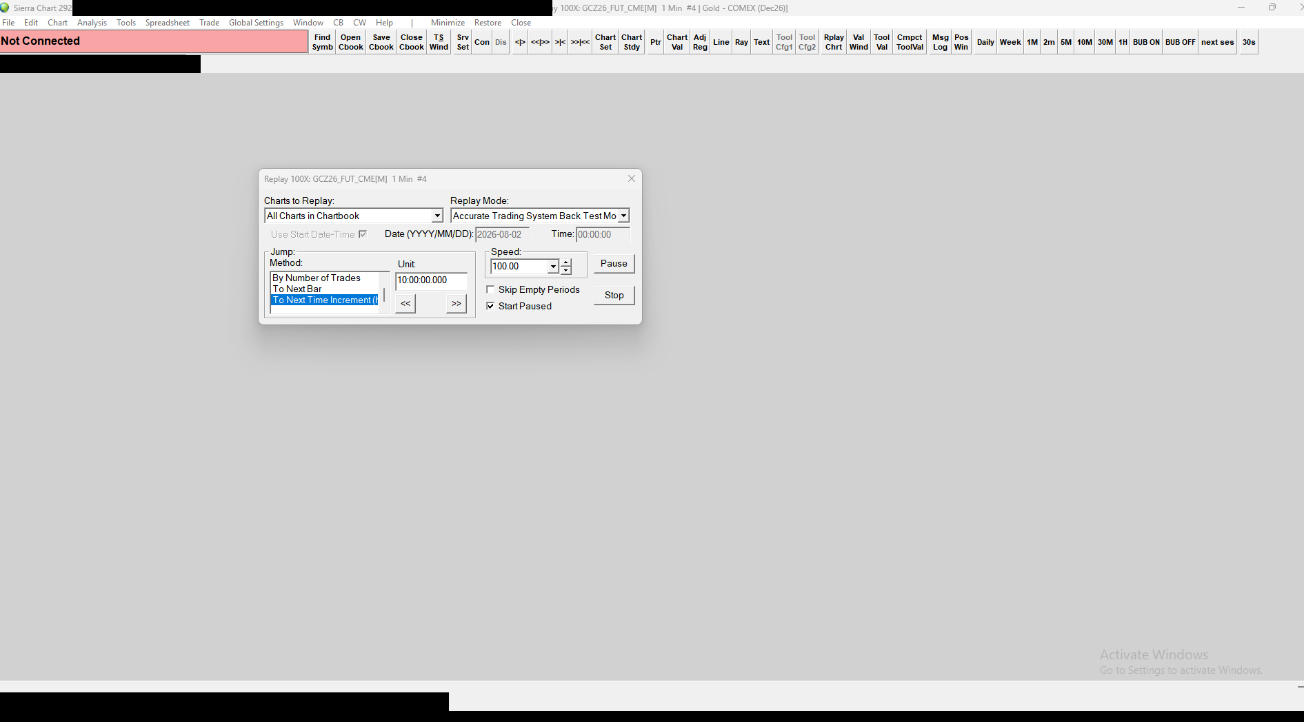

Screenshots (part 1 of 2), referenced in the first post. Custom study/chartbook names are masked in the images, consistent with the neutralized names in the logs.
- SS_run1_blank_charts_after_stop.png: occurrence 1 (2922, OS Timer Yes) - charts blank after Replay Stop; 'Reloading chart' logged for all 4 charts but 'Chart data loading complete' never followed.
- SS_run2_blank_after_jump.png: occurrence 2 (2922, OS Timer No) - blank charts after the Jump that was accepted and logged but never applied.
- SS_run2_UseOSTimer_No.png: setting confirmation for occurrence 2.

imageSS_run1_blank_charts_after_stop.png / V - Attached On 2026-09-09 16:38:51 UTC - Size: 36.71 KB - 62 views
imageSS_run2_blank_after_jump.png / V - Attached On 2026-09-09 16:39:22 UTC - Size: 54.52 KB - 65 views
imageSS_run2_UseOSTimer_No.png / V - Attached On 2026-09-09 16:39:55 UTC - Size: 8.53 KB - 55 views

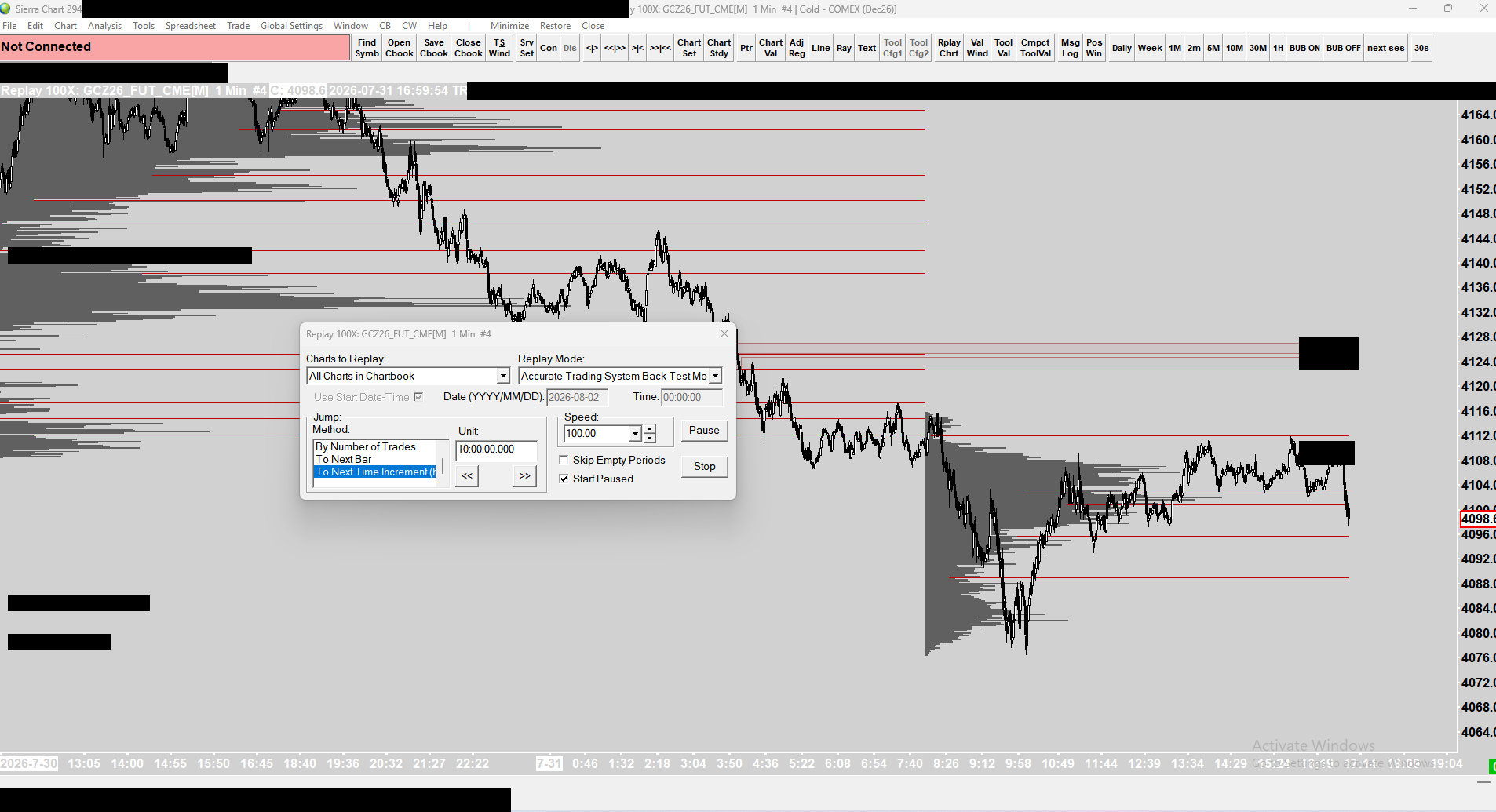

Screenshots (part 2 of 2), from the 2947 controlled-update session:
- SS_2947_replay_not_advancing.png: occurrence (b) - Replay Start 2026-08-02 00:00 (inside a no-data period); the replay position stays at 07-31 16:59:54 (visible in the top bar) while the dialog shows the requested start date; observed for 25 min.
- SS_2947_blank_chart4_after_stop.png: occurrence (a) - chart #4 blank after Replay Stop; the tagged full recalculation never ran (C: 0.0, no heartbeat until Exit).

imageSS_2947_replay_not_advancing.png / V - Attached On 2026-09-09 16:41:08 UTC - Size: 98.78 KB - 60 views
imageSS_2947_blank_chart4_after_stop.png / V - Attached On 2026-09-09 16:41:37 UTC - Size: 59.37 KB - 57 views

- Pressed Stop at 14:22:11 (chart local time): "Reloading chart" was logged for all 4 charts, then nothing further appeared in the message log until program exit at 14:29:55 - 7 min 44 s with no "Chart data loading complete". Charts were blank in a screenshot taken 16 s after Stop and still blank just before exit. File >> Exit closed normally.

- Pressed Stop at 18:14:23: same failure - "Reloading chart" x4 logged, then nothing further in the message log until exit at 18:22:40 - 8 min 17 s with no "Chart data loading complete". Charts blank in a screenshot at 18:22:06 (7 min 43 s after Stop). Exit normal.

One observation from these two runs (this session only): with this start time (Sunday 00:00, Skip Empty Periods off) the replay position stayed at the previous close (07-31 16:59:54) for ~28 minutes of real time before data began, then proceeded normally, in both runs. Our earlier report of the replay never leaving the start position on 2947 was stopped at 25 minutes; whether that was the same waiting behavior or a real failure is unresolved - we have not re-verified it.
