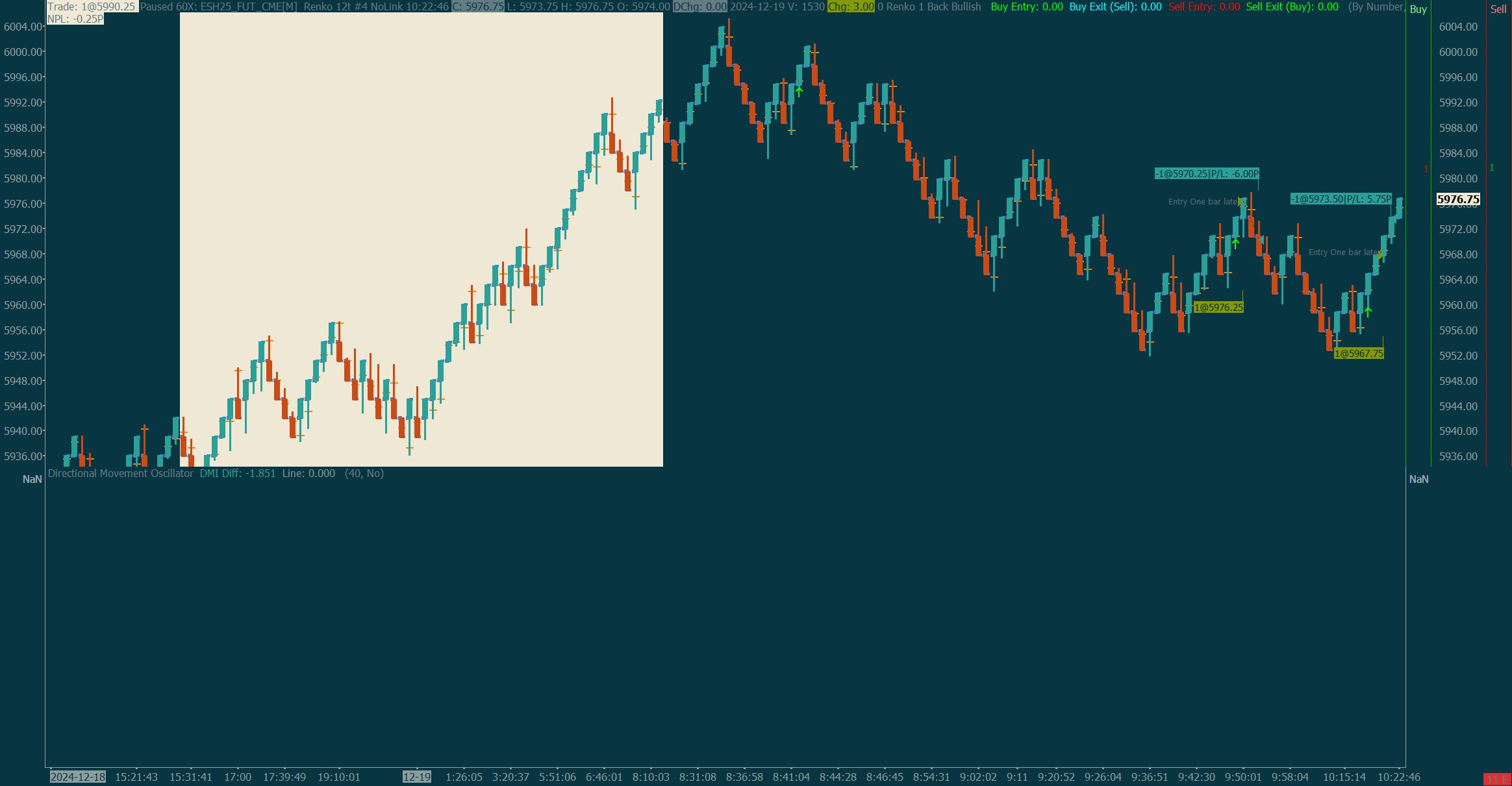

I have been working the last 3 days without success in trying to get entries fire at the desired brick on a Renko system being implemented on the spreadsheet study for trading.
Chart Renko Bricks with WIcks
Renko Bar New Bar Mode: tried several and issue still happening.
Study: Spreadsheet study for trading
Signal Only on Bar Close: Yes
Studies: Renko Visual Open/CLose
on column P there is a formula that calculates the direction of the brick Up, Down Flat =IF(AF3 > AE3, "Up", IF(AF3 < AE3, "Down", "Flat"))
the direction is used to determine a pattern
if the pattern is true then Buy entry signal. On Column K =AND(O3=1,P7="Up",P6="Up",P5="Down",P4="Up",P3="Up")
A green arrow appears on the bar where the condition of the pattern is met.
But the entry happens one bar later. I have tried with limit orders also but no change, What am I missing?
Please check attachment.
Also tried to use ID0.sg22@3 and ID0.Sg23@3 without luck on the spreadsheet.
ANd noticed that previous close and present open do not always align on the spreadsheet using The renko visual open close study
https://www.sierrachart.com/image.php?Image=1787183777349.png

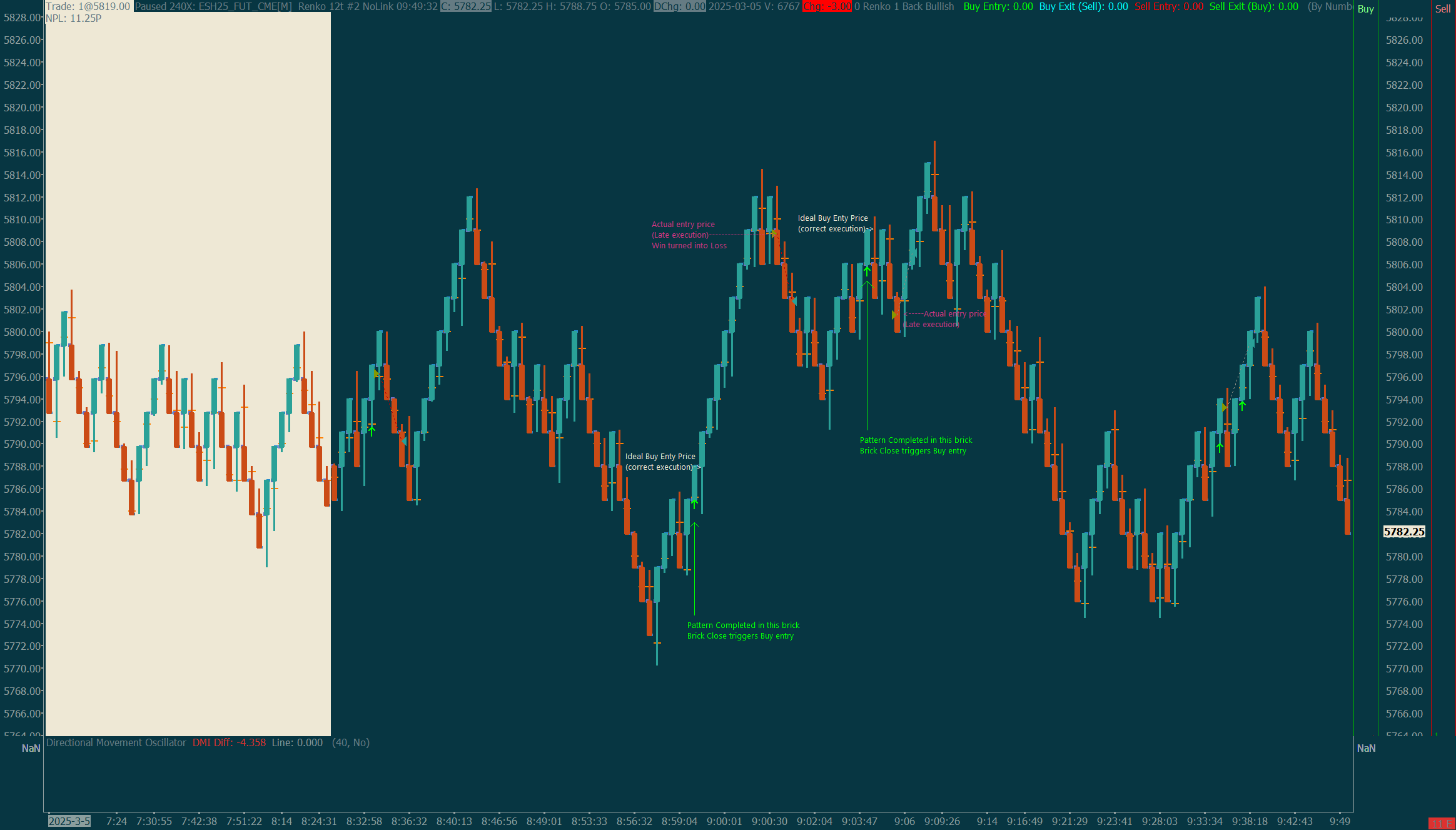

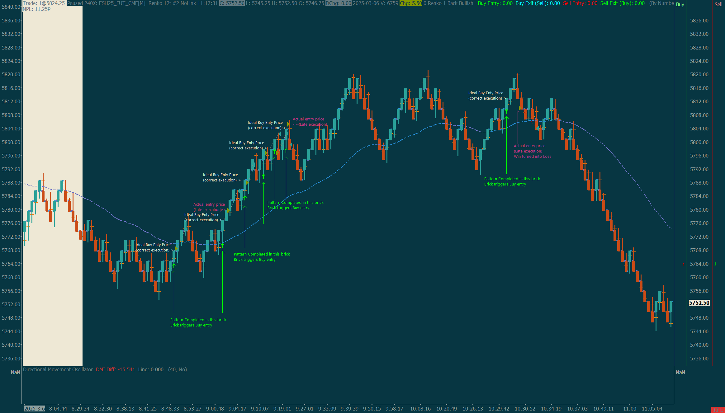

Regarding the “Signal Only on Bar Close = Yes” behavior, I can confirm that the Spreadsheet System for Trading does not consistently place the order at the open of the next brick after the pattern is fulfilled.
This is not happening 100% of the time.
In many cases the entry is correct, but in other cases the Buy Entry is triggered 1, 2, 3 or more bricks late, even though the pattern was fully confirmed on the correct brick. This inconsistency causes trades that should be winners to become losing trades.
Additionally, the entry price is not always respecting the Renko brick close where the Buy Entry should be placed. Sometimes the entry is higher than the correct brick close, which is the most problematic case, and sometimes it is lower. This happens even when using Limit orders.
I am providing screenshots and cases where the entry price is not placed at the correct brick close showing:
correct executions,
very late executions,
mixed executions,
In the worst examples, it seems that the speed at which the bricks print during replay may influence the timing. I have tested replay speeds of 10, 30, 120, and 240, all with “Calculate Same as Real Time”, and the results are the same: sometimes correct, sometimes late.
Please advise what could cause this inconsistent timing behavior when using Spreadsheet System for Trading with Renko bars.
Thank you.
https://www.sierrachart.com/image.php?Image=1787321007317.png Good & Bad Ex
https://www.sierrachart.com/image.php?Image=178732220118.png Bad execution
https://www.sierrachart.com/image.php?Image=178732220118.png Good execution
