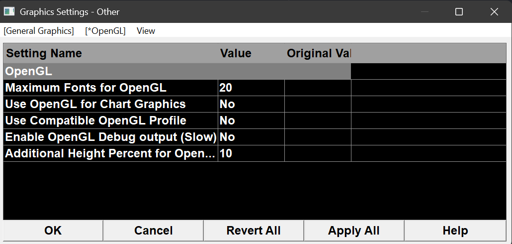

Now that we have looked into this. This is next to impossible for us to identify the reason. There could also be a problem in one area of the program causing a problem in another area. Try disabling OpenGL.
[2026-06-29 07:10:01]
User250686 - Posts: 5
Disabled OpenGL as suggested, but the issue persists. Charts still freeze and stop drawing new bars multiple times per session. A full restart of Sierra Chart remains the only fix. Attaching the latest Message Log for reference. Please advise on next steps.

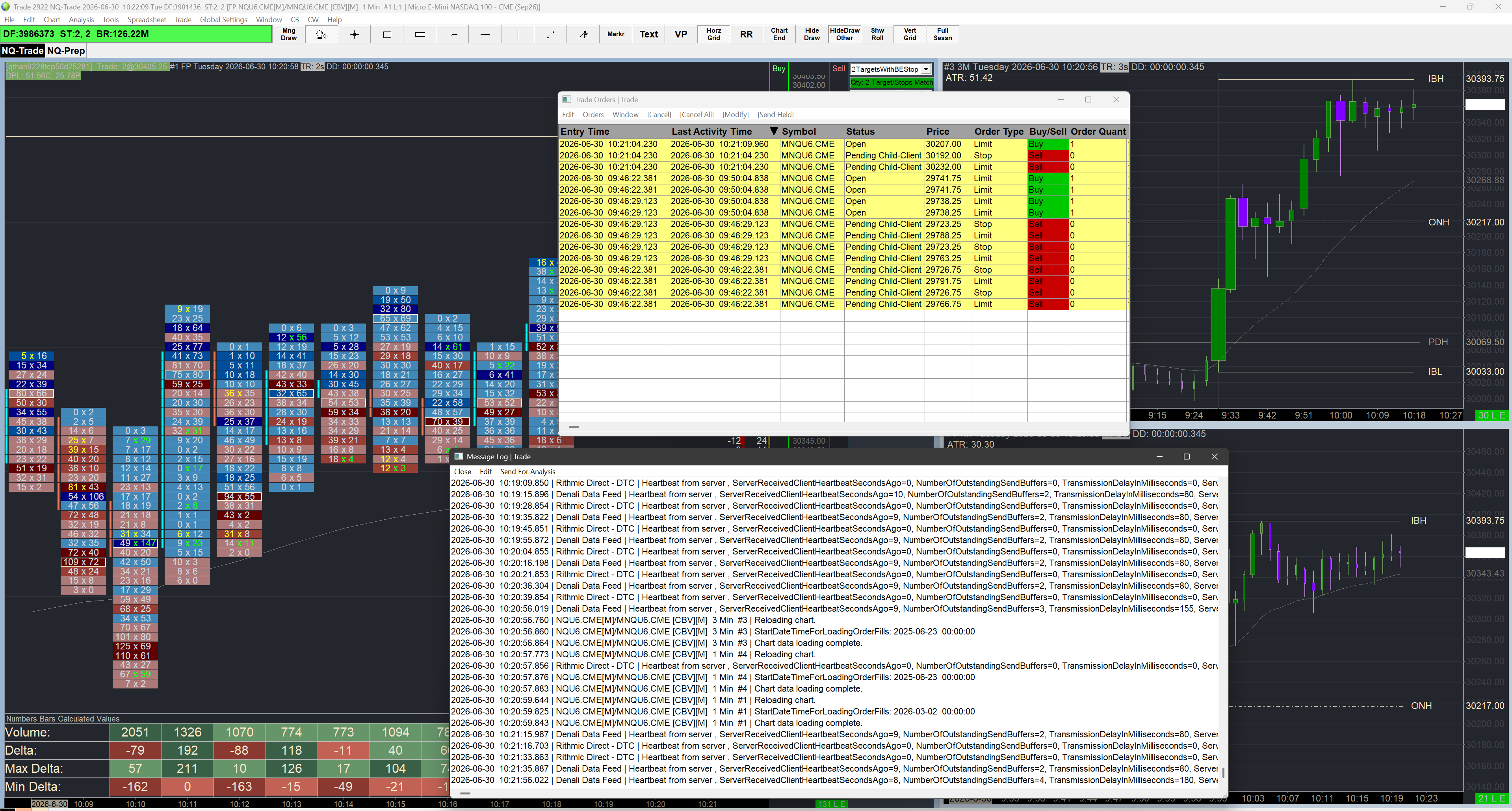

My chart stopped updating automatically.
The data feed appears to be working fine (heartbeat logs show normal connection).
I can still place and submit orders successfully — the trades are confirmed and visible on Rithmic mobile app in real time — but they do not reflect on the chart in Sierra Chart.
I tried reloading and recalculating the chart — it loads historical data correctly, but it still does not update continuously on its own.
imageScreenshot 2026-06-30 212214.png / V - Attached On 2026-06-30 14:30:39 UTC - Size: 809.88 KB - 129 views
attachmentMessage Log 2026-06-30 094956.log - Attached On 2026-06-30 14:30:52 UTC - Size: 193.67 KB - 122 views
[2026-06-30 15:22:54]
This last log does not show any issues like the previous ones.
Given this, please go through the items at the following link for why the bars may not be updating:
