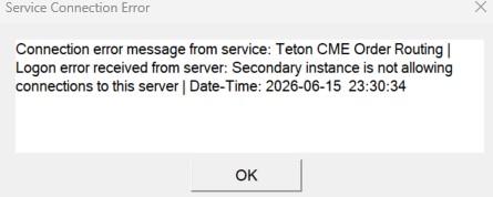

Thanks for the respone. It does not seems like my ISP connectivity issue as I have been using it for a while now and never faced this problem with Sierra Chart. All my other devices were working fine connected to the internet. I am also getting the error as attached ('Secondary instance is not allowing connections to this server') which I never experienced earlier. It gets connected to the data feed later but not on first launch. I will observe it.
imageScreenshot 2026-06-16 043856.jpg / V - Attached On 2026-06-16 03:40:35 UTC - Size: 18.58 KB - 95 views

[2026-06-16 06:06:14]
Sierra_Chart Engineering - Posts: 25390
We see no problem connecting to Teton order routing at this time.
Firewall or security software on your computer could be blocking the connection.

[2026-06-16 14:42:40]
We apologize for the issue, we did not have the forwarding set up through our backup connectivity.
Although you should have been able to connect regardless of this. The fact that you were not able to connect still does show some problem on your side. It is not normal, to never be able to connect through the primary path. But you should be able to connect now. Through an alternate path.
