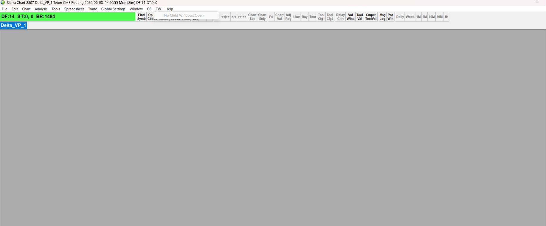

[2026-06-04 17:54:48]
100ktrades - Posts: 5
Hi John, thanks for the quick reply.
The charts aren't hidden they're visible as tabs at the top but nothing loads on the main screen when I select them. This is happening with both my custom chartbook and the example chartbook, so it doesn't appear to be isolated to my setup. I've attached screenshots below to better illustrate what I'm seeing.
imagesierra chart pic number 2.png / V - Attached On 2026-06-04 17:53:07 UTC - Size: 124.68 KB - 183 views
imagesierra chart pic.png / V - Attached On 2026-06-04 17:53:20 UTC - Size: 85.11 KB - 136 views
[2026-06-04 19:30:39]
John - SC Support - Posts: 48459
The two tabs at the top are the Chartbooks, one named "Delta_VP_1" and the other named "ExampleChartbook".

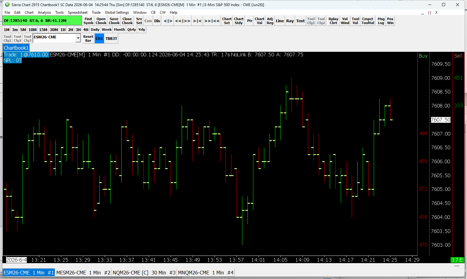

By default, the charts are displayed in tabs at the bottom of the screen, but you can change where they are located. See the attached image of our Sierra Chart window, with a Chartbook named "Chartbook1" open with 4 individual charts listed at the bottom.
We are not seeing any charts displayed for the selected chartbook in your image (ExampleChartbook). If you select the "CW" menu, do you see any charts listed in there? If so, select one and then let us know what you see.
If you do not see anything in the CW menu for either chartbook (select the Chartbook, then the CW menu) then get us your Message Log by following these instructions:

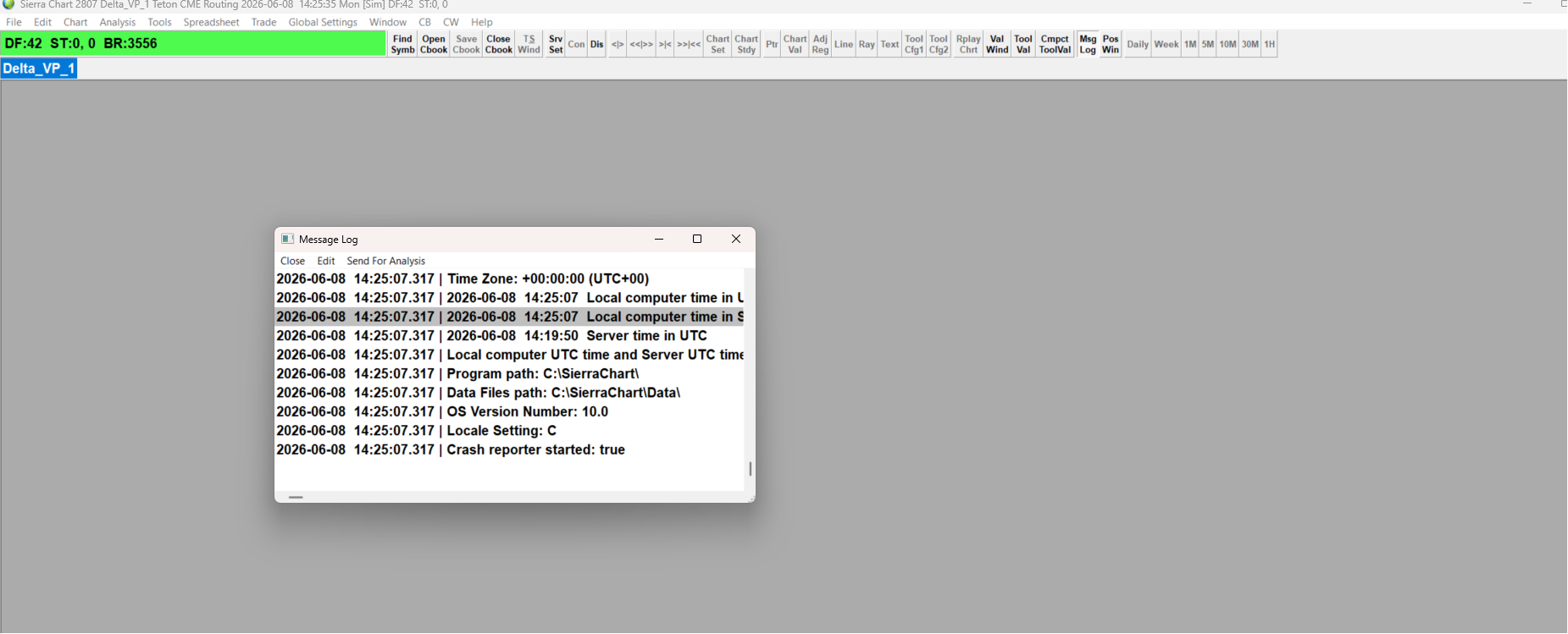

[2026-06-08 14:26:53]
Hey john,
so I followed your steps here is a screenshot of the cw menu after doing what you said. the log is posted below but it does not change when i open my chartbook again it still says the same thing. attached is a screenshot as well. thanks again for helping me with this. I feel I am overlooking something very small.
here is also mymessage log

imagecw screenshot.png / V - Attached On 2026-06-08 14:24:11 UTC - Size: 69.72 KB - 156 views
imagedelta footprint log not changing.png / V - Attached On 2026-06-08 14:26:27 UTC - Size: 231.4 KB - 158 views
[2026-06-08 15:48:22]
We do not know why, but that chartbook - "Delta_VP_1" does not have any charts in it.
You can recover a chartbook from backups that we make for them. Refer to the following:
Chartbooks (Workspaces): Accessing a Backup Chartbook File
We also recommend checking your drive space to ensure you are not out of space. We wonder if the chartbook did not save properly at some point recently due to an issue with space.
