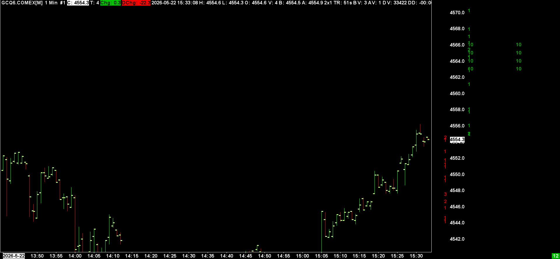

[2026-05-22 15:35:30]
epoiakhmal - Posts: 2
Hi. My Objective is as follow
1. Denali as Data Feed
2. Rithmic as Trade
If i use only Denali (Package12) should be no issue
If i use Denali Rithmic as above, i am having issue getting OrderID.
I could see the DOM Column as picture below.
https://www.sierrachart.com/image.php?Image=1779463994159.png
I would like to see the orderID for this as what i can see with Denali
Is the tick different so that my study need to change also?
[2026-05-22 16:07:41]
You are getting our Denali data while you are connected to Rithmic.
We do not know why you are having an issue with your program, as you are receiving the data.
We do not give programming help, so we can not help you further with this, as the issue is with your program.
