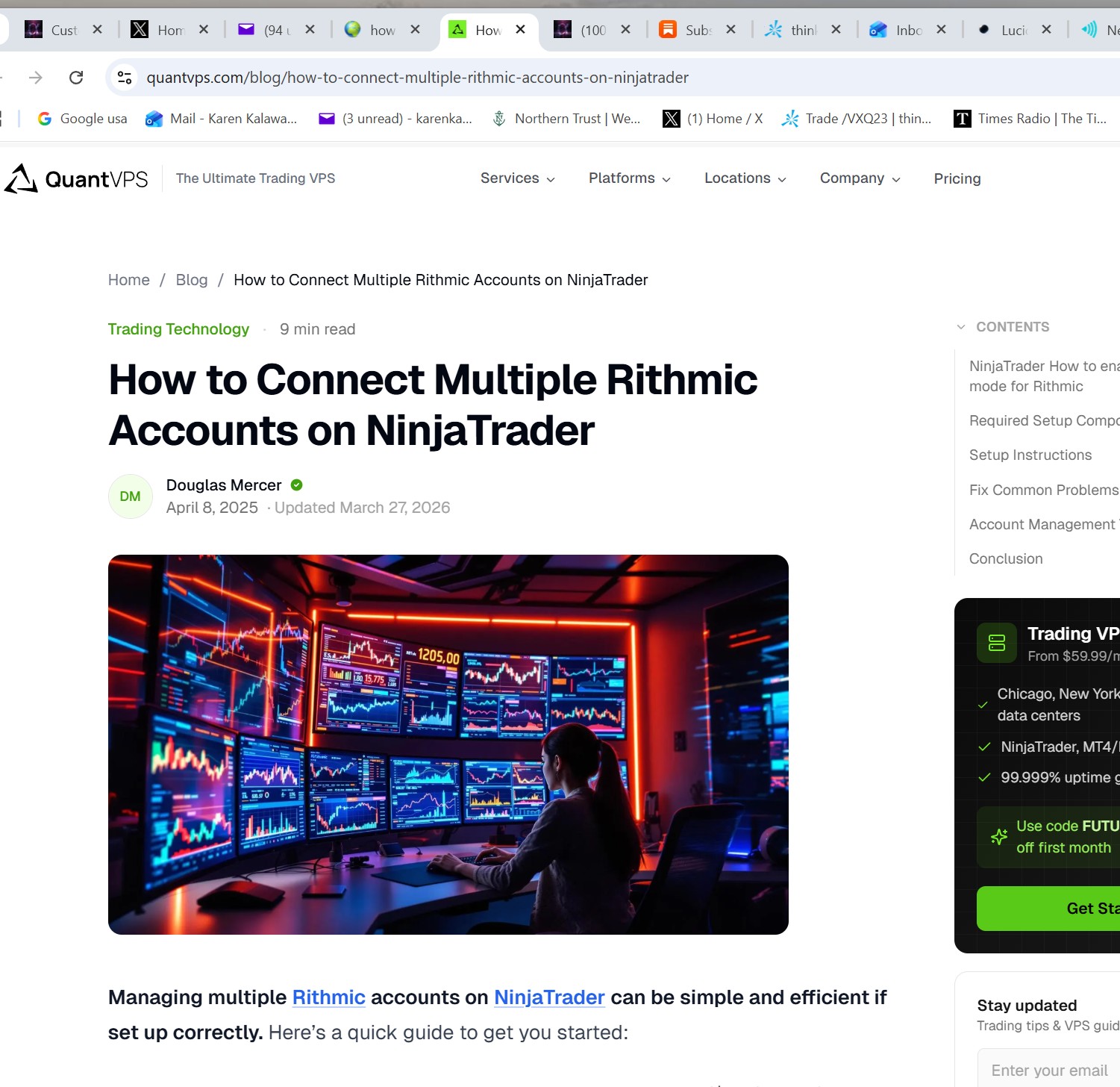

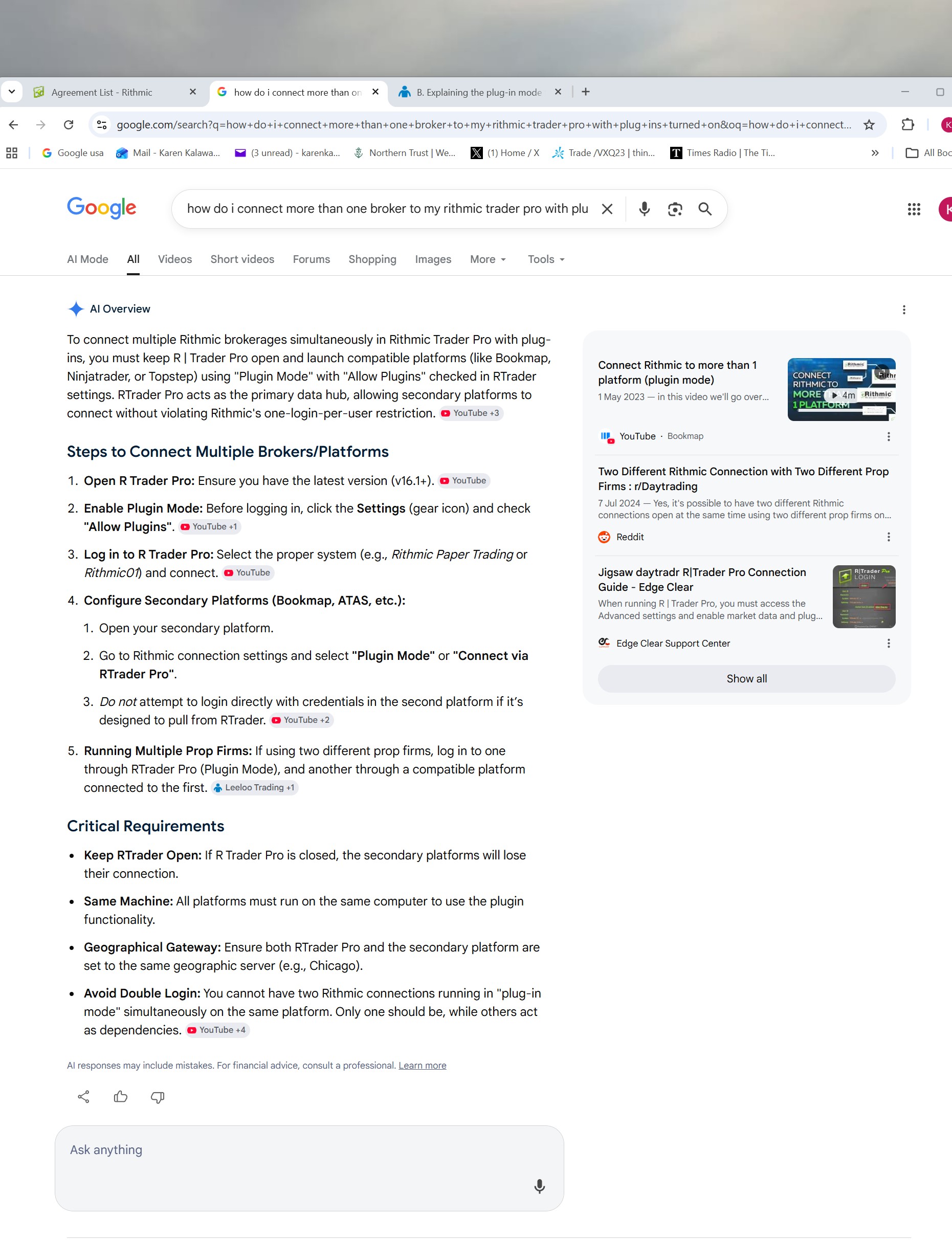

User849502 - Posts: 485
So, despite what Google says, you are saying SC doesn't allow it? It appears others do, but just not SC? see attached.
image2allowed.jpg / V - Attached On 2026-05-01 08:44:14 UTC - Size: 624.77 KB - 149 views
imageninjaallows.jpg / V - Attached On 2026-05-01 08:45:06 UTC - Size: 343.13 KB - 148 views

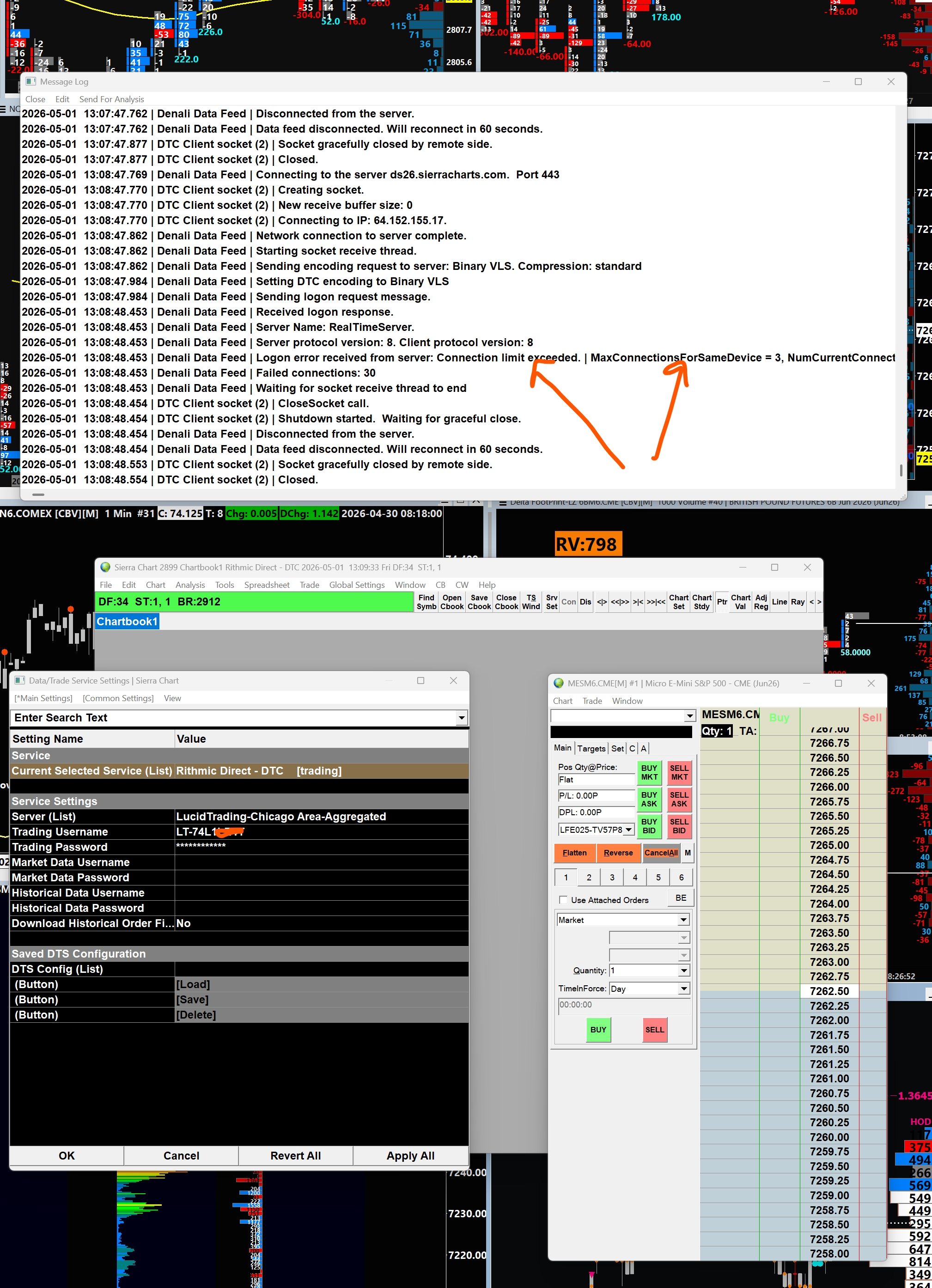

Thanks mate for replying. So I now understand that Rithmic isn't needed to connect, so why isn't it working? I have a completely unique SC login, I have data flowing it appears with the green banner, I have the correct acct in the dom drop-down, BUT no data is filling dom. Nor if I call up a chart, will it update beyond the time it was opened. I did the 'translate symbols', which didn't work. I see it says not allowed in the log.
I sooooooooooooooo appreciate you mate, thanks. Karen
imagewhat I see....png / V - Attached On 2026-05-01 13:54:13 UTC - Size: 524.58 KB - 176 views
[2026-05-01 16:11:34]
You have too many installations running on the same computer all trying to get data from our Denali Exchange Data Feed. There is a limit of 3 separate installations getting data on the same computer. Refer to the following:
Denali Exchange Data Feed: Connections
