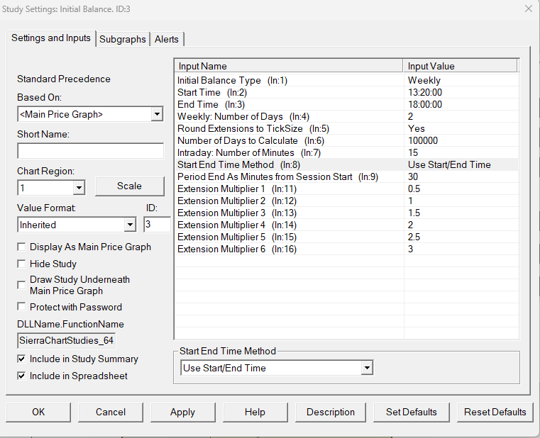

Hi there, i have a weekly profile chart starting monday and ending friday and im attempting to get a initial balance setup for 8am- 2pm on monday
however i cant seem to get it to work, any suggestions what should be in the settings?

To get an Initial Balance from 08:00 to 14:00, you would need to use an Intraday chart. To know if you are using Intraday data or Daily data, look at the setting for "Chart >> Chart Settings >> Data Limiting >> Chart Data Type". Refer to the following:
Chart Settings: Chart Data Type (Chart >> Chart Settings >> Data Limiting >> Date Range and Limiting Method)
Getting the data for just a single day each week (Monday) and from certain times from that day will take a bit of manipulation, as there is not a direct way to do this (the Initial Balance study is setup to use full days for weekly charts).
Let us know how you are wanting to view the Initial Balance, so we can give you information on how to approach this.

Hi there, I can confirm i'm using an intrada chart already.. data limiting set to "date range" which is a previous monday, and bar period set to 7 days.
Having the initial balance from 8am GMT- 18:00GMT Monday is what i'm looking to do.

Attached is a Study Collection that we put together that gives you what you are looking for. The only thing you may not want is that the lines will carry forward for all weeks through the end of the chart. If you only want the current week, then adjust the "Number of Days to Calculate" in the "High/Low for Time Period" study to be 7.
Refer to the following for how to use a Study Collection provided by us:
Study Collections: Using a Study Collection Provided by Sierra Chart Support
One other item of note. You would need to set the Bar Period to be some value that divides evenly into the times for which you want the Initial Balance. For instance, if your initial balance is from 08:00 to 18:00, then you would need a bar period of 10 hours (assuming 08:00 is a start of a new bar) or 1 hour or 30 minutes. But 4 hours will not work.
Depending on how you are setting up your chart, you may need a separate chart and then overlay the results of the studies we gave you to the weekly chart you are viewing.
