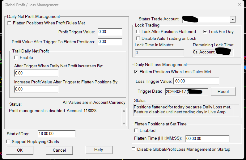

[2026-03-17 22:28:09]
User772499 - Posts: 61
Should I start a new thread with my specific issues or post here? I did read that before trying to set it up but I must be missing something because nothting happened when my Loss trigger value was hit. I only have 1 acct. I set "lock for Day", I checked "Flatten positions when loss rules met", I put in -60 for"Loss trigger value" to test it out,"start of day" is set to 18:00:00 (NY time), and Disable GPLM is unchecked.
In the "Trigger Date" box it now says today's date and under status it says, "Position flattened for today because....". But like I said nothing happened and I continued to trade to a much bigger loss.
[2026-03-18 14:26:44]
Please get us an image of the "Global Profit/Loss Management" window as you have it setup.
[2026-03-18 20:01:40]
Don't know why I'm having such a hard time posting a screenshot. If you follow the instructions you can't select the edit button while the GPLM window is open so that doesn't work. When I try to attach it that doesn't work either. Can't paste in here either. How is this supposed to be done?
imageScreenshot 2026-03-17 Loss Management.png / V - Attached On 2026-03-18 19:58:24 UTC - Size: 48.82 KB - 154 views
[2026-03-18 20:03:59]
ok maybe it did work
[2026-03-18 20:35:18]
The one thing we see is that you do not have the option for "Lock After Positions Flattened" enabled. As such, there will be locking of the trading. The option for "Lock for Day" will only function if you also have "Lock After Positions Flattened" enabled. Refer to the following:
Global Profit/Loss Management: Lock Trading >> Lock After Positions Flattened
If the flatten did not work, then let us know.

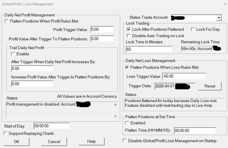

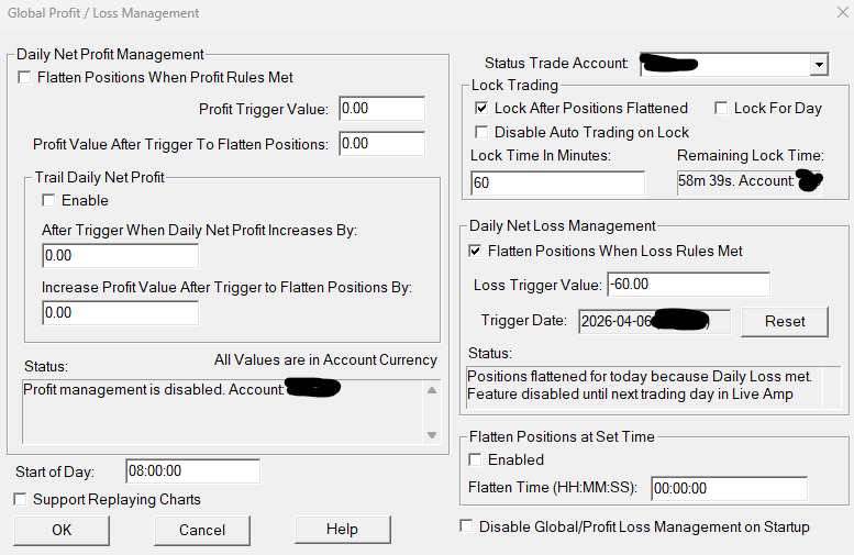

[2026-04-07 20:34:05]
I got a chance to try this out again and the lockout clock starts up again when I launch Sierra the next day.
Attached screen shots show it.
imageScreenshot 2026-04-06 1-24pm 4-6.png / V - Attached On 2026-04-07 20:30:25 UTC - Size: 46.09 KB - 169 views
imageScreenshot 2026-04-07 0911am 4-7.png / V - Attached On 2026-04-07 20:31:57 UTC - Size: 45.77 KB - 143 views
[2026-04-08 15:04:57]
Sierra_Chart Engineering - Posts: 25489
What the screenshots show is that the functionality triggered 2026-04-07. It triggered again. So there is nothing wrong here.
Enable Disable Global Profit/Loss Management on Startup. Keep it disabled on startup! There is a reason why this is disabled on startup. However, users insist on wanting it enabled and this will create issues. It is simply unsafe for it to be enabled on startup. This is not our problem.
Date Time Of Last Edit: 2026-04-08 15:05:53
