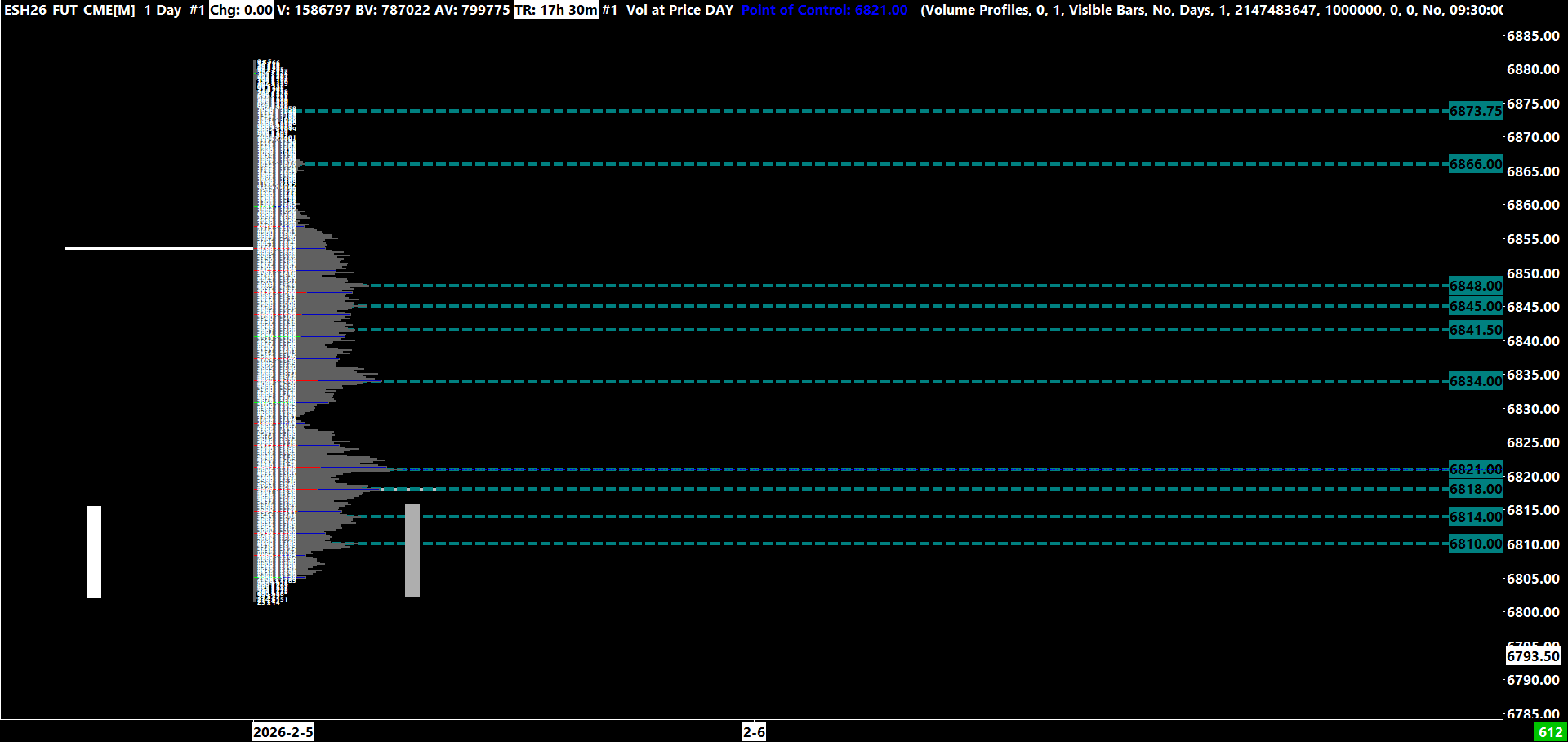

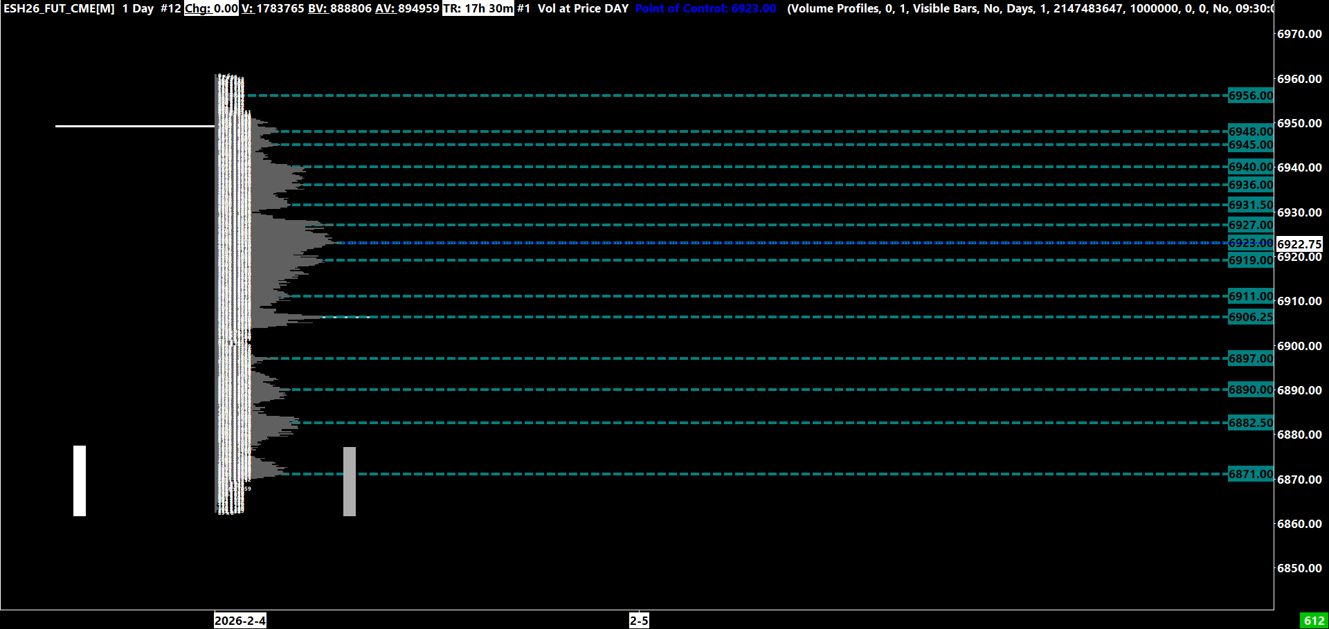

Why am I only getting the bottom of the day? I have reloaded (after RTH hours) You can see its working on the bottom of the chart. Youd expect with that low of Vol set, that the middle of the day would have the bars, but not the ends because theres less than 250 Ask/Bid in those areas. But you can see the top has no bars. Is trying to oad after hours not letting the non historical info from loading?
Over day wide agle here:
https://www.sierrachart.com/image.php?Image=1770251039419.png

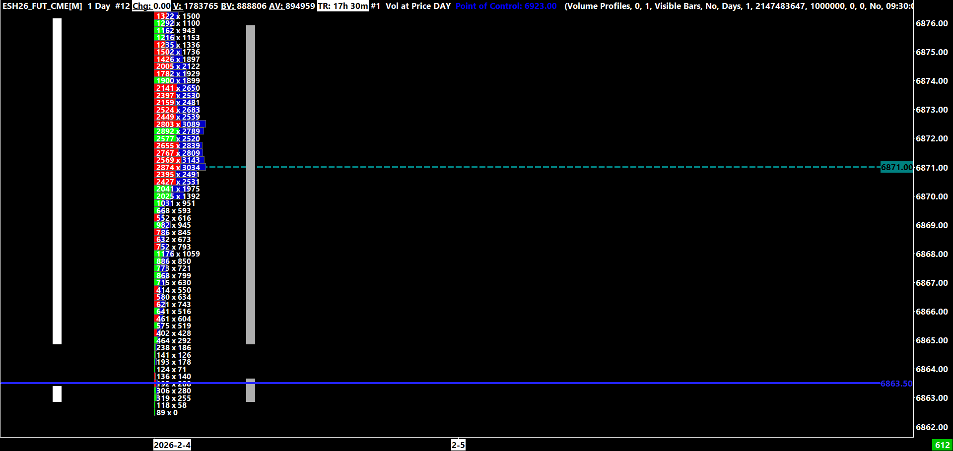

Bottom area:
https://www.sierrachart.com/image.php?Image=1770251127694.png

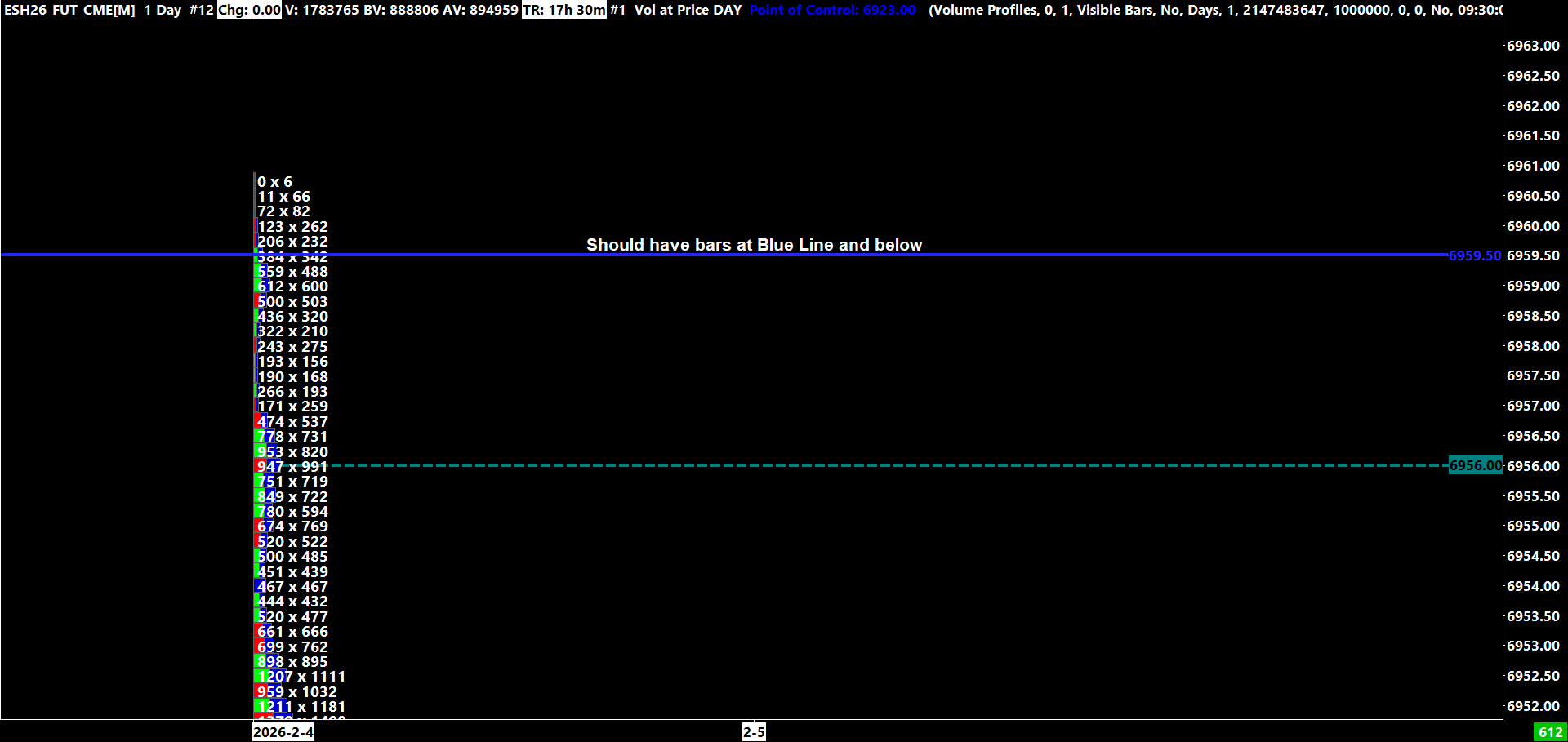

Top of Day (Missing the Grey/White Threshold Bars >50)
https://www.sierrachart.com/image.php?Image=1770251284171.png

Idk why you would want the chart loaded a different way unless this way you can see the settings bc yesterday I loaded the chart by Edit>Screen Images>Upload charts. And there was nothing not pertinent on the chart (Except the blue horz line to show you the level in case you couldn't zoom). Regardless, below is the chart of today uploaded according to the instructions you provided. This is today, not the attached yesterday chart. But same thing. Rt side Grey Bar should be ASK>250, Left side White Bar should be Bid>250.
As you can see, the bars are just on the bottom of the day chart for some. The whole day should have the bars except near the top, and near the bottom as those Price Levels don't have 250 Ask or Bid.
You asked for the Chart, so the upload is below. But if you wanted the file,that's attached too.
https://www.sierrachart.com/image.php?Image=1770329817993.png

We wanted to see the chart so we could see how it is setup. It helps us to determine what may be wrong - which it did, although admittedly, we should have thought about it from the image, but we did not, but looking at the chart, it did give us the insight we needed.
The issue is that there are only 46 markers that can be drawn per bar. With the Daily bar as you have it, there are more than 46 levels that have the volume greater than the threshold value, so only the first 46 markers are drawn (it starts from the bottom and goes up).
