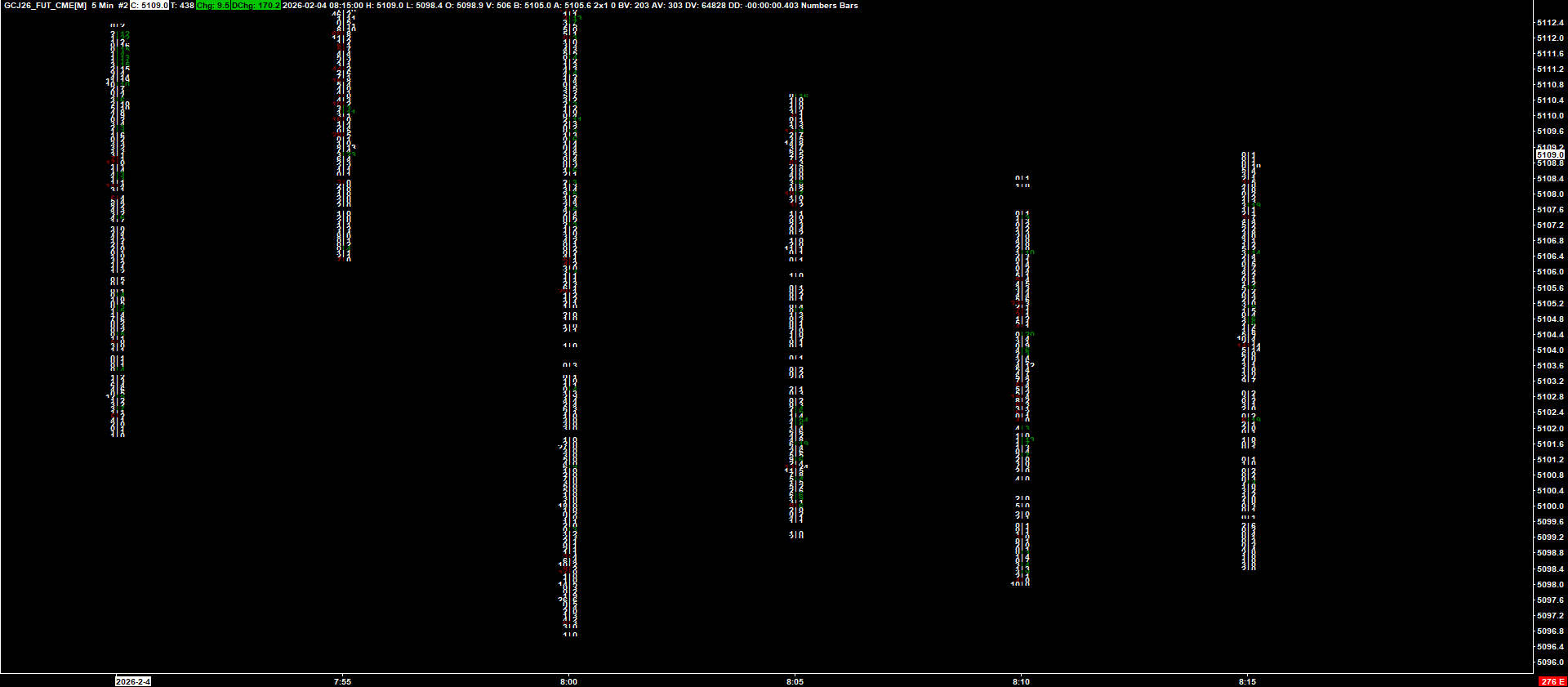

| [2026-02-04 08:51:32] |
| User872775 - Posts: 7 |
https://www.sierrachart.com/image.php?Image=1770195036638.png

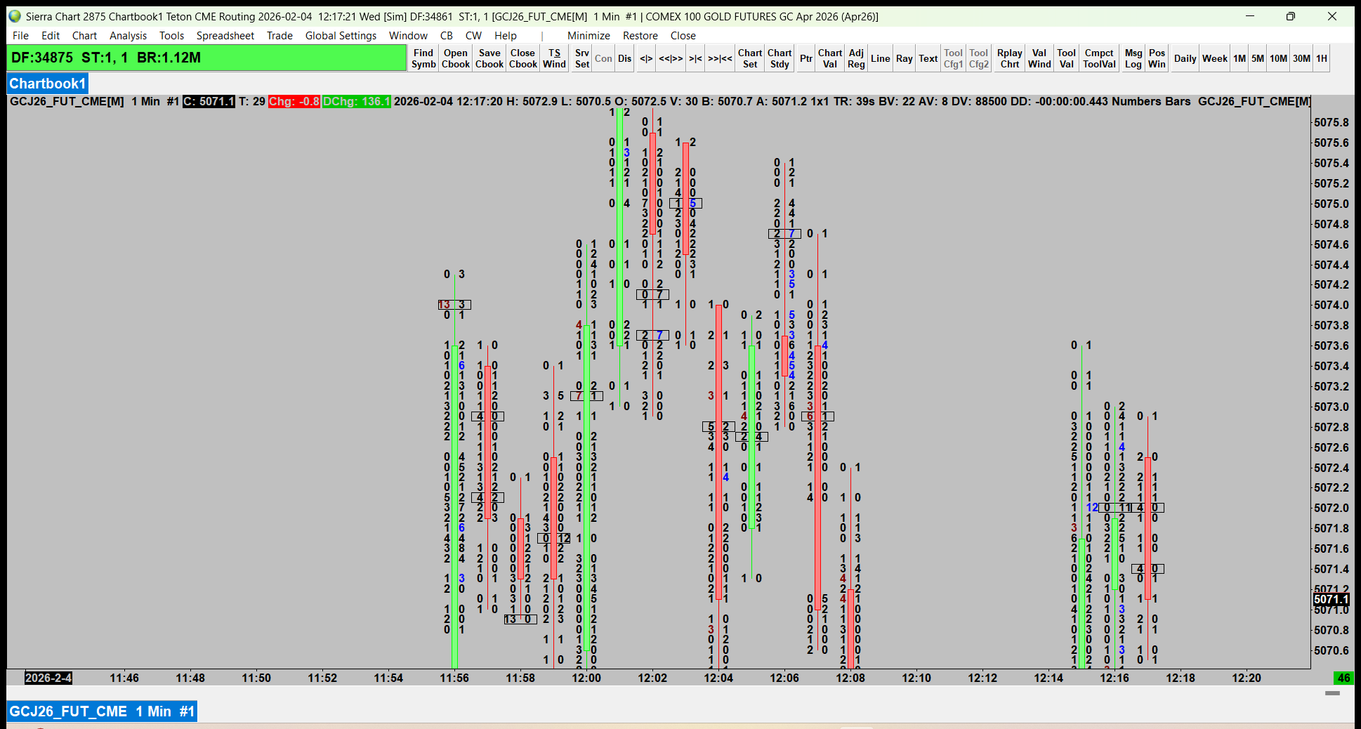

| [2026-02-04 12:21:05] |
this chart shows the issue where many zero values appear in numbers bars. i suspect there may be problem with tick data , but im not sure whether this is related to my settings or the data feed . https://www.sierrachart.com/image.php?Image=1770207444967.png https://www.sierrachart.com/image.php?Image=1770207444967.png |
| [2026-02-04 15:19:29] |
| John - SC Support - Posts: 48555 |
We see the same data as you are seeing, so there is nothing wrong and nothing set incorrectly. It is just how this product is traded.
