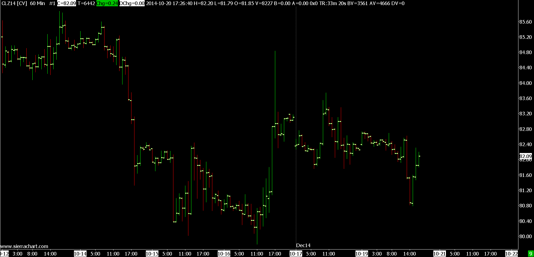

Here is the chart image you requested.
http://www.sierrachart.com/image.php?l=1413834494690.png
I just downloaded version 1203 and then did the edit >?delete all data and download and selected way back to the CLUZ and forward and I still don't have
any data on the chart for 10/17/14.
Let me know if you can duplicate the problem.

Did you enable Chart >>Show Rollover Dates.
When you select Edit >> Delete All Data and Download make sure you press No at the first prompt.
