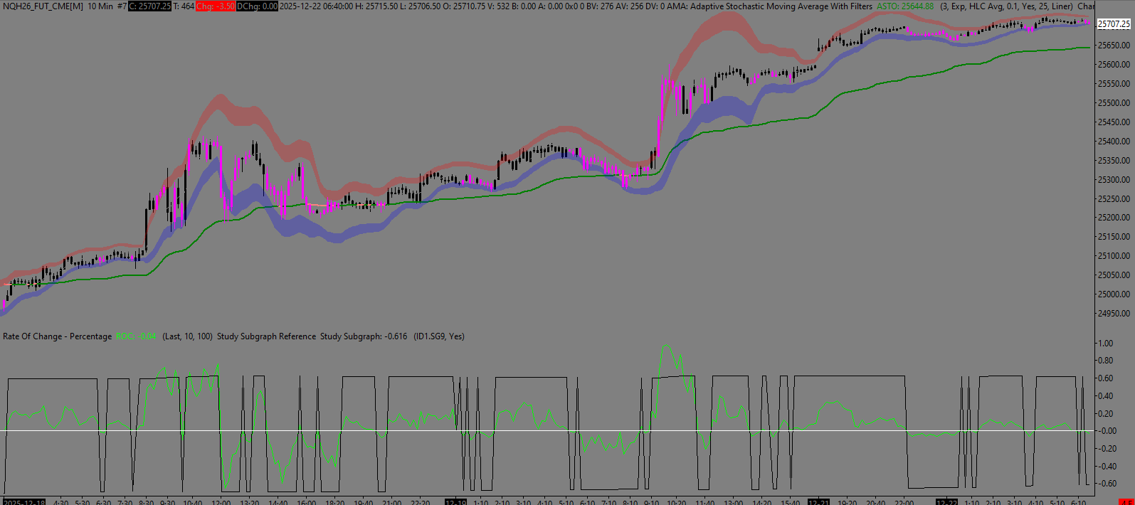

Hello, I'm trying to create a formula to color when the green line crosses above the black line or crosses below.
imageScreenshot 2026-01-02 110219.png / V - Attached On 2026-01-02 16:02:46 UTC - Size: 54.75 KB - 182 views

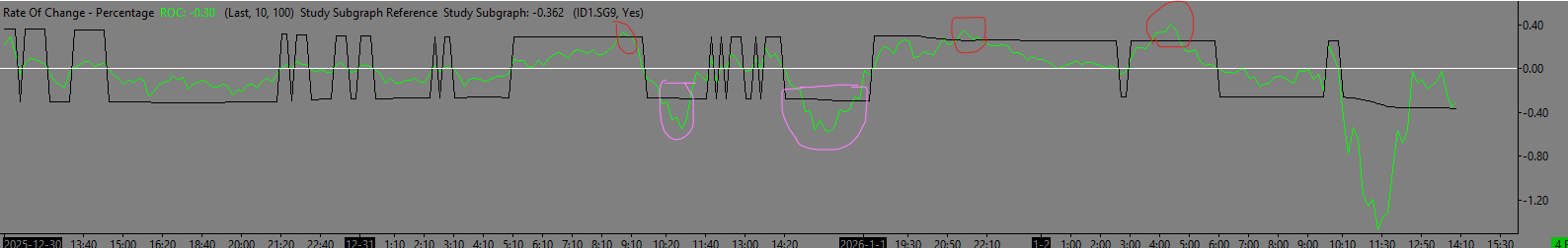

John, thank you. I want to color the bars. when the green line crosses above the the black line to signal a top and when the green lines crosses below signaling a bottom.
attached is a photo , red circles is the area that would signal tops and pink circles is the signals that would color bottoms

[2026-01-02 19:49:25]
Are you only wanting this to occur when both the black line and the green line are positive and both are negative?
For instance, as the time of 08:00 on January 2, 2026 there is green line above the black line, but the black line is negative, so we do not think you want this included.
Let us know if there are other considerations as well, and we can then point you in the proper direction.

User411320 - Posts: 379
If the green line crosses above the black line and both are positive that would color a bar ( over bought ), if the green line crosses below the black line and both are negative that would color a bar ( over sold )
