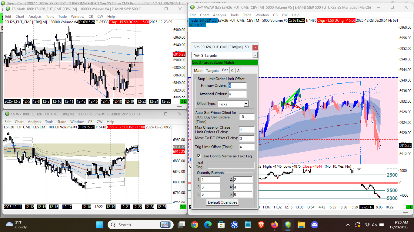

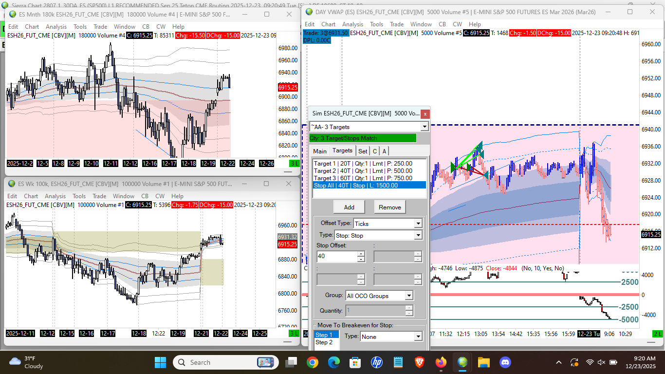

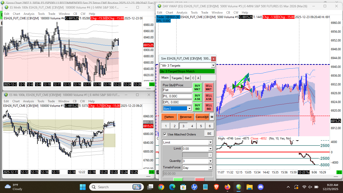

attached are print screens of my trade window.
imageScreenshot (437).png / V - Attached On 2025-12-23 14:22:37 UTC - Size: 213.39 KB - 116 views
imageScreenshot (436).png / V - Attached On 2025-12-23 14:22:44 UTC - Size: 210.75 KB - 104 views
imageScreenshot (435).png / V - Attached On 2025-12-23 14:22:53 UTC - Size: 211.04 KB - 118 views

The built-in Simulation Mode requires that Sierra Chart is running to process the orders. If Sierra Chart is not running, then nothing will take place, therefore it is not doing what you want.
If you want to be able to do Simulated trading and be able to turn off Sierra Chart, then use our "Simulated Futures Trading Service". Refer to the following:
