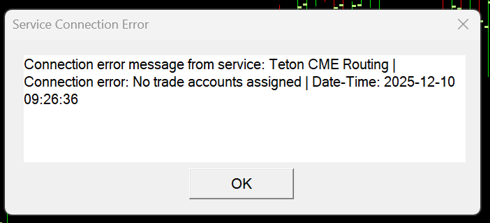

I am not able to connect to my AMP account data feed. Receiving error message below. I already updated my global settings. Copy of message log attached. AMP video instructs there is an AMP connection option on Sierra, this option is not available to me. I have suscribed to Teton/Denali and have a funded AMP account. I have copied my message log but I have not been able to find information on how to attach it to this message.

[2025-12-10 16:32:52]
John - SC Support - Posts: 48555
If you had a connection that was working and now is not working, then you would need to talk to AMP about what occurred.
If this is a new setup, then you also need to talk to AMP and see if they have completed the setup for the Teton Order Routing for your account.

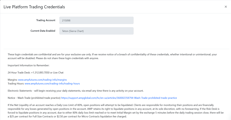

User603210 - Posts: 17
This is a new set up and AMP has completed the set-up; See attached screenshot

[2025-12-10 17:21:41]
Have you checked with AMP to ask them if they have done something with your account?

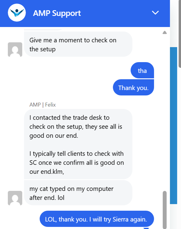

AMP says everything looks good on their end. Please see attached chat. I am getting a bit frustrated with the back and forth. I was under the impression this was basically automatic when I funded an account with AMP and suscribed to TETON/DENALI

[2025-12-10 19:14:11]
Sierra_Chart Engineering - Posts: 25432
Connect to the data feed:
Select "File >> Disconnect"
Select "File >> Connect to Data Feed"
[2025-12-10 19:22:08]
