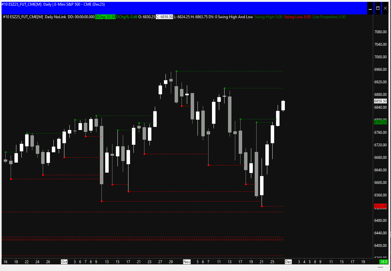

gz6969 - Posts: 59
I have the same problem after installing 2814 or 2815. The hand tool suddenly moves the chart instead only the content of the chart. "Support Vertical Scaling/Movement with Hand Tool" is set to Yes. I also see a blue title bar on every chart or DOM when "Show Title Bar" is activated. When I switch back to 2812 everything is normal. So it cannot be an OS issue.
The Sierra Screen Image tool does not capture the blue bar. That's why I had to capture this image with an externe screen imager
Date Time Of Last Edit: 2025-11-30 10:45:12
imageScreenshot 2025-11-30 114253.png / V - Attached On 2025-11-30 10:45:00 UTC - Size: 31.94 KB - 187 views
[2025-11-30 14:36:12]
This will be resolved in a new release coming out today:
These are Sierra Chart title bars and can be fully configured. Refer to:
Notice: Solution to: Chart/Chartbook Tabs Visibility Issues, Portions of Chart Window Cut Off | Post: 431980

[2025-11-30 16:10:33]

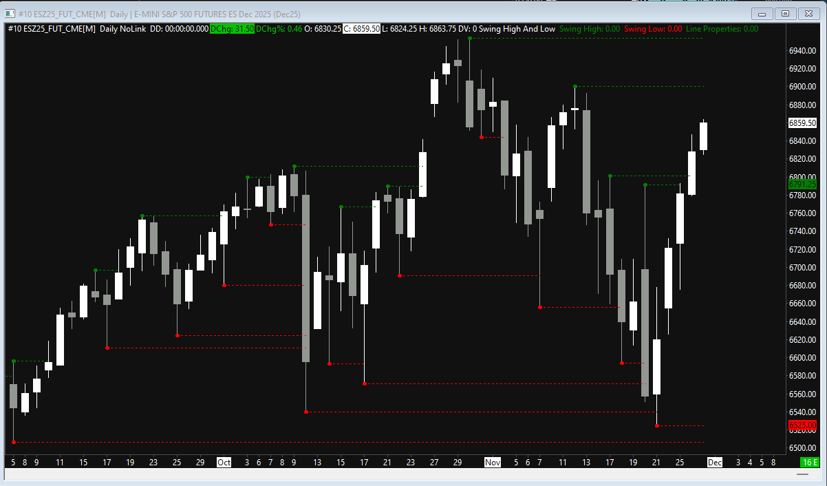

gz6969 - Posts: 59
1) thank you!!
2) But I did not change anything in the title bar. For comparison see in my new screenshot how the same chart looks like after reinstalling 2812. It looks normal as it should be. I don't know why the color is changing in 2814 or 2815 to blue. The blue titlebar in my first screenshot looks also a bit thicker and not three dimensional as the title bar in my second screenshot
Date Time Of Last Edit: 2025-11-30 18:00:55
imageScreenshot 2025-11-30 170630.png / V - Attached On 2025-11-30 16:10:20 UTC - Size: 36.52 KB - 164 views
[2025-11-30 22:50:58]
2. We will prepare documentation on how to reconfigure the title bar to how you want it to look.
The issue with the hand tool is now resolved in the latest prerelease.
Date Time Of Last Edit: 2025-11-30 22:51:12
