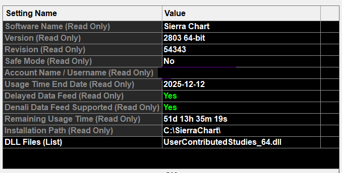

I have the service package 11, but my sierra chart is stil in the free mode and doens't see my service package 11. I allready installed the platform again but nothing. How can i fixe this because now im stil missing futures i can't use.
imagesierra.png / V - Attached On 2025-10-22 10:27:11 UTC - Size: 31.27 KB - 127 views

User551483 - Posts: 3
The numbers bars study was already possible to add in the free version, but it's still not possible to change the Graph Draw type to numbers bars. And not possible to change the study Graph Draw type.
[2025-10-22 14:53:16]
And when i go to help --> About i still don't see the version 11
[2025-10-22 18:38:32]
Help >> About does not show what package you have. You need to look at this on our website in the Account Control Panel for your account. You can access this by selecting "Help >> Account Control Panel" within your Sierra Chart software, or you can select the following link and login if needed:
Simulated Futures Trading Service
That being said, you are on Package 11, and per your Help >> About you have service through December 12, 2025.
The issue with the Numbers Bars is that you are not trying to access it correctly. It is not a Bar Period type, it is a study. Refer to the instructions here (ignore the first line about needed to be on Package 5 - that is old and needs to be updated):
Numbers Bars: Step-By-Step Instructions
