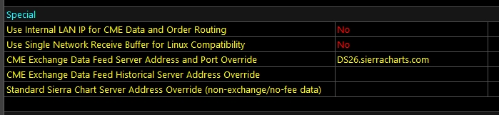

| Rui S - Posts: 258 |
How do you know you were using Lumen? When comes to Teton order routing connections, that is not even controllable.
You are correct, I can't control Teton but I was talking about Denali. As I always keep tracking regarding the latency of the servers, I always manually select Denali data through Lumen servers because, as I wrote above, Lumen servers are much better for my location. Date Time Of Last Edit: 2025-10-09 13:22:26
