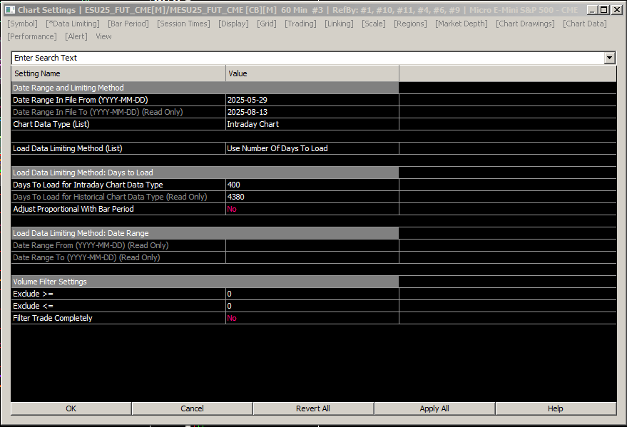

User925794 - Posts: 28
Hey Guys,
I've been busy moving, so not much action on the platform for the last 6 weeks so I was a little out of date on the current release.
I updated from 2761 to 2782 and it's not working out so well.
I saw there was some issues on the support board regarding historic data.
Trying to keep this short in 2 parts:
Part 1: I use long term anchored vwaps - up to a year. I used 60 min and Daily charts for those studies.
The problem I'm experiencing is that in "Chart Settings/Date Range and limiting Method/Date Range in File From" - this cell is limiting the date to 2025-05-29 (as of today).
Obviously, this is creating a situation where the vwap's anchored before this date are not calculating.
Part 2: The data downloads are excessive. SC is downloading data files from 2006. I see no reason for this. My longest "Use Number of Days to Load" is 400 for the 60 min intraday and 600 for the daily.
This is happening on ES and NQ.
Help!

The chart settings I currently have in place have existing for the past several years - especially the chart days back. This happened after the current version update. I have tried to go back to 2761 and then 2768 and the program locks up to the point I have to use Task Manager to close it down. Reloaded with 2782 and here we are.
I've uploaded a screen shot of my 60min chart settings for Data Limiting. If you'd like to see anything else, please tell me. But as I said, the selection for "Use Number of Days To Load is 400, but the Date Range In File From setting is stuck on 2025-05-29. If I change this date, it auto reverts back to May 29.
Help please...

Sierra_Chart Engineering - Posts: 25481
2025-08-12 18:03:57.633 | ESU25_FUT_CME/MESU25_FUT_CME [CB] 60 Min #3 | Limiting the number of years to 20 years to load data for the continuous futures chart. Reason: 20 years maximum for Intraday charts.
Regarding this, provide this particular chart by following these instructions:
This is simply the result, of a lot of processing needed by the Chartbook:
Refer to:
High CPU Usage | Inactive User Interface | Poor Performance | Long Time to Load Chart Data | Charts Reloading Often: 30.16 - What to do if Sierra Chart is in a frozen state for an extended time due to extended high CPU usage caused by an automatically or manually opened Chartbook
This is normal and as documented here:
Chart Settings: Date Range in File From / To (Chart >> Chart Settings >> Data Limiting >> Date Range and Limiting Method)
Definitively nothing wrong at all.
Regarding the Volume Weighted Average Price studies, this must relate to the underlying data in the chart and the settings of the study. Provide an image of one of these charts. Instructions:
And only one. Just one only and according to specifications. Otherwise, we are going to disregard this guaranteed.
Is there any missing data in that chart?

[2025-08-15 19:14:45]
We need more time on this. Are you available over the weekend? We see nothing in the Chart Settings causing data to be downloaded for 20 years. We do not know why that would be happening.
Is that particular issue still reproducible?
