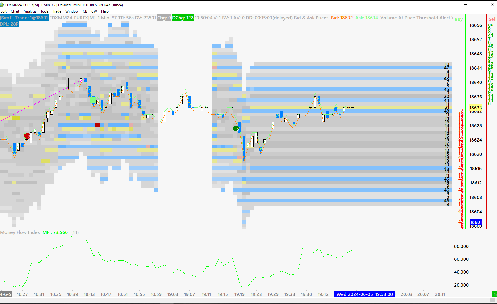

1. That's by far the worst news I heard this year. SO I am virtually UNABLE to evaluate with APEX on EUREX futures with you ? There's NO workaround other than pay for SC, pay for EUREX and then also use Tradovate platform to execute paying additionally for another EUREX data ? Alternatively would you have a suggestion which funding prop firm would be compatible both with SC and EUREX ? (For instance I'm hearing The Trading Pit has Rhitmic and dxFeeds for EUREX with the account, is it possible to connect their account to Sierra to use the EUREX data feed this way? Or any other provider for that matter...Topstep?)
3.,5. Thanks.
4. I get some messy stuff on delayed EUREX, sometimes there's no connection, sometimes it's stuck, for the most part it works fine but gives only 20 levels while there's more on the book ... Can it be better when on paid data ?
Date Time Of Last Edit: 2024-06-06 08:47:15
imageheatmap.png / V - Attached On 2024-06-06 07:21:28 UTC - Size: 106.48 KB - 317 views
[2024-06-06 16:30:52]
John - SC Support - Posts: 48520
1. We really do not know. We would have thought you could use Rithmic with APEX. But again, you would have to get the EUREX data from us to use in Sierra Chart.
4. It looks like this is just due to the settings you have for the Market Depth Historical Graph study. In particular refer to the following:
Market Depth Historical Graph: Maximum Levels to Display (0 for All)
And keep in mind that you are only going to have the Market Depth for when you are connected to the data feed and are recording the Market Depth data, or if you have the Market Depth Historical Graph study on the chart. Refer to the Symbol Setting for "Record Market Depth Data" here:
Global Symbol Settings: Symbol Settings
If you have missing data, however, you can download historical market depth data. Refer to the following:
Market Depth Historical Graph: Downloading Of Historical Market Depth Data

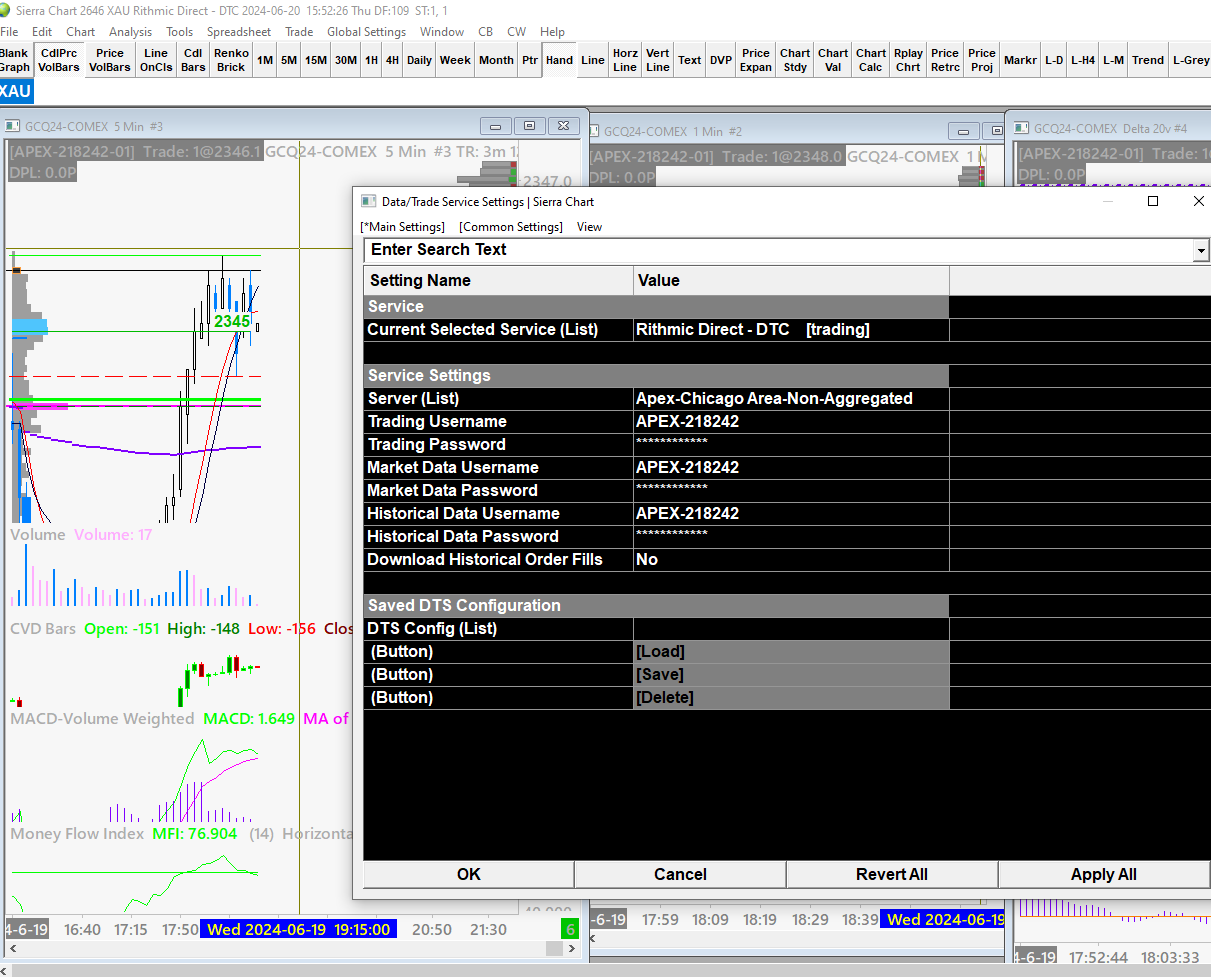

I' m trying to set up Apex's Rithmic account.
I want to check out if Rithmic data is enough for me before going for Denali CME. Also they have COMEX market depth for $10. I know I should already be regretting but: Should I leave the Market Data/ Historical Market Data Username empty or rewrite the Trading Username login ?
Apex has like a ton of servers , they don't exactly inform their clients which to choose. You would know what people choose preferably, Chicago aggregated / non-aggregated? Or maybe I should go for the nearest one ? Frankfurt in this case?
Thanks.
[2024-06-20 13:41:27]
If you want to use the Rithmic data, then you would need to enter your Username and Password in the Data fields on the "Data/Trade Service Settings" window.
We actually do not know which server to choose. We would expect APEX to give you this information.
[2024-06-20 13:46:47]
UnleashedPiglet - Posts: 67
Thanks.
It's seems to be logged on. Shows Rithmic Direct, and the APEX number. But there's no data update since yesterady. Any troubleshooting?
Date Time Of Last Edit: 2024-06-20 14:05:04
imagerithmicSC.png / V - Attached On 2024-06-20 13:54:58 UTC - Size: 94.39 KB - 283 views
attachmentmessagelog.txt - Attached On 2024-06-20 14:05:01 UTC - Size: 134.53 KB - 426 views
[2024-06-20 14:14:15]
Your symbols are not correct for Rithmic. Select "Edit >> Translate Symbols to Current Service" to resolve this. Refer to the following:
Edit Menu: Edit >> Translate Symbols To Current Service

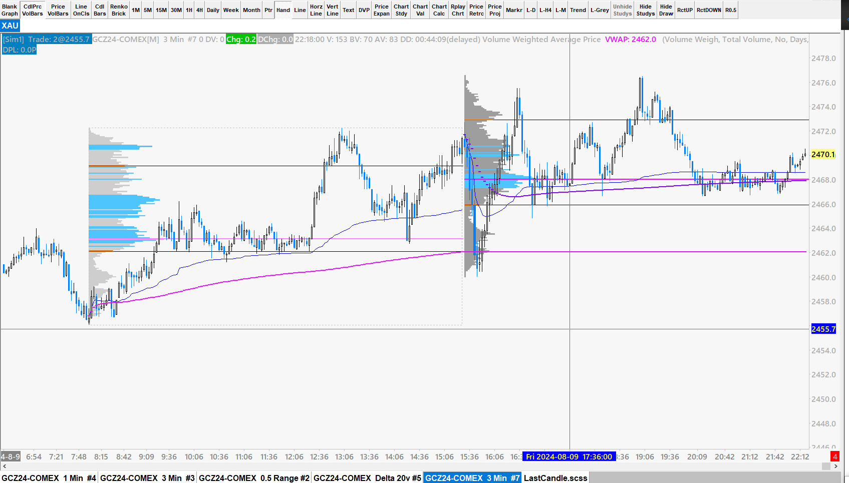

I'm using 2 VWAP studies, they keep showing the study from a specified day/time back, what if I want these to reset each 00:00 & 08:00 and not being forced to reset them manually every day for several charts ?
Is it possible?
To have a VWAP that starts at a specific time, use the "Volume by Price" study to set the start time for the VWAP and set the "Draw Mode" to "POC, VAH, VAL, VWAP Lines Only" and then you can turn off the subgraphs for the POC, VAH, and VAL in order to just get the VWAP line. Refer to the following:
Volume By Price Study: Draw Mode
1. I did as you said - the vwaps are different significantly. SS attached.
2. Come to think of it, wouldn't it be easier if I base the VWAP on VbP , don't touch the VbP (as I have a lot of gauges on and off there) and simply set Input Data on VWAP as Volume Weighted Average Price ? --> Which makes another question arise - how to get rid a remaining straight line across the next profile (I have 3 VbPs). Also seen on the ss.
Date Time Of Last Edit: 2024-08-11 12:45:22
imagevwapsaredifferent.png / V - Attached On 2024-08-11 12:45:16 UTC - Size: 79.88 KB - 276 views
[2024-08-12 16:12:39]
1. We are not sure what you are comparing in this case. What VWAPs are different?
2. You can not base the VWAP study on the Volume by Price study. Also, for what you are stating "simply set Input Data on VWAP as "Volume Weighted Average Price?" this would give you a VWAP of a VWAP, which does not make any sense, nor is there appropriate data to get an actual set of data from it.
2.5 We do not know how you have that setup. Is that a single VbP on the left side of the image, so these two profiles come from different instances of the study? Or are these two profiles from a single instance of the study?

1. The VWAP from VWAP study and the VWAP from VbP study. These are being compared.
3. Two profiles , the London session and the NY session. These both have been applied a VWAP study and the VbP VWAP (thinner line) and these studies are different.
Besides, the VbP VWAP have this strange ,,remnant'' of a VWAP that goes on to another profile and makes a straight line there. In this case it's dragging from London to NY and sitting there. How to get rid of that?

1. On the VWAP study, make sure the Input for "Base on Underlying Data" is set to "Yes". Otherwise these two studies will give different results.
3. You have the option for "Skip Empty Periods" enabled. Disable this option. Refer to the following:
