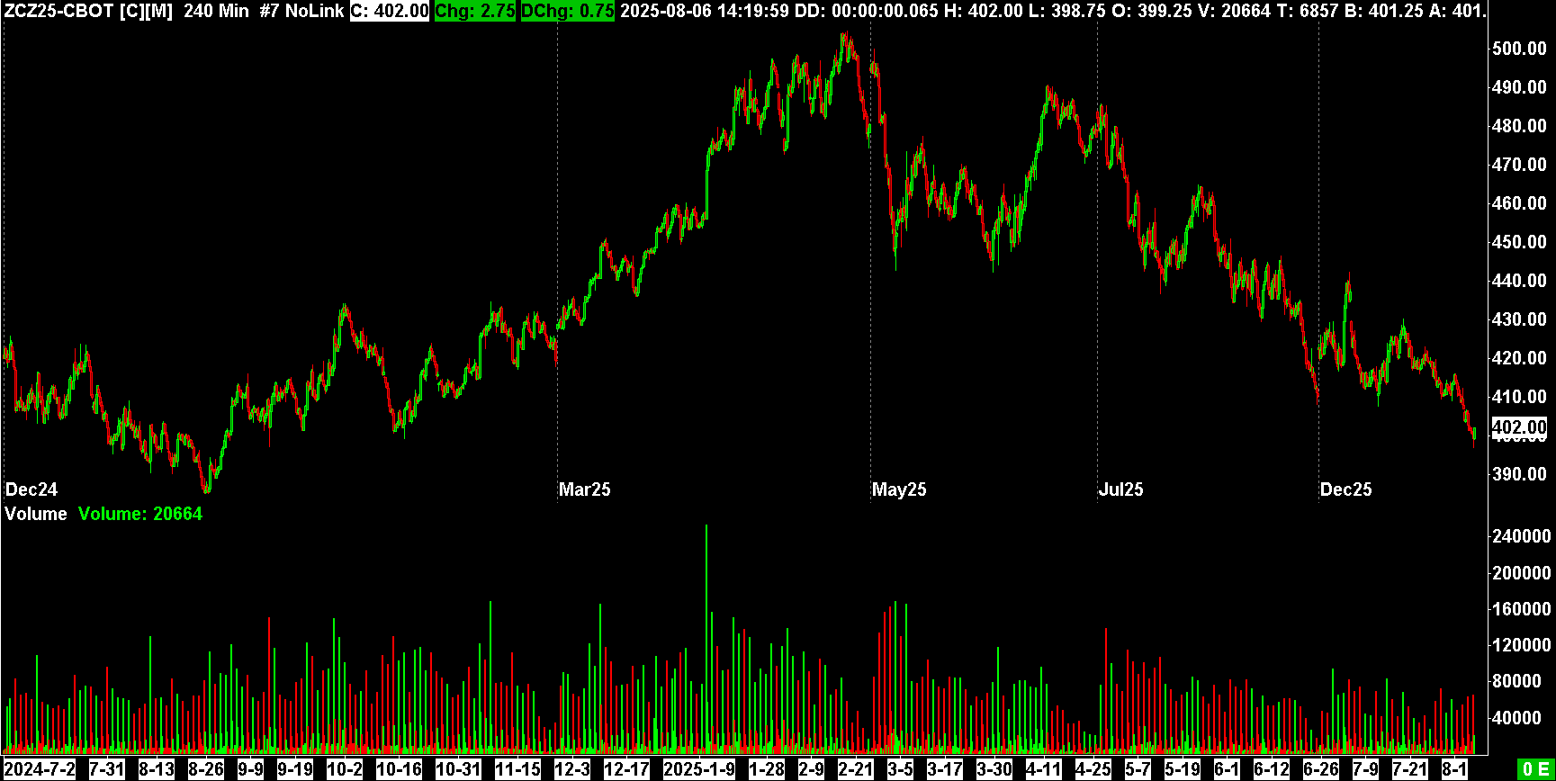

We had a close look at all the contract months for ZM: FHKNQUVZ None of them look unusually low with trading activity in the month or two before before the delivery month. So it seems like all months should be included. However, you do have the ability to control this. It is with this global symbol set in: Global Symbol Settings: Continuous Contract Months You just need to change that setting to custom and specify the month codes that you want in the continuous chart, and then reload the chart with Chart >> Reload and Recalculate. Also see our prior post. Sierra Chart Support - Engineering Level Your definitive source for support. Other responses are from users. Try to keep your questions brief and to the point. Be aware of support policy: https://www.sierrachart.com/index.php?l=PostingInformation.php#GeneralInformation For the most reliable, advanced, and zero cost futures order routing, use the Teton service: Sierra Chart Teton Futures Order Routing |
| [2025-08-06 22:21:24] |
| juicebro - Posts: 119 |
I'm currently switching to SC Data but I have many charts open so it will take a while for data to redownload. Regarding ZM: Second, it is normal that the last day in the chart or the most recently added data, will always be for the contract month of the symbol of the chart. Regardless of whether that contract month is active. This is why you can see a large bar at the end the chart, and not necessarily right away but when new data is added. This is normal and will not change:
Continuous Futures Contract Charts: Issues When Symbol of Chart is not Current Contract and Expires Later So we are not going to discuss that issue further. Do not chart the December contract at this time if it is not the active contract. How do you define the "active contract"? On July 14, when I shared the screenshot of ZM with the large bar, December was the contract with the most volume traded and December (ZMZ25) was already listed on the CME website as the "Globex Code." Denali 6M Mexican Peso continuous chart is broken | Post: 421103 Since I was using volume based rollover I expected the contract with the highest volume to be the active month. Date Time Of Last Edit: 2025-08-07 01:44:47

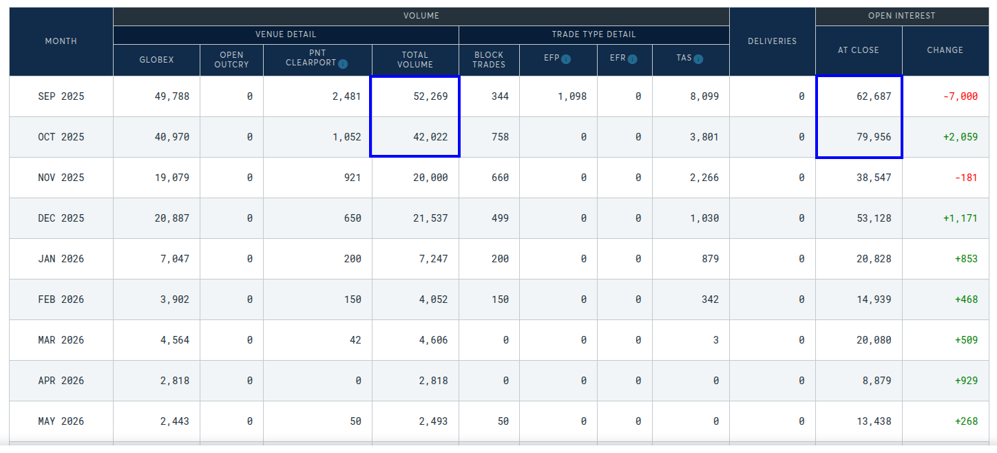

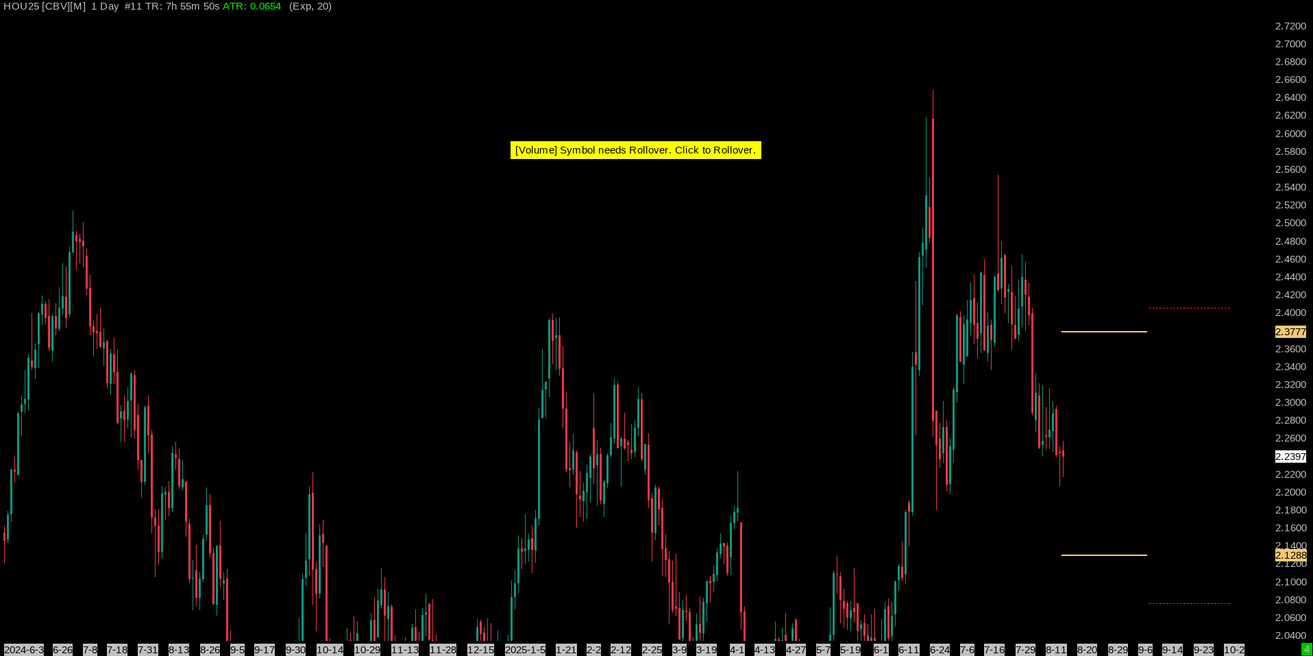

Is the comparison using Open Interest instead of volume? My HOU25 continuous chart with automatic volume-based rollover says "Symbol needs Rollover" https://www.sierrachart.com/image.php?Image=1755180865792.png But HOU has the highest volume on CME's website. https://www.cmegroup.com/markets/energy/refined-products/heating-oil.volume.html Only the Open Interest is exceeded by the next contract but I'm getting the sierra chart message to rollover to the next contract. *I have not changed any of the default Symbol Settings Date Time Of Last Edit: 2025-08-14 14:28:18
| [2025-08-14 15:06:17] |
| Sierra_Chart Engineering - Posts: 25476 |
No open interest is definitively not used. Only the volume. It is possible that the October volume for heating oil went temporarily higher. At this time October volume is only a little behind September. Just ignore the message. Just ignore it. There is a reason why it is there. We cannot spend all this time and all of these little details. Nothing is perfect. But actually it is perfect. If you got the message then definitively the next month absolutely had higher volume for a period of time. You can also disable the notification to rollover based on volume: General Settings Window: Detect Rollover Of Current Futures Contracts Symbols Based On Real Time Volume (Global Settings >> General Settings >> Charts >> Symbol) We know there is nothing wrong with this functionality, and we will not spend any further time on this. Sierra Chart Support - Engineering Level Your definitive source for support. Other responses are from users. Try to keep your questions brief and to the point. Be aware of support policy: https://www.sierrachart.com/index.php?l=PostingInformation.php#GeneralInformation For the most reliable, advanced, and zero cost futures order routing, use the Teton service: Sierra Chart Teton Futures Order Routing Date Time Of Last Edit: 2025-08-14 18:46:32
| [2025-08-14 17:38:23] |
It is possible that the November volume for heating oil went temporarily higher.
Did you mean October? Because October is the next contract. If it compares against November that contradicts what you said earlier; that it compares only the current and next contract. I'm not expecting perfect I just want to know what the hell I'm looking at so I know how to account for it and adjust my process. |

Yes we meant October heating oil (now corrected in the post above). We checked. That actually has higher volume now than September. As of about three or four hours ago.
