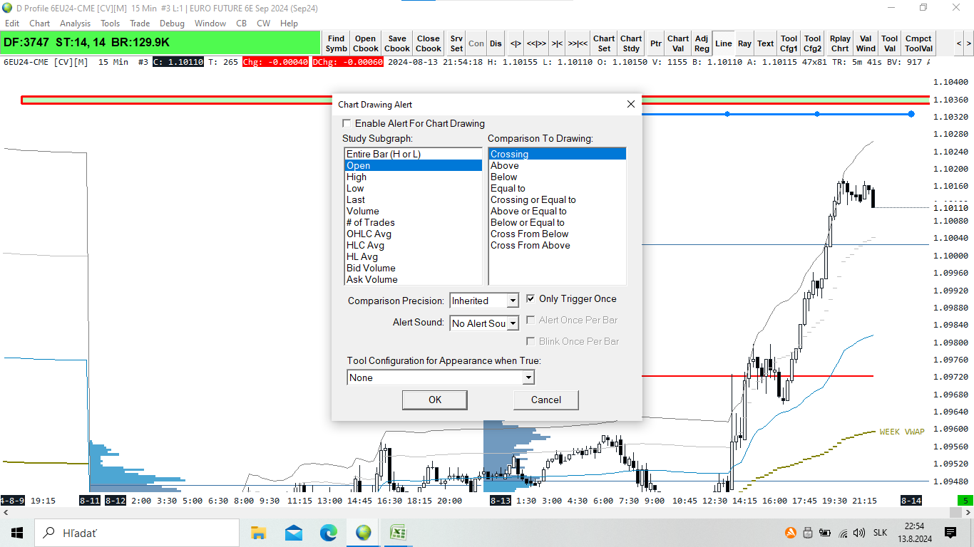

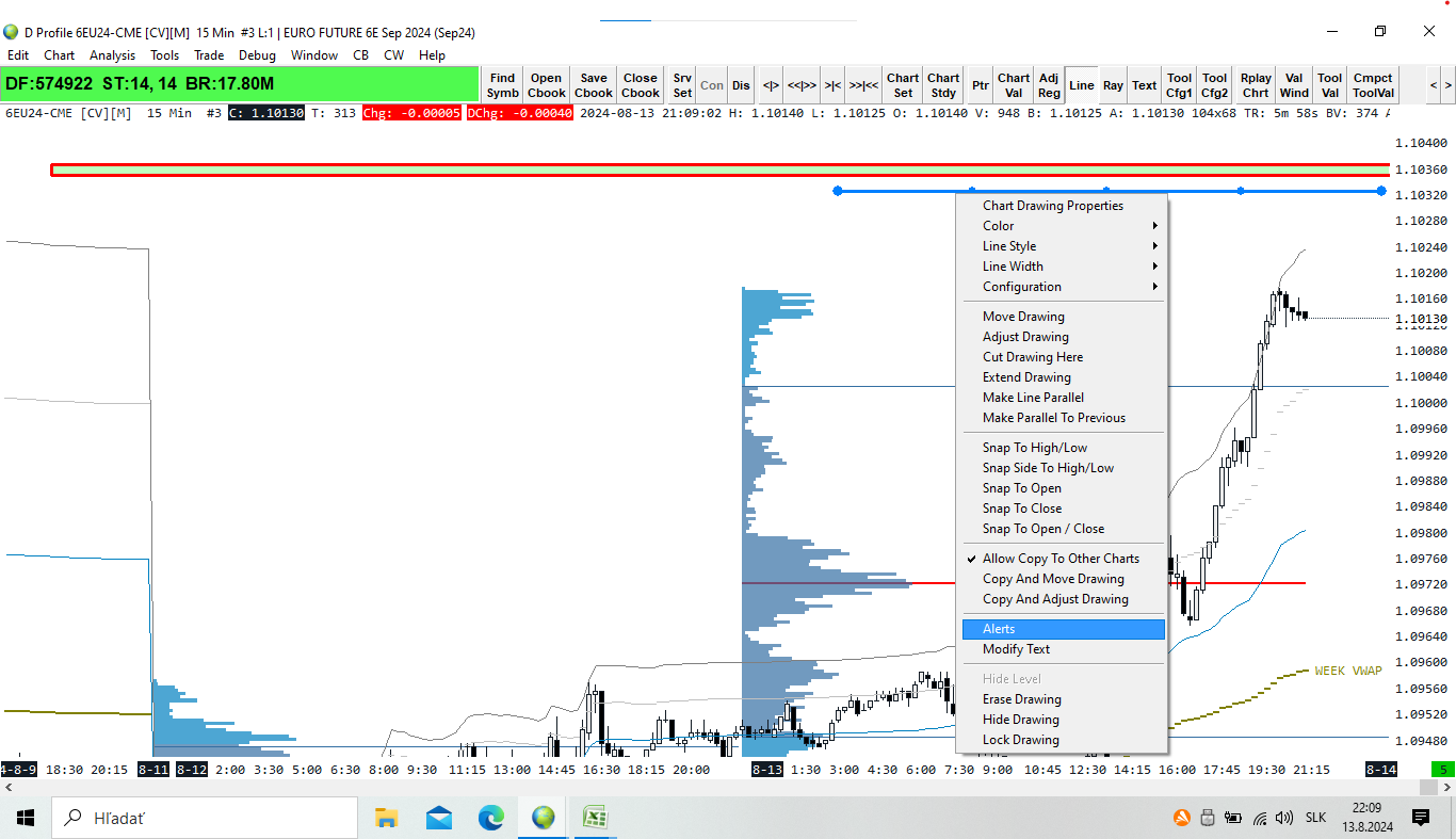

I apologize. I will try to express myself through pictures. example. imagine that the green part on the graph is the part where you want to trade according to your strategy. but you don't want to sit by the chart all day. so I set a few pips of the BLUE line, which allowed me to open the "Alert" box. The second picture is just to show which name I mean. I could theoretically set it up, but I have a problem pairing it with my phone and Telegram. I just need some guidance on how to do it. Did I give this information comprehensibly? I apologize, I'm a beginner. thank you for your help.

[2024-08-14 13:23:58]
So you are fine setting up the Drawing Alert, or do you need help with this?
In order to get an alert to Telegram, you first need to setup an alert number that you will use with the drawing alert. The instructions to setup an alert number are at the following link:
General Settings Window: Configuring Alert Number Instructions
You then need to make sure you have that alert number selected for the Alert Sound on the Chart Drawing Tool Alert that you have created.
The next step is to setup the Chat to receive the alerts. Follow these instructions:
Chat and Communications Platform: Using Chat for Remote Alert Notifications
Then to get this to work with Telegram, follow these instructions:
Chat and Communications Platform: Telegram Integration

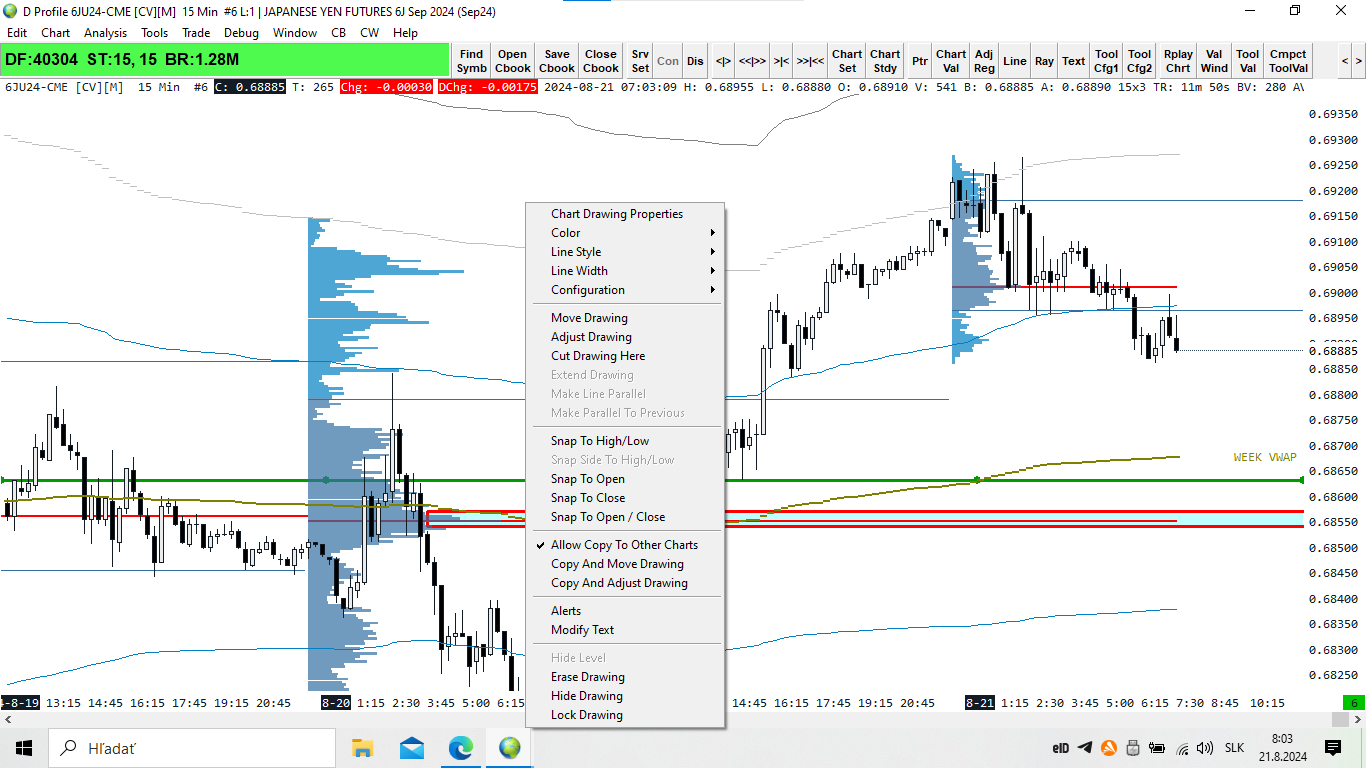

Thank you for your help, I managed to connect Telegram with Sierra Chart, but I still can't finish drawing it on the graph. Can you please look at it for me, where I can make a mistake?
example, the blue area on the chart is the area I'm waiting for and want to trade. The green line shows the ALERT that I would like to activate so that it warns me in time. I am sending a photo of how I filled it out. thank you for your help.

[2024-08-22 15:54:55]
You are selecting the "Open" to be crossing the drawing. If you want an alert when the price crosses the drawing, then you need to select the "Last".
