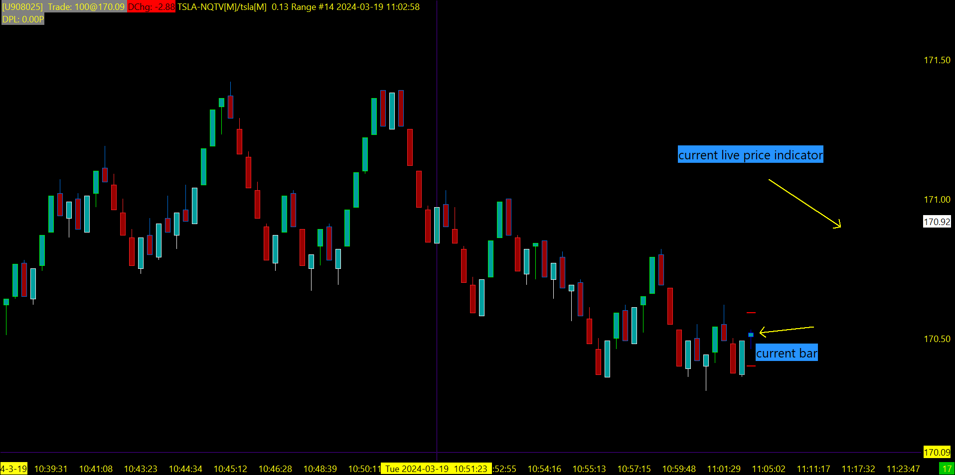

Current live price indicator is far away from the current price bar.

Hello Support: I don't know how to fix this, please help, thank you. |

Please get us an image of what you are seeing by following these instructions: Support Board Posting Information: Attaching or Posting a Screenshot/Image (Optional) For the most reliable, advanced, and zero cost futures order routing, use the Teton service: Sierra Chart Teton Futures Order Routing |

| 3152sier - Posts: 55 |
hello I tried to attach a chart but it did not upload. can I send the chart image by email. I get the message chart uploaded and the file name but I don't see it here attached to this message. |

I see now chart was attached in the last message from me. Thank you. |

Refer to the following: Intraday Chart or Chart Bars Not Updating | Blank Intraday Chart | "Currently no data to display" message for Intraday Chart For the most reliable, advanced, and zero cost futures order routing, use the Teton service: Sierra Chart Teton Futures Order Routing |

Hello Support: I need help with this issue as I have tried. At the top of the chart it says delayed. Thank you. |

Are you still having this problem during the active day trading session that is now open?
| [2024-03-20 18:44:02] |
Yes the problem is still there. Thank you. |

Please get us your message Log by following these instructions: Follow the instructions here to clear the Message Log: Message Log: Clearing the Message Log Close all of the Chartbooks with "File >> Close All Chartbooks". Open a single chart for the symbol you have an issue with through "File >> Find Symbol". Tell us that symbol of the chart. Tell us about *one* symbol only. Disconnect from the data feed with "File >> Disconnect". Connect to the data feed with "File >> Connect to Data Feed". After the connection and after about 10 seconds, provide a copy of the Message Log following these instructions: Support Board Posting Information: How to Post Your Message Log (Required In Some Cases) We will then determine what the problem is. For the most reliable, advanced, and zero cost futures order routing, use the Teton service: Sierra Chart Teton Futures Order Routing |
| [2024-03-21 18:52:06] |
Hello Support: Symbol:AMD log sent using "send for analysis" |
| [2024-03-21 19:40:38] |
| John - SC Support - Posts: 48586 |
You have the "NASDAQ TotalView" exchange active from us. As such, you need to enter your chart symbols for U.S. Equities with a -NQTV suffix, so for AMD you would need to enter AMD-NQTV in order to get the data from our NASDAQ TotalView exchange. Refer to the following: Denali Exchange Data Feed: Nasdaq TotalView Data Feed Notes The log you sent shows that you only had the symbol entered as "AMD", therefore this would pull the data from our "U.S. Equities Consolidated Tape" exchange, for which you are not setup to get the real-time data. This is why you were getting the delayed data for this chart. And keep in mind that since you are using Interactive Brokers, you need to use the "Trade and Current Quote Symbol" and enter the full Interactive Brokers symbol in order to actually trade the equities. Refer to the following: Notice: Upcoming Mandatory US Equities/Stocks Symbol/Data Changes for Interactive Brokers For the most reliable, advanced, and zero cost futures order routing, use the Teton service: Sierra Chart Teton Futures Order Routing |
