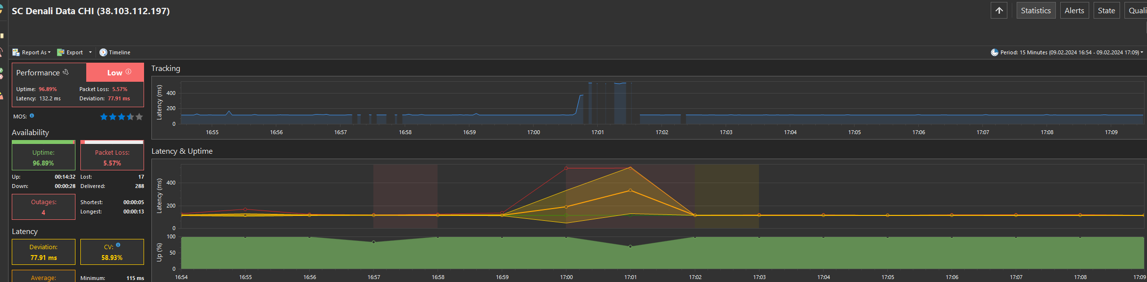

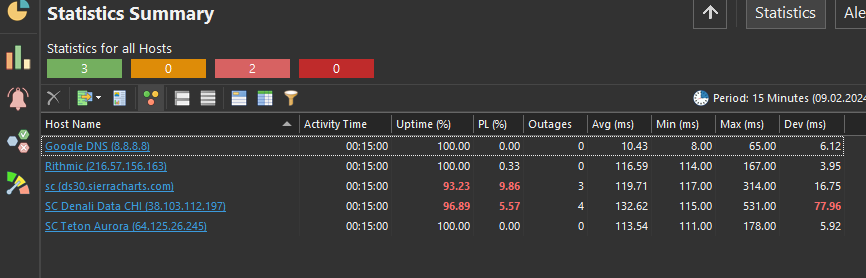

nosast - Posts: 327
User330437:
are you also based in Europe? I have the same issues going on for months with Denali and switched to Rithmic until this gets solved for good. I tried everything and also different internet providers with no luck and currently thinking that it's caused by backbone-routing. Next step I'm trying is to get a VPS next to CHI and execute via remote desktop.
Teton and Rithmic for example are rocksolid. Attached are screenshots from a few minutes ago when Nasdaq broke 18k.
Date Time Of Last Edit: 2024-02-09 16:32:34
imageSNAG_ 2024-02-09 - 17-06-00.png / V - Attached On 2024-02-09 16:13:19 UTC - Size: 31.96 KB - 313 views
imageSNAG_ 2024-02-09 - 17-10-14.png / V - Attached On 2024-02-09 16:13:22 UTC - Size: 76.23 KB - 372 views
imageSNAG_ 2024-02-09 - 17-09-47.png / V - Attached On 2024-02-09 16:13:38 UTC - Size: 73.15 KB - 308 views

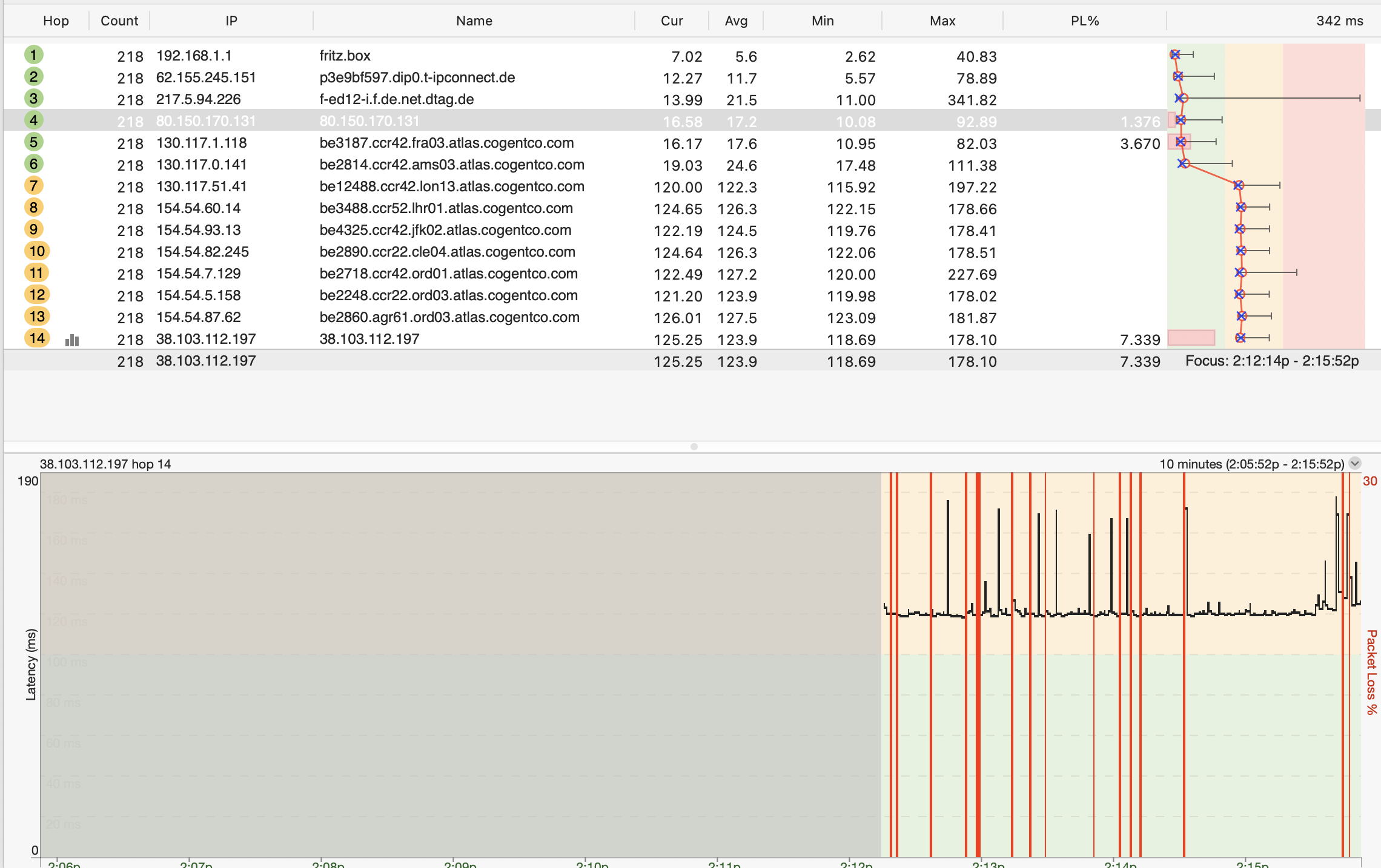

nosast - Posts: 327
Attached is a traceroute from Germany. Shows the same like the example you mentioned from Portutal. It looks like a peering issue with Cogent or any other carrier involved in the route. Thanks for getting this sorted out - really looking forward to be able to trace the route back from Chicago to my location to see the full picture.
Hop Sent PL% Min Max Avg Host Name / [IP]
1 453 0 2.05 40.83 5.32 fritz.box [192.168.1.1]
2 453 0 5.51 78.89 11.15 p3e9bf597.dip0.t-ipconnect.de [62.155.245.151]
3 453 0 10.80 341.82 37.05 f-ed12-i.f.de.net.dtag.de [217.5.94.226]
4 453 1 10.08 92.89 15.38 80.150.170.131 [80.150.170.131]
5 453 3 10.70 95.85 17.05 be3187.ccr42.fra03.atlas.cogentco.com [130.117.1.118]
6 453 0 17.48 122.13 24.28 be2814.ccr42.ams03.atlas.cogentco.com [130.117.0.141]
7 453 0 115.81 228.63 122.04 be12488.ccr42.lon13.atlas.cogentco.com [130.117.51.41]
8 453 0 122.15 187.65 125.90 be3488.ccr52.lhr01.atlas.cogentco.com [154.54.60.14]
9 453 0 119.70 179.69 124.85 be4325.ccr42.jfk02.atlas.cogentco.com [154.54.93.13]
10 453 0 122.06 191.65 126.58 be2890.ccr22.cle04.atlas.cogentco.com [154.54.82.245]
11 453 0 119.58 227.69 126.43 be2718.ccr42.ord01.atlas.cogentco.com [154.54.7.129]
12 453 0 119.98 178.02 123.78 be2248.ccr22.ord03.atlas.cogentco.com [154.54.5.158]
13 453 0 123.05 182.11 127.24 be2860.agr61.ord03.atlas.cogentco.com [154.54.87.62]
14 453 9 118.69 178.10 123.09 38.103.112.197 [38.103.112.197]
Date Time Of Last Edit: 2024-02-11 13:26:37
imageScreenshot 2024-02-11 at 14.15.53.png / V - Attached On 2024-02-11 13:19:33 UTC - Size: 647.37 KB - 359 views

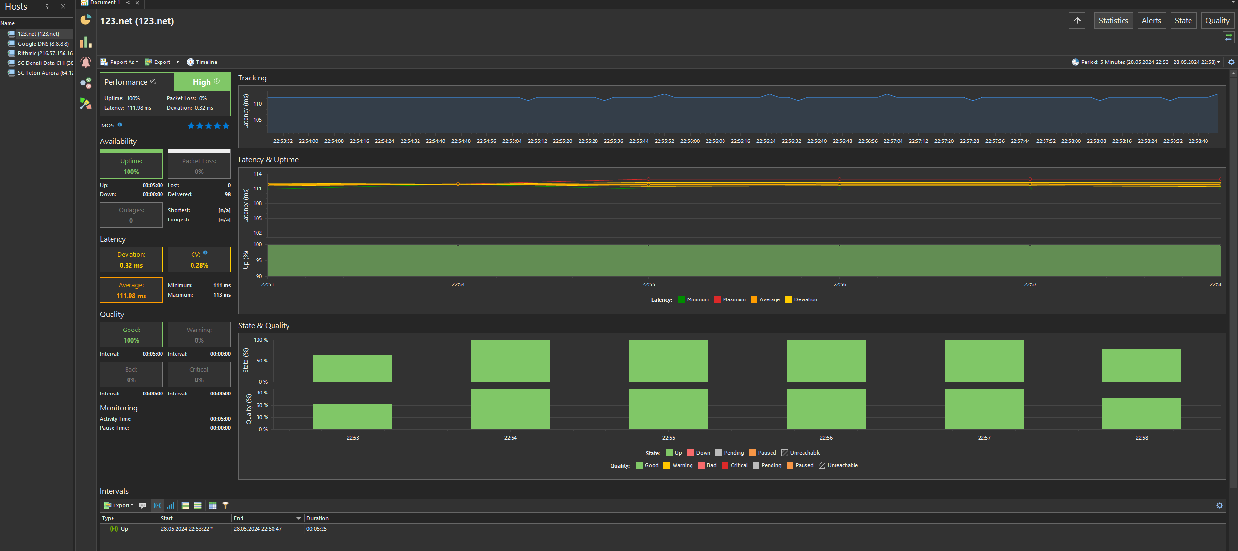

nosast - Posts: 327
@Sierra_Chart Engineering
I just read the thread "Sierra Chart Internet Connectivity Related Issues" and as it's locked I will respond here.
As you already know I'm really looking forward do be connected to the new DC or at least without Cogent as peering partner in the trace. As I have a network statistics tool running during RTH I get notified about latency issues like paket loss and jitter immediately and can say with 99% certainty that Cogent is causing all these issues for guys connecting from overseas (I'm located in Europe). Teton order routing on the other hand is peering via Zayo and is rock solid so I would have loved to Zayo as the new ISP for the Michigan DC. But the solution you are implementing right now looks good if 123.net is really peering to Zayo, Lumen, NTT, AT&T or any of the other big Tier1 carrier.
Please let me know if I could be of any help. If you send over an IP I can run continues monitoring tests for a first check (at least for connections from Europe). For the time being I added 123.net into the monitoring (the IP behind this URL is out of their network AS12129) and therefore should be a good first indication. The only thing to think about is that 123.net accoriding to peeringdb.com only has a few locations all in Detroit area with no connection to bigger peering/exchange points.
https://www.peeringdb.com/org/10627
But this may also be a good thing as e.g. CH1 Equinix is very crowded and has quite some realtime latency issues across all carriers which should not be the case in Detroit. If you think about it that get's pretty obvious how much data in realtime gets distributed out of the worlds central futures exchanges out of Chicago area.
Current route to 123.net over 9 hops (looks good to me)
3 1 0 11.04 11.04 11.04 m-ef2-i.M.DE.NET.DTAG.DE [217.0.194.22]
4 1 0 10.84 10.84 10.84 m-ef2-i.M.DE.NET.DTAG.DE [217.0.194.22]
5 1 0 13.21 13.21 13.21 80.150.168.185 [80.150.168.185]
6 1 0 105.46 105.46 105.46 ae5.cr1-det3.ip4.gtt.net [89.149.143.133]
7 1 0 117.70 117.70 117.70 ip4.gtt.net [66.171.226.42]
8 1 0 112.71 112.71 112.71 67.214.125.193 [67.214.125.193]
9 1 0 112.52 112.52 112.52 123.net [216.109.194.6]
Compared to the current Cogent route over 16 hops
3 11 0 9.32 10.02 9.64 f-ed12-i.F.DE.NET.DTAG.DE [217.0.192.202]
4 11 0 8.54 72.75 19.53 f-ed12-i.F.DE.NET.DTAG.DE [217.0.192.202]
5 11 0 8.44 9.64 8.95 80.150.170.131 [80.150.170.131]
6 11 18 8.72 13.68 9.50 be3187.ccr42.fra03.atlas.cogentco.com [130.117.1.118]
7 10 0 14.28 15.31 14.90 be2814.ccr42.ams03.atlas.cogentco.com [130.117.0.141]
8 10 0 110.18 111.02 110.64 be12488.ccr42.lon13.atlas.cogentco.com [130.117.51.41]
9 10 0 109.05 111.16 109.75 be3488.ccr52.lhr01.atlas.cogentco.com [154.54.60.14]
10 10 0 109.90 111.12 110.45 be4283.ccr32.bos01.atlas.cogentco.com [154.54.47.145]
11 10 0 114.81 115.55 115.30 be3600.ccr22.alb02.atlas.cogentco.com [154.54.0.221]
12 10 0 110.00 111.04 110.50 be2879.ccr22.cle04.atlas.cogentco.com [154.54.29.173]
13 10 0 108.98 110.12 109.56 be2718.ccr42.ord01.atlas.cogentco.com [154.54.7.129]
14 10 0 114.88 115.45 115.15 be2766.ccr41.ord03.atlas.cogentco.com [154.54.46.178]
15 10 0 111.27 111.79 111.48 be2051.agr61.ord03.atlas.cogentco.com [154.54.84.50]
16 10 0 108.68 109.65 109.16 38.103.112.197 [38.103.112.197]
Attached is also a latency stat from the monitoring of 123.net. Jitter is very good/minimal at the moment.
Date Time Of Last Edit: 2024-05-28 21:08:21
imageSNAG_ 2024-05-28 - 22-59-12.png / V - Attached On 2024-05-28 20:59:35 UTC - Size: 110.37 KB - 267 views
