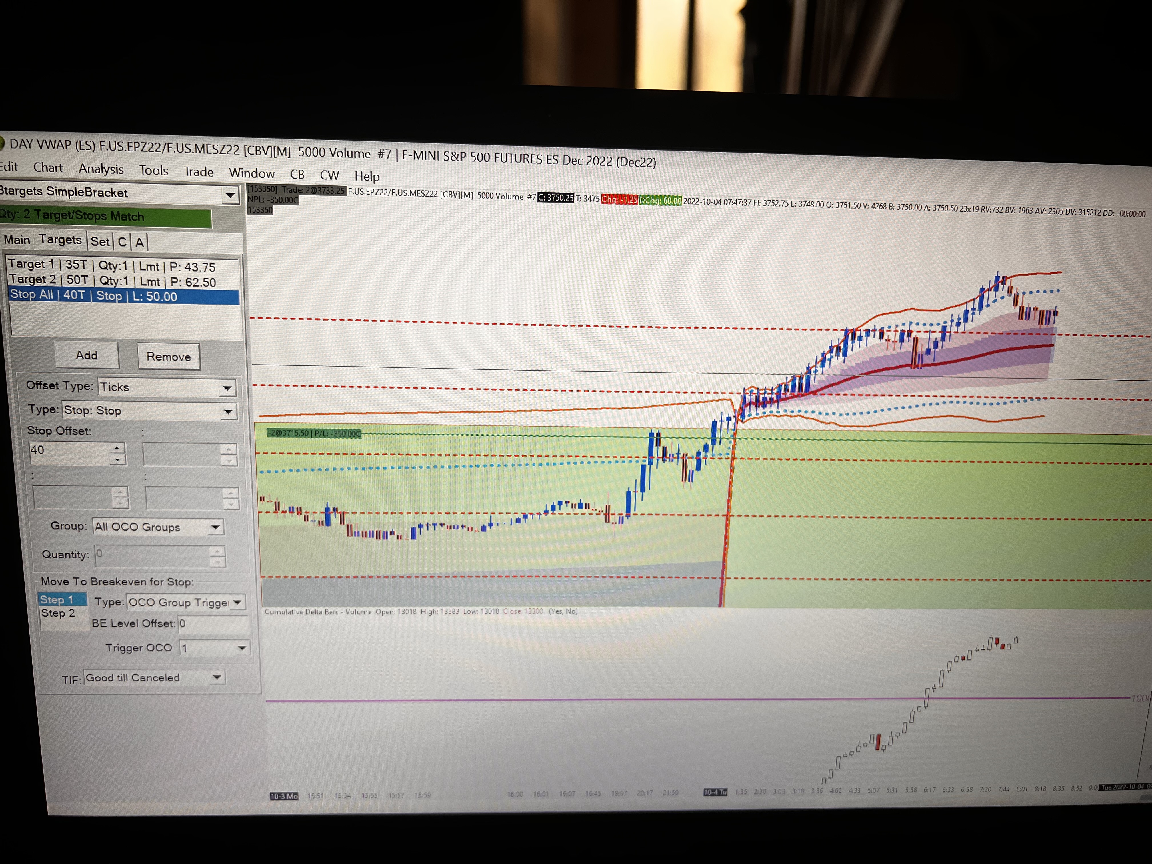

Hi.
Please check the attached image.
I placed a pending order last night, 3rd of October, on my Sierra chart real account.
Volume on 2, opened (check image) just below the CVA high, stop loss just above the CVA high.
Two targets on the next two Point of control, below.
I open my laptop this morning and to my surprise, the targets and stop loss had disappeared, meaning I was losing about 500 dollars, because the stop loss hadn't been triggered.
I need your help here, something did not work correctly, and I need to know what it was, exactly.
Please get back to me asap.
Regards
Paulo
imageTargets and stop disappear.jpg / V - Attached On 2022-10-04 20:32:33 UTC - Size: 3.37 MB - 345 views
[2022-10-04 21:56:51]
John - SC Support - Posts: 47980
You can check the Trade >> Trade Service Log, but we doubt any information is in there since you state that you had exited Sierra Chart.
The other place to look is on your Trade >> Trade Activity Log and look at the orders for your Stop and see if it states why it may not have been placed.
But, in the end, the fastest way will be to ask your broker what occurred with the Stop order and why it was not sitting on the exchange as you expected it to be.
[2022-10-05 05:57:10]
Sierra_Chart Engineering - Posts: 24945
When you exited Sierra Chart had the parent order filled or not? If not, then the target and stop order would not have been working at the exchange since you are using CQG.
This is why we recommend using Teton order routing:
From our CQG documentation:
Server Managed Bracket Orders: No. Support has been removed as of version 1819 due to unexpected behavior with this order type on CQG. For Server Managed Bracket orders, it is necessary that you use the Teton Order Routing Service instead of CQG.
This is actually one of the strongest reasons why Sierra Chart recommends using the Teton Order Routing Service instead of CQG, if you are trading CME Group. When server-side bracket orders, are not supported, this makes order handling less safe.
