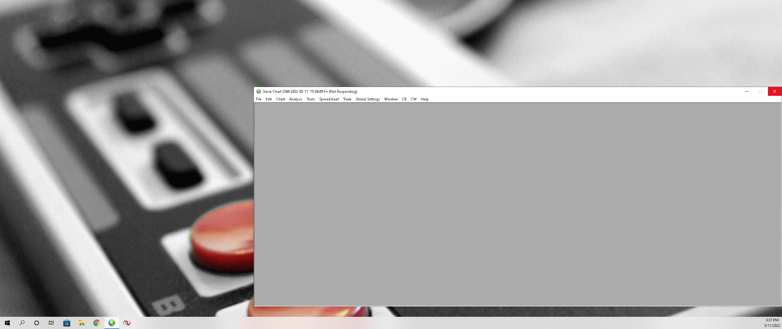

Program is not responding when I try to start it. Check attached image please.
I have tried to restart my laptop, updating software on my laptop, initiating the program in safe mode, initiating the program without "open files on startup", but issue persists.
Please help, thanks
imageSierra stuck.PNG / V - Attached On 2022-03-11 21:44:19 UTC - Size: 1.81 MB - 465 views

When you start Sierra Chart in Safe Mode and without automatically opening Chartbooks, you still get the software in a "Not Responding" state?
In general, the window should look similar to what your image looked like, as there are not charts open, but it should not be "Not Responding". Please double check this by trying to select File >> Open Chartbook and see if you can open a chartbook.
Then see if the program becomes completely unresponsive or not.
[2022-03-11 23:21:54]
User200064 - Posts: 31
Correct, I can't perform any action, it says "Not Responding" as soon as I start the program
