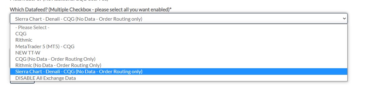

Hi, everything is good, just two more questions:
Does Denali also include real-time data for the cash index DAX and the cash index SP 500?
What do I have to select at AMP if I take Service Pack 10?
regards

[2021-12-09 16:47:40]
The DAX and SP500 are both available through the Denali Exchange Data Feed, although you will need to activate the exchange(s) you need for the CME Group to get the S&P 500 (ES) and then the EUREX exchange to get the DAX (FDAX).
The instructions to setup the Denali Exchange Data Feed for the CME Group is here:
And then you would go through the instructions for the EUREX here:
https://www.sierrachart.com/index.php?page=doc/DenaliExchangeDataFeed.php#SetupInstructions_EUREX
The item you have highlighted (Sierra Chart - Denali - CQG (No Data - Order Routing Only)) is the correct one to select for your AMP account, since you will be getting the data from us through our Denali Exchange Data Feed.

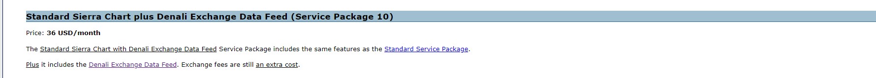

[2021-12-10 08:35:42]
User575872 - Posts: 78
Hi, thanks and okay, but there are still some questions for me:
With the link you sent, the price for Service Package 10 Standard including Denali is $ 46, on the SC website for the description of the packages it is $ 36 (see attachment). What is the currently valid price?
If I understand everything correctly, that would be $ 36/46 plus, for example, a CME fee of $ 10.40 plus a Eurex fee of $ 25? (both depth of market)
CQG appears for this option in the AMP description (Sierra Chart - Denali - CQG, No Data - Order Routing Only). To what extent are there still costs?
Thank you and best regards
Wolfgang
imagePackage 10.jpg / V - Attached On 2021-12-10 08:31:44 UTC - Size: 44.68 KB - 203 views
[2021-12-10 09:59:18]
No it does not. Futures only.
The price of Service Package 10 is 36 USD per month. Exchange fees are extra and as you explain above.

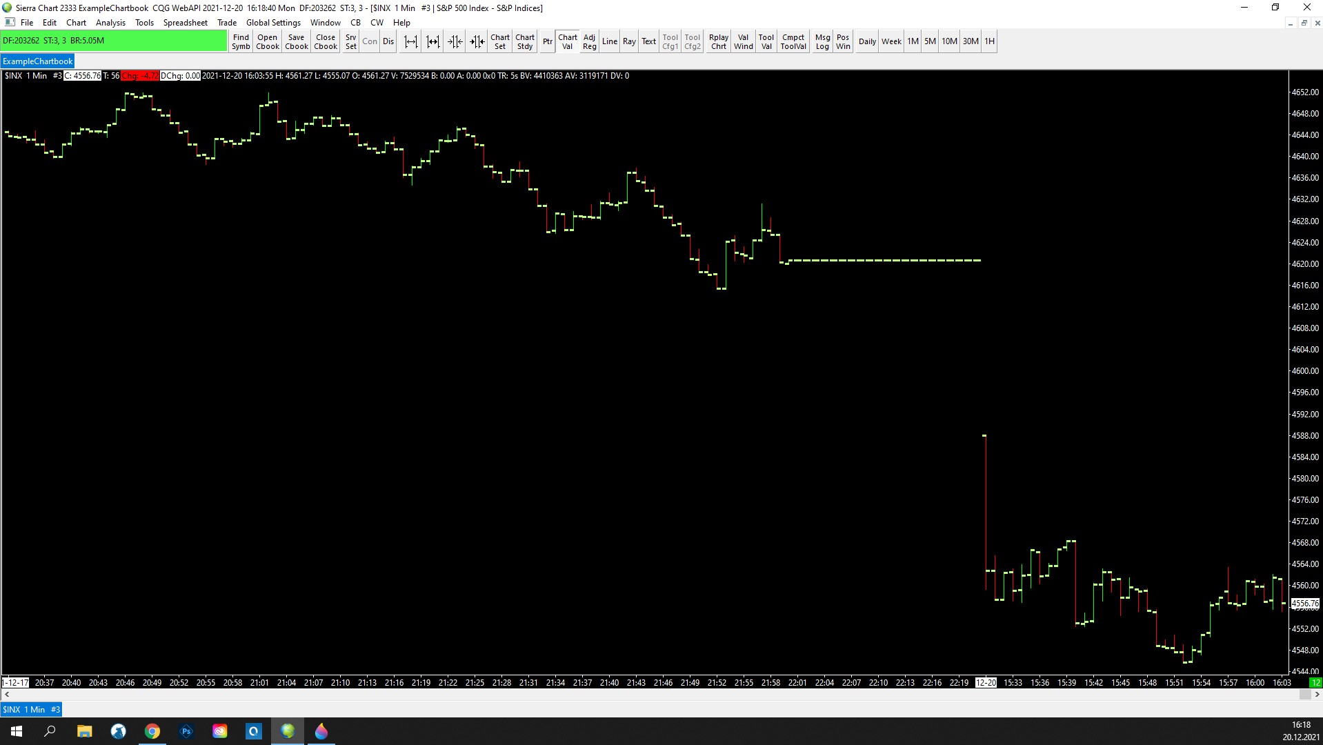

[2021-12-20 15:21:57]
Hi, thanks, sorry, I just don't understand (maybe because of my mediocre English ...) where should I sign for the Cash Index S+P? I have delay data (see attachment), but no real time. What should I do?
imageIndex.jpg / V - Attached On 2021-12-20 15:21:30 UTC - Size: 186.98 KB - 269 views
[2021-12-20 16:48:52]
To get Real-Time data for that symbol ($INX), you would need to use the Sierra Chart Exchange Data Feed and enable the S&P Indices exchange.

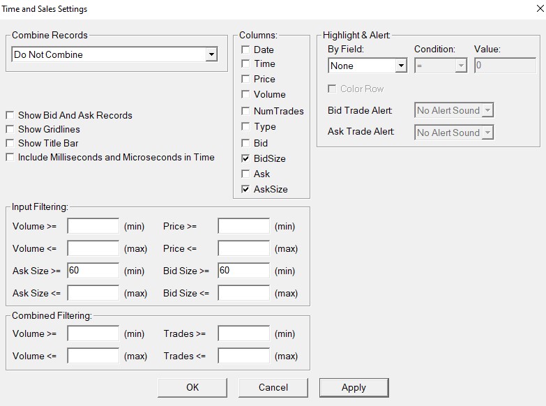

[2021-12-21 17:25:09]
Hi, everything works fine. Just a small question: I have set Time & Sales as in the photo, but it also shows ask bid sizes that are smaller than 60. What should I do?
imageTime_Sales.jpg / V - Attached On 2021-12-21 17:24:04 UTC - Size: 78.64 KB - 295 views

[2021-12-23 15:25:48]
Sorry, we gave the incorrect information previously. You had the correct setup originally. You need to enter 60 in the Bid Size >= and Ask Size >=. We deleted the post where we gave the wrong information.
Then, what you need to keep in mind when looking at the data is that you have to look at the Ask updates separate from the Bid updates. In other words, you will only see Ask updates that have an Ask Size that is 60 or greater, but if you look at the Ask Size from a Bid Update, it could show you a larger number.
