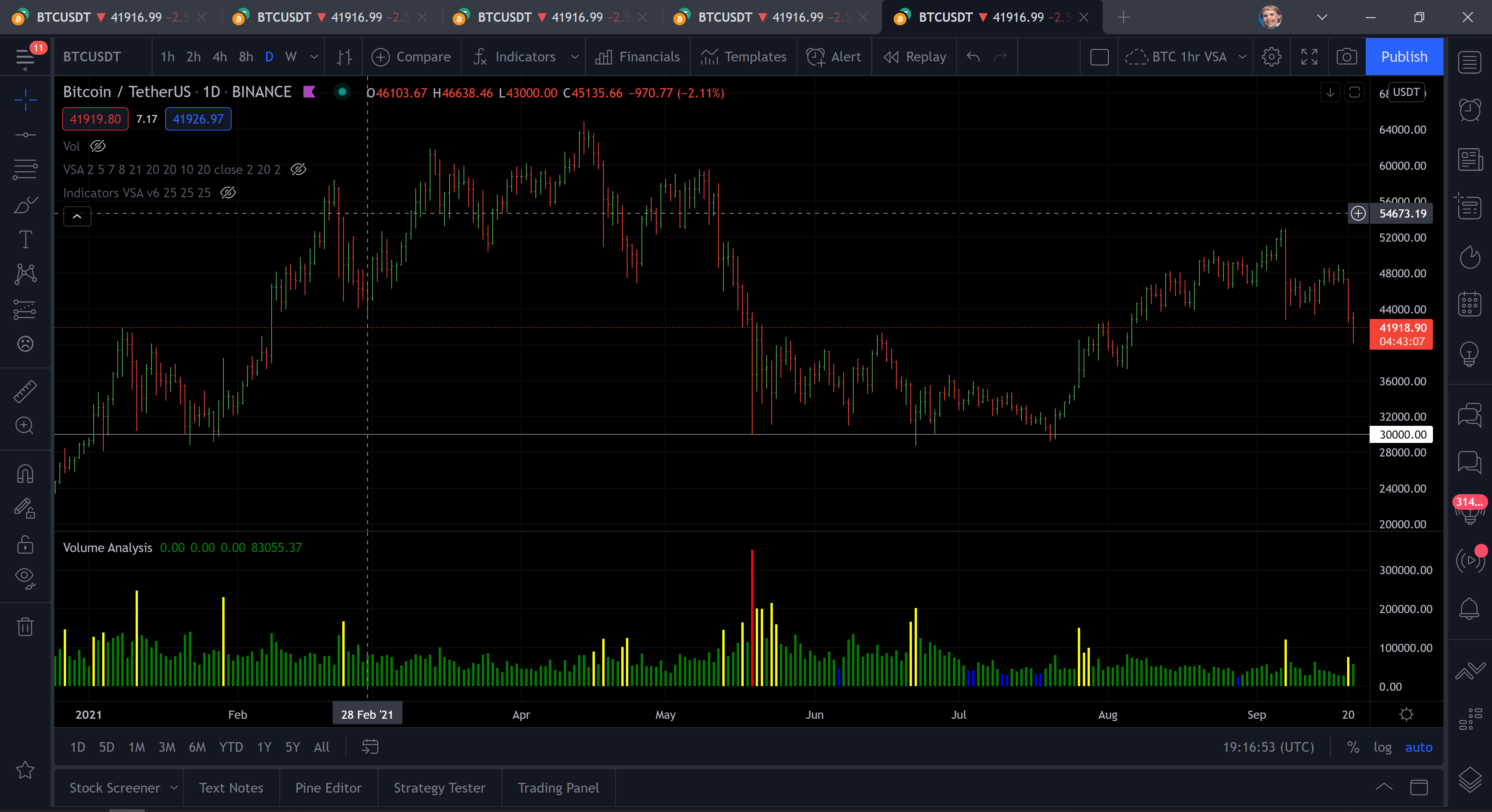

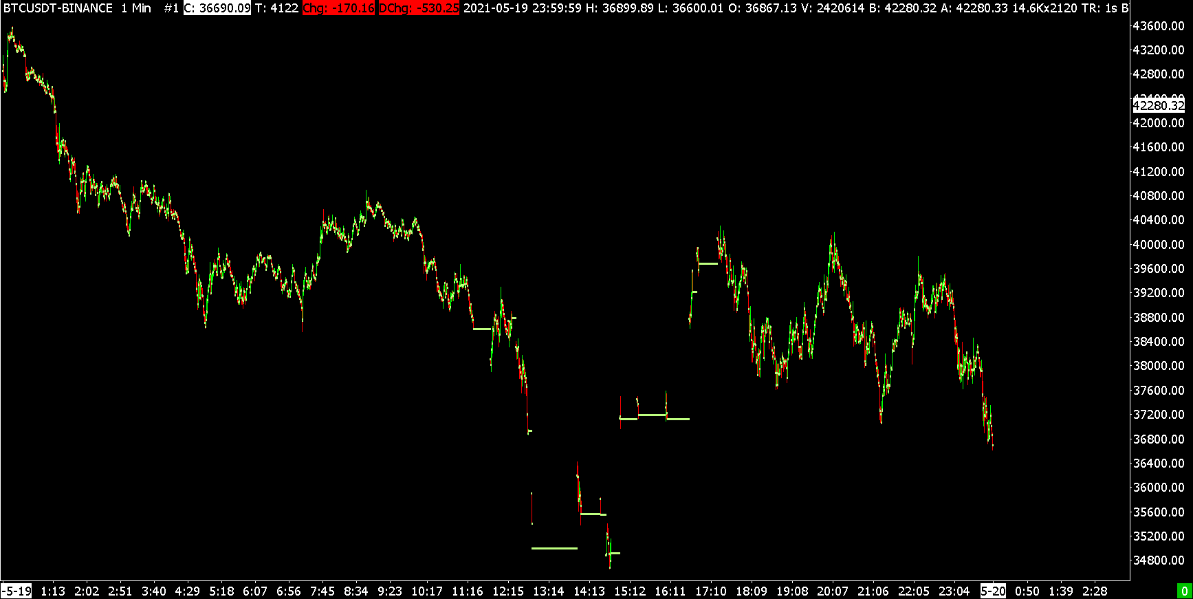

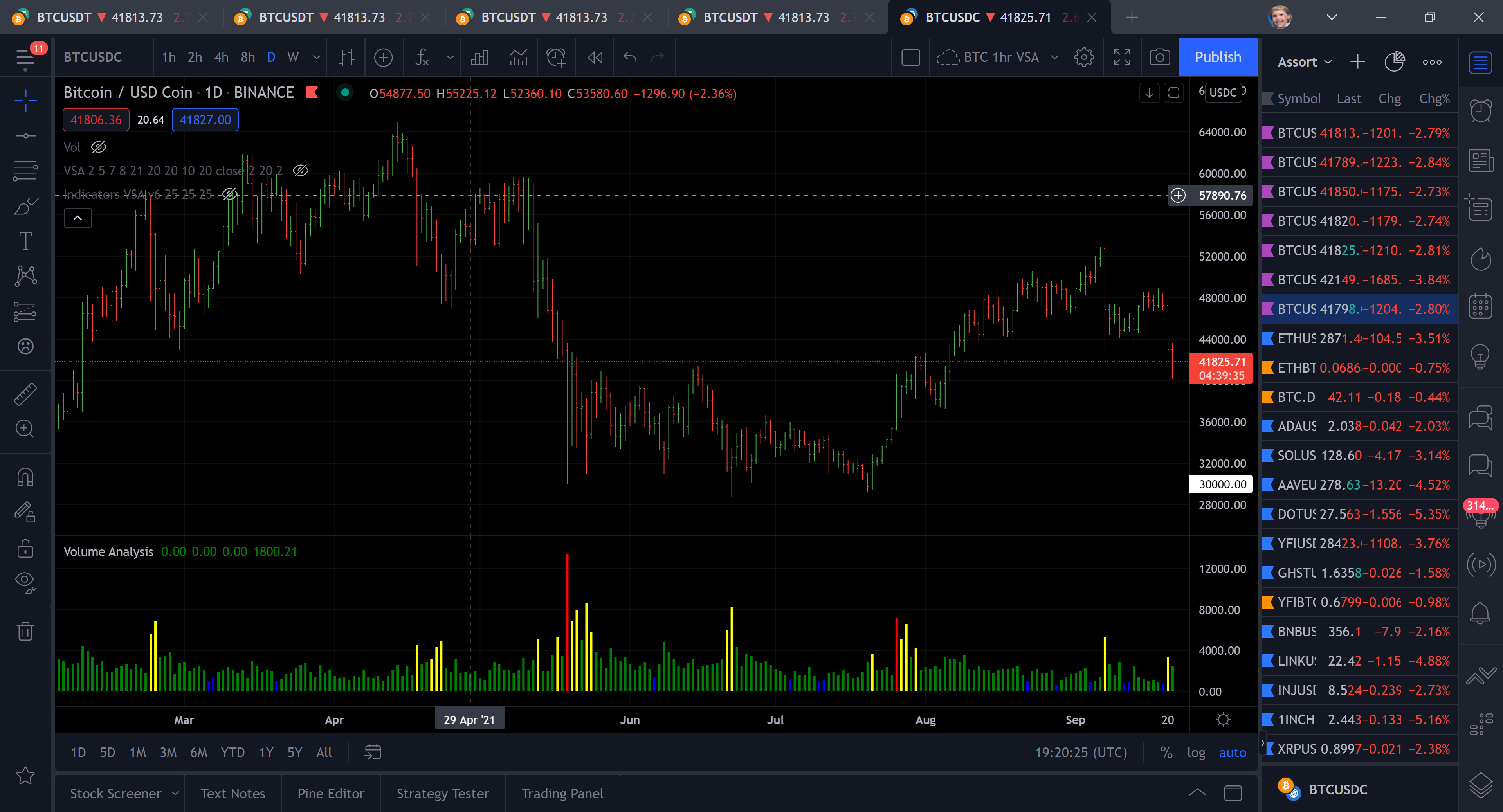

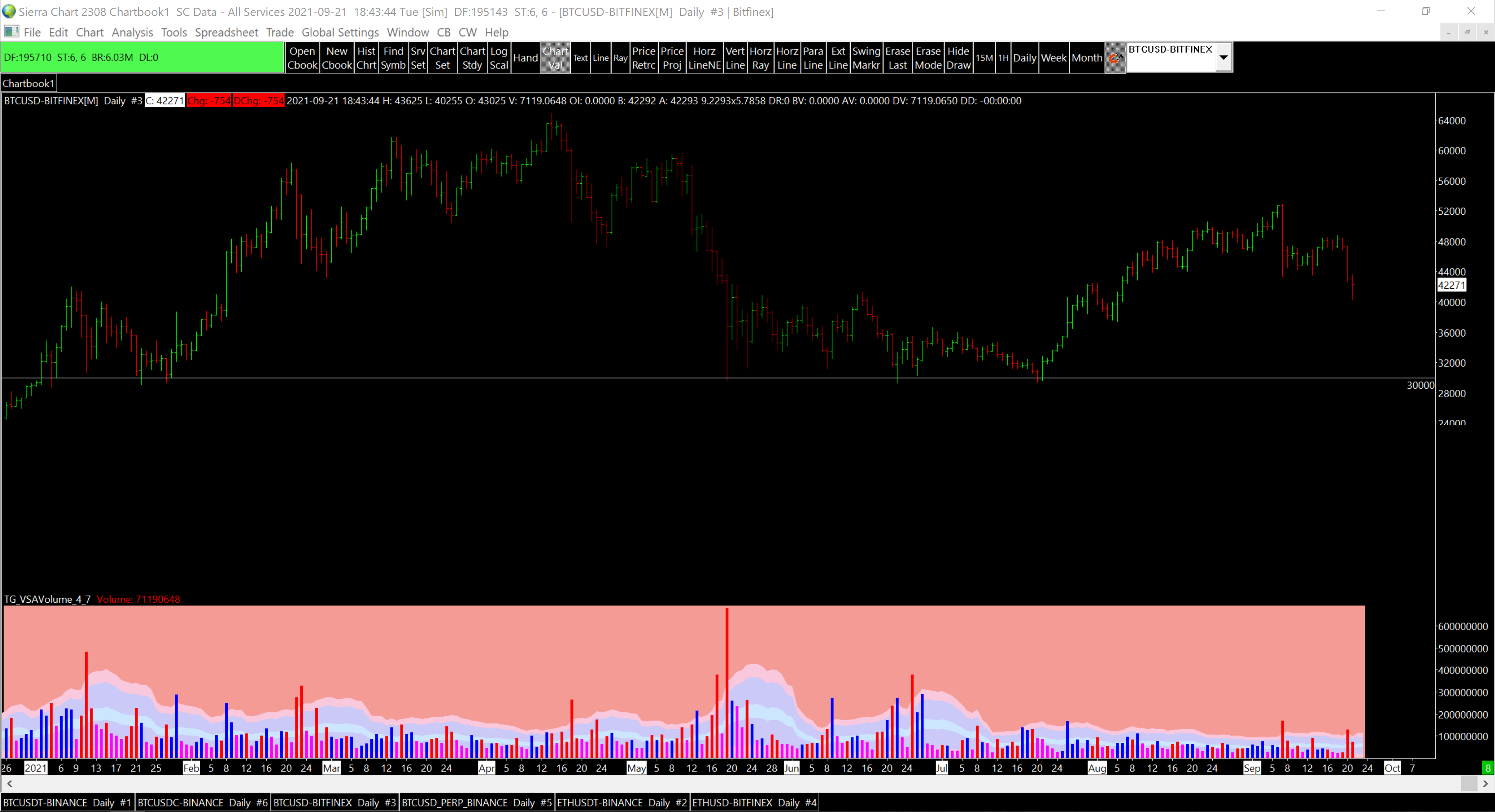

The price data from Binance on Sierra Charts is inaccurate, thousands of dollars off at times. This is in comparison to the data from Bitfinex on Sierra Charts (which is accurate) as well as the data from the exact same pairing & exchange (e.g., BTC/USDT Binance) on other platforms like TradingView. Even the data from Ninjatrader from Coinbase (BTCUSD) is a more accurate representation of general price action on all exchanges.
I have attached the most relevant screenshots to this post on different platforms that addresses this issue (I have more screenshots but that unfortunately exceeds the data limit allowed for posting). The most noteworthy discrepancy is on the major down bar on May 19th 2021. On pretty well every exchange it hit a low of 30k USD (on Binance, it hit 30k USD exactly). Yet, in Sierra Charts it says BTC/USDT hit a low of $34,682 on Binance which just isn't true. Same thing with BTC/USDC on Sierra charts, it says the low on May 19th was $34,785 on Binance. Again, not accurate.

imageSierra Daily BTCUSDT Binance.png / V - Attached On 2021-09-21 19:53:23 UTC - Size: 556.08 KB - 537 views
imageSierra Daily BTCUSD Bitfinex.png / V - Attached On 2021-09-21 19:54:16 UTC - Size: 542.48 KB - 512 views
imageTradingView Daily BTCUSDT Binance.png / V - Attached On 2021-09-21 19:55:22 UTC - Size: 405.07 KB - 479 views

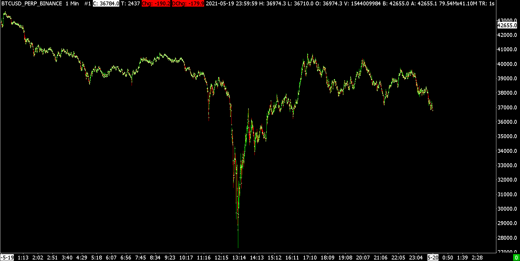

http://www.sierrachart.com/image.php?Image=1632259693803.png
The data simply could not be inaccurate. This is a claim that has no basis in fact or reality, or is even possible. Simply impossible. How can that possibly be true?

My apologies but I'm not too sure what else to say... I presented you with objective data in the form of comparative screenshots so how you can say it "has no basis in fact or reality" is odd.
I am very familiar with Binance and the instrument you mentioned with the link you provided (Bitcoin/TetherUS Perpetual Futures) is not what I am interested in at all.

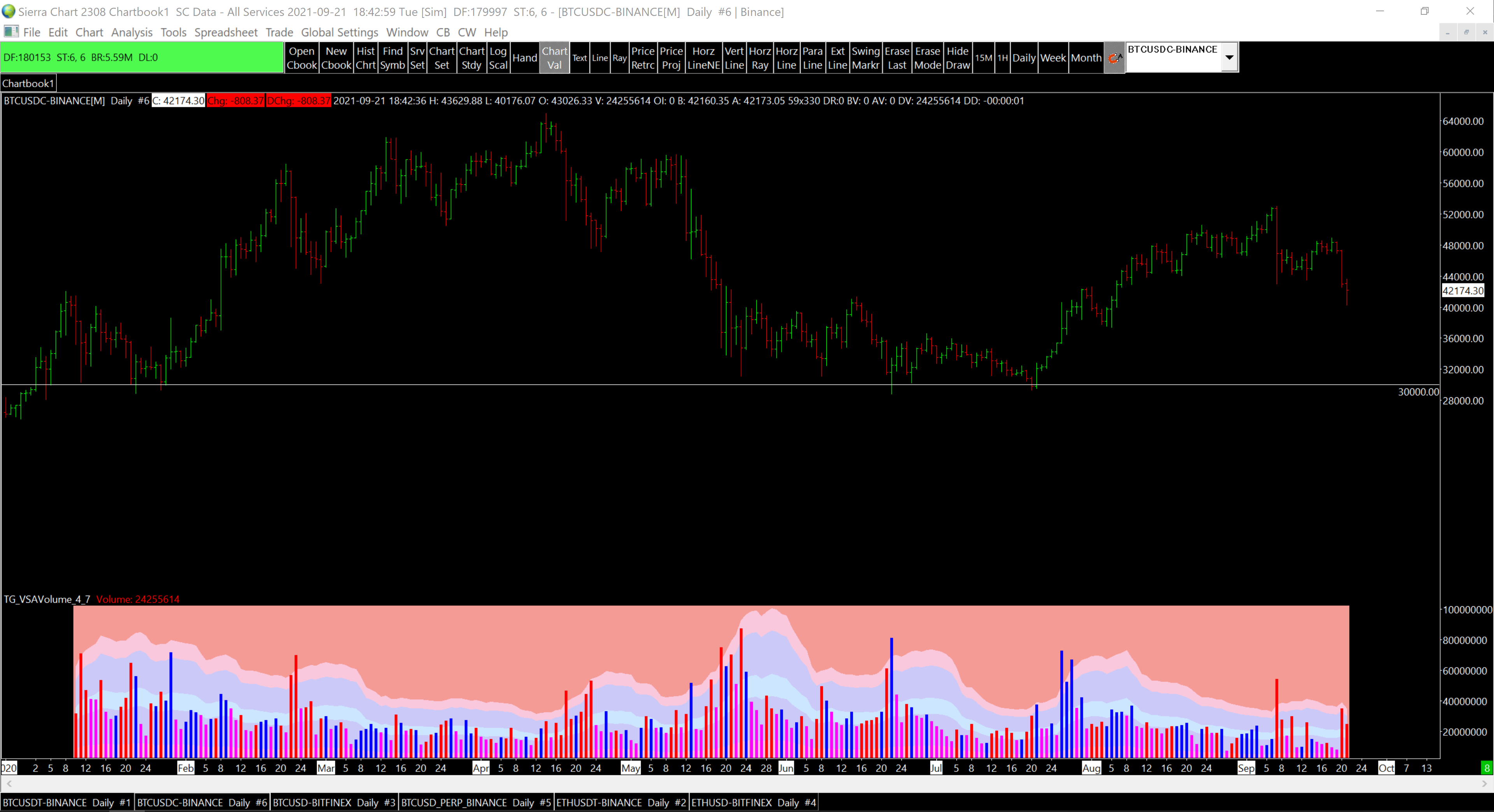

I will attach more screenshots to illustrate this issue further as it is not just in the #1 main BTC pairing on Binance (BTC/USDT) that shows this issue (as I have demonstrated in the screenshots above). I have attached screenshots of the second most popular BTC pairing, BTC/USDC, in both Sierra & TradingView. Again, notice the major discrepancy on the low on May 19th. I would also like to add that Binance uses TradingView directly on their trading dashboard so you can rest assured it is accurate.
imageSierra Daily BTCUSDC Binance.png / V - Attached On 2021-09-22 03:57:47 UTC - Size: 554.92 KB - 389 views
imageTradingView Daily BTCUSDC Binance.png / V - Attached On 2021-09-22 03:58:00 UTC - Size: 645.03 KB - 657 views

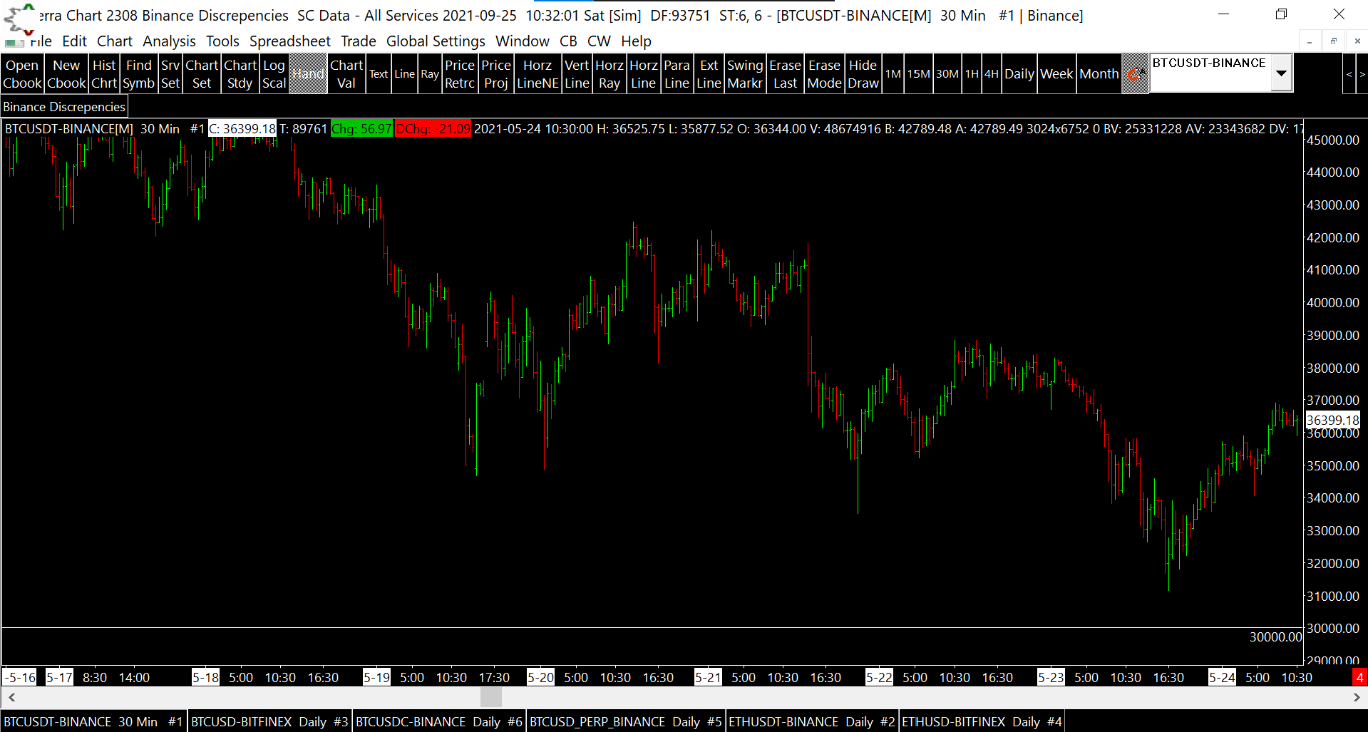

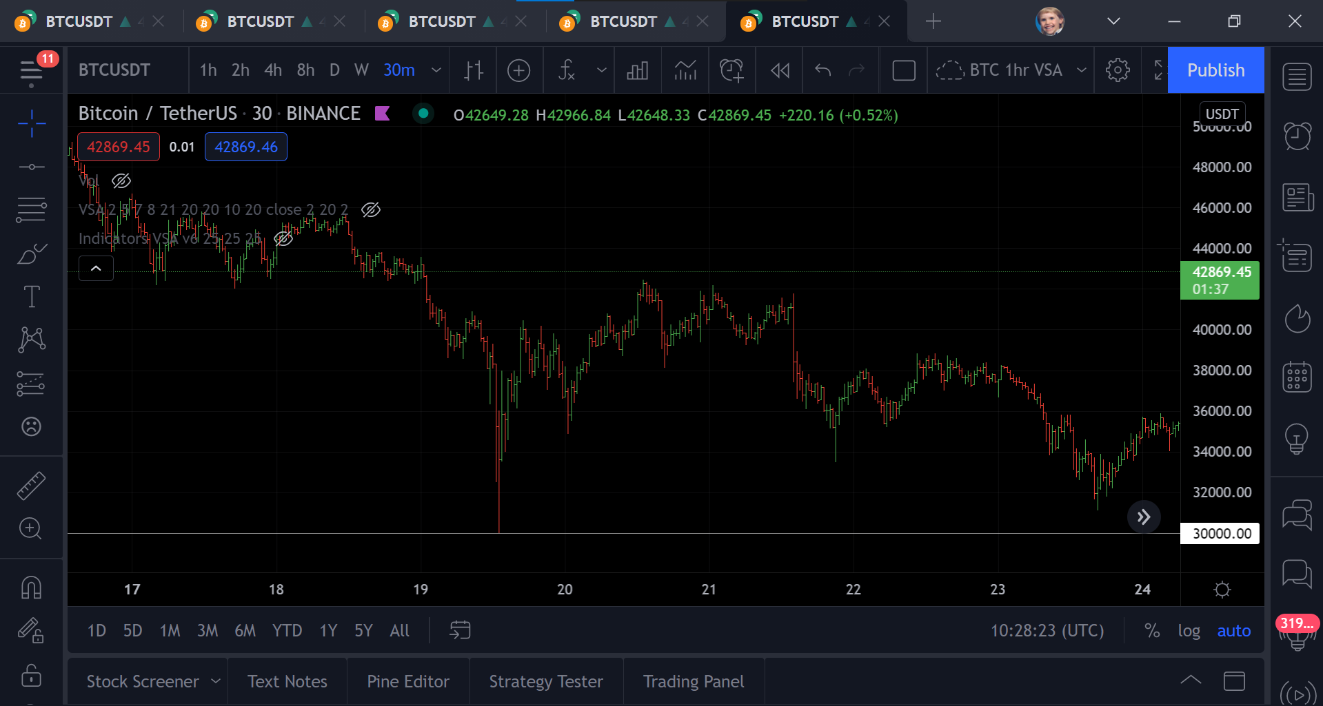

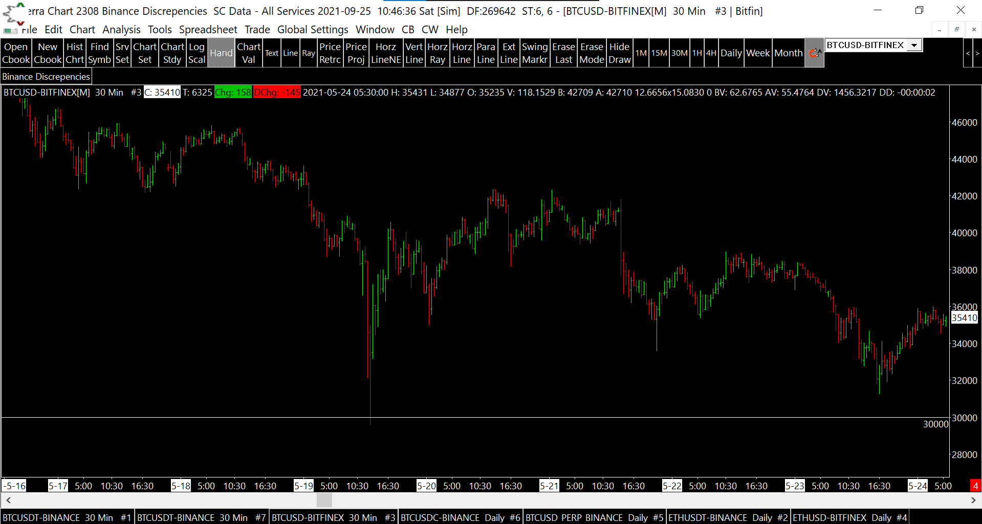

I have attached the Binance BTC/USDT 30min intraday chart from both Sierra & TradingView and the discrepancy still exists to the same extent. I have also attached the Bitfinex BTC/USD 30min intraday chart from Sierra as oddly enough it seems to be spot on, hitting that 30k low.
All charts are from May 17th-24th.
Thanks,
imageSierra Binance 30min.png / V - Attached On 2021-09-25 10:45:14 UTC - Size: 78.38 KB - 456 views
imageTrading View Binance 30min.png / V - Attached On 2021-09-25 10:45:21 UTC - Size: 217.49 KB - 435 views
imageSierra Bitfinex 30min.png / V - Attached On 2021-09-25 10:47:08 UTC - Size: 74.98 KB - 415 views

For that particular symbol, there was various periods of lost connectivity on that date as you can see here:
http://www.sierrachart.com/image.php?Image=1632579609450.png
The dashed lines indicate missed data at times that Sierra Chart was getting disconnected from Binance because Binance was closing the connection.
There was connectivity problems because of a problem on the Binance side with that particular category of their data feeds.
And that lost connectivity was occurring for both of our servers. And it was not happening with other Binance connections at the same time. There are multiple connections. For example, the ones with the perpetual contracts, did not have this data loss:
http://www.sierrachart.com/image.php?Image=1632591112435.png
So this is because of a poor quality service from Binance. These services are substandard as is always been obvious for years. Binance is substandard, with market data delivery. That has always been clear from the very beginning. It is a sloppy and unreliable service. There are a lot of lost connections to Binance. It really is a mess.
