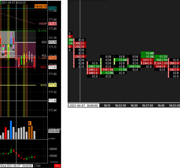

I have one more question.
Please find attached another screenshot, both charts are 7.30 minut:
1) First is a bar chart and it includes the Large Volume Trade Indicator set to show dots for trades above 249. The dots are visible before the crosshair (16:00) but not after.
2) Second is are numbers bars filtered in the Chart Settings to exclude trades less than 249. The crosshair is at the same spot there (16:00).
As you can see, eventhough there are filtered trades on the numbers bars chart, the dots are not showing on the bar chart. That was the time when I closed Sierra Chart. Could you please have a look at the reason why it is that when Sierra Chart is closed and then opened, the Large Volume Trade Indicator does not show the dots despite the large trades that were there?
Thank you.
Kind regards,
Hana
imagemissing dots.png / V - Attached On 2021-04-15 18:00:37 UTC - Size: 36.08 KB - 489 views

With regards to the inconsistent Large Volume Trade Indicator dots, we only found one small issue, which was that your filtering for the Numbers Bars chart is set to 249, but the filtering is doing a "less than or equal to" filtering, so that should be set to 248 in order to get the same data as the Large Volume Trade Indicator set to 249.
But, that just changed 1 dot that we could see.
Once we changed that item, everything matched exactly between the two charts. The only thing we can think is that perhaps the dots are hidden by another study on that chart. Make the size of the dots much larger to ensure that you are seeing them. We also set the Chart Draw Type to Blank in order to remove the candlesticks to be able to better see the dots.

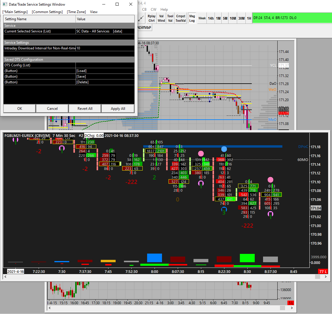

The more interesting thing is that the data is very different from the image that you show. We see only a few trades that make it through the filtering in the Numbers Bars. What is your Intraday Data Storage Time Unit set to? Refer to the following:
Data/Trade Service Settings: Intraday Data Storage Time Unit (Global Settings >> Data/Trade Service Settings >> Common Settings >> Common Settings)
Make sure this is set to 1 tick, especially since you are looking at the Numbers Bars.

With regards to the missing dots, the issue only appears when I close Sierra Chart and open after some time. The dots do not display for the period that Sierra Chart was closed. I.e. the dots are not there if Sierra Chart was not running. So you cannot see it if you do not try to have it opened on your end during periods of normal trading (in FGBL) - which is not now (we are nearing the close and there are not larger trades).
Yes, my intraday data storage time unit is set to 1 tick.

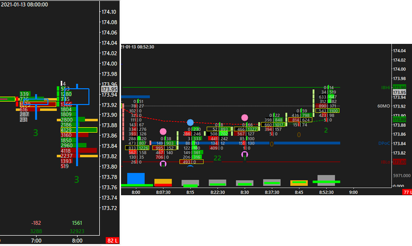

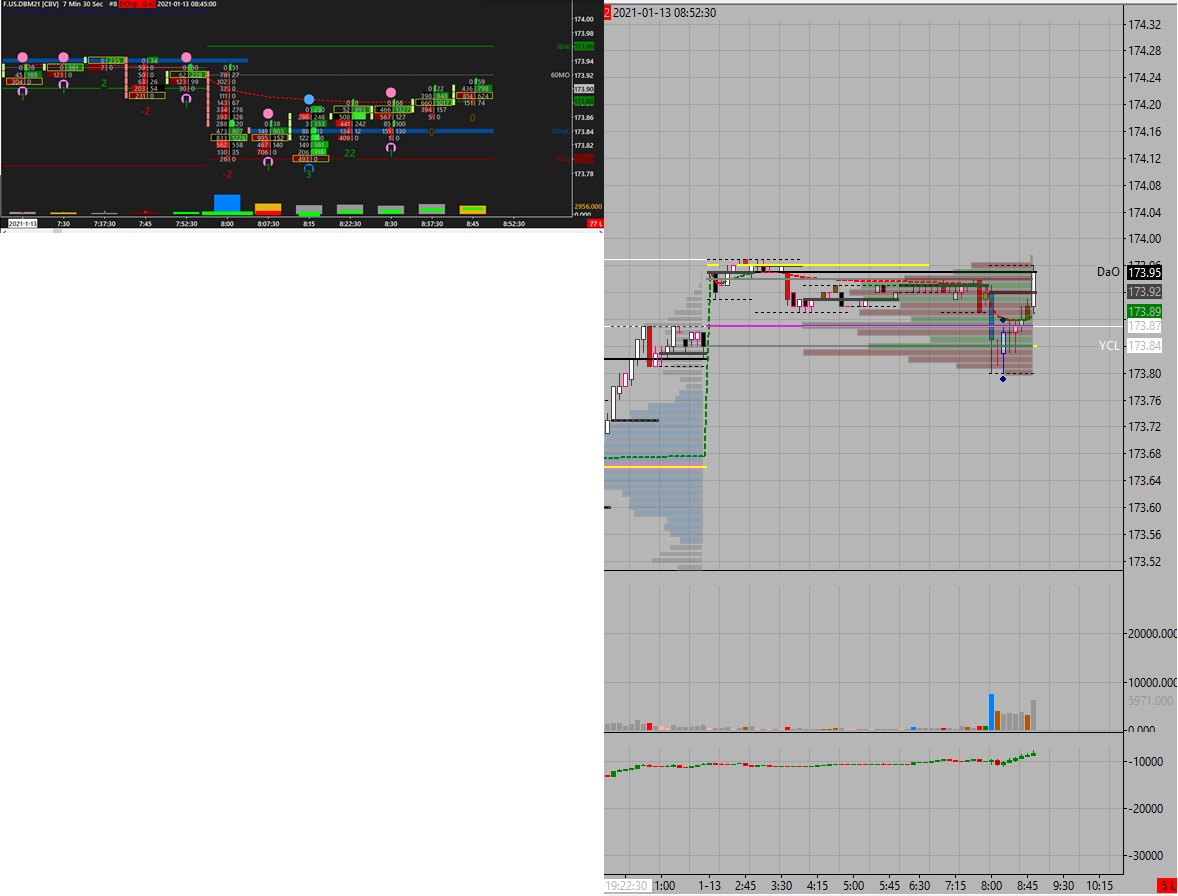

To illustrate my point, I am attaching a screenshot of January 13, 2021 (same as the very first screenshot in this thread) as well as a chartbook with a 7.5 min bar chart with a custom developing VP I write about below:
If you scroll to January 13, 2021 in the chart in the chartbook (which in the screenshot is the chart on the right), you see a custom (developing) volume profile for the given day from its overnight open (i.e. from 1:15 CET) to the end of the 60 min candle that starts at the European open (8:00). As you can see, the developing volume profile on the candle chart from the very open on that day shows POC at 173,87 (crosshair white line, pink line in the developing volume profile).
On the contrary, the developing POC on the numbers bar chart shows developing POC at 17384.
Those two POCs are inconsistent even though they are both developing from the very open at 1:15.
Why is that so?
Thank you.

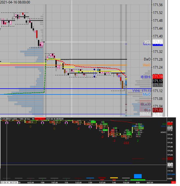

I am also attaching the most actual screenshot from todays European morning. Simple counting is sufficient here:
The top chart is the 7.5M bar chart so that you can see how the chart developed from the start at 1:15 AM CET and that before I started to count, nothing traded at the mentioned prices.
The bottom chart is 7.5 numbers bars that include unfiltered volume numbers. The blue DPoC (developing POC from the VbP study) is marked at 171.18 that consists of volume from 7:37:30 and 8:00 as this price level traded only during those two bars. The total number traded is 437+37+604+847=1961.
However if you just look at one price below, i.e. at 171.17, the total volume is 264+4+41+1838+2100=3792 which is more than twice the volume traded just one price level above. Despite that, 171.18 is marked as DPoC.
Thank you.
REgards,
Hana
imagedevPOC.png / V - Attached On 2021-04-16 19:48:58 UTC - Size: 77.13 KB - 464 views
