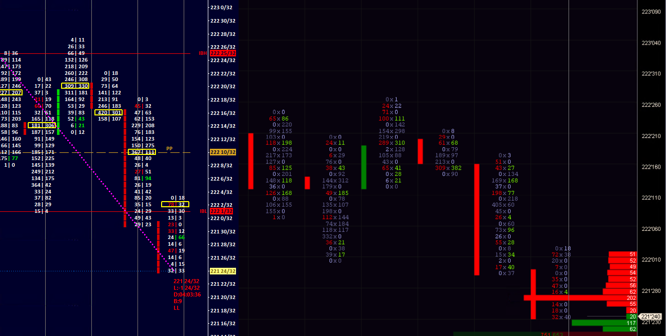

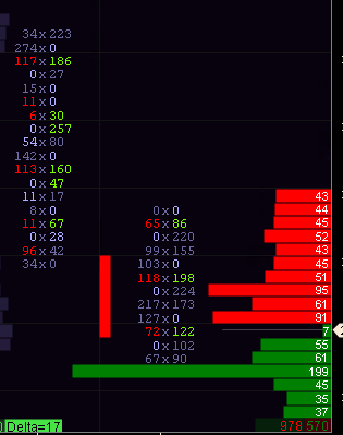

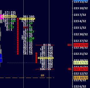

I have 2 versions of the same chart up - 30 min UB footprint / number bars... sierra and footpint in ATAS
they are delta imbalance with 300%
the problem is that they don't agree with each other. not even close. I realize that the numbers wouldn't be exact but this ATAS footprint has a lot of 0s on the bid and ask, and since it is a strong move down I suspect that is the correct one. Sierra doesn't have any 0s, nor any imbalances.
Could someone tell me what settings I might need to tweak to get them to (roughly) agree? at the least there should be some imbaalances showing up on both charts in my estimation.

another comparison
note: both platforms start the bars at the same time.. it's not due to different time stamps at the start of bars, those match

You are using Interactive Brokers and we have fully terminated all technical support related to that garbage.
We have repeatedly told you to use the Denali Exchange Data Feed but you continue to ignore us. We have no idea why you are posting.

I do not have and have never used Interactive Brokers, I don't even have an account with them... both feeds are not aggregated. One is gain, one is rithmic. I understand that the connection with TT is better but if you search the messages you will see that I did try to get TT but it was not available for the broker I had before and I was not able to find another broker with TT support. It is only supported by a couple of clearing firms. It is just not possible for everyone to get on TT... TT is not well supported by the brokers.
Please tell me at least which is the correct one? I think the gain one (ATAS) is probably the correct one, right? because the Rithmic/Sierra Chart one has no zeros.
