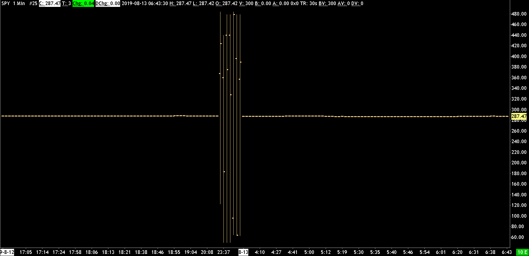

The SC data feed is showing junk data for several ETFs (SPY, SH, UPRO, SPXU) from last night.
There's a few trades reported after the close of the extended session in the 20:00 hour, and then a lot of trades in the 20-500 dollar range in the 23:00 hour.
[2019-08-13 11:11:21]
Our data provider Barchart has been notified about this now. This is what you are referring to:
http://www.sierrachart.com/image.php?Image=1565694572380.png
We will have to see how this data can be cleaned up.

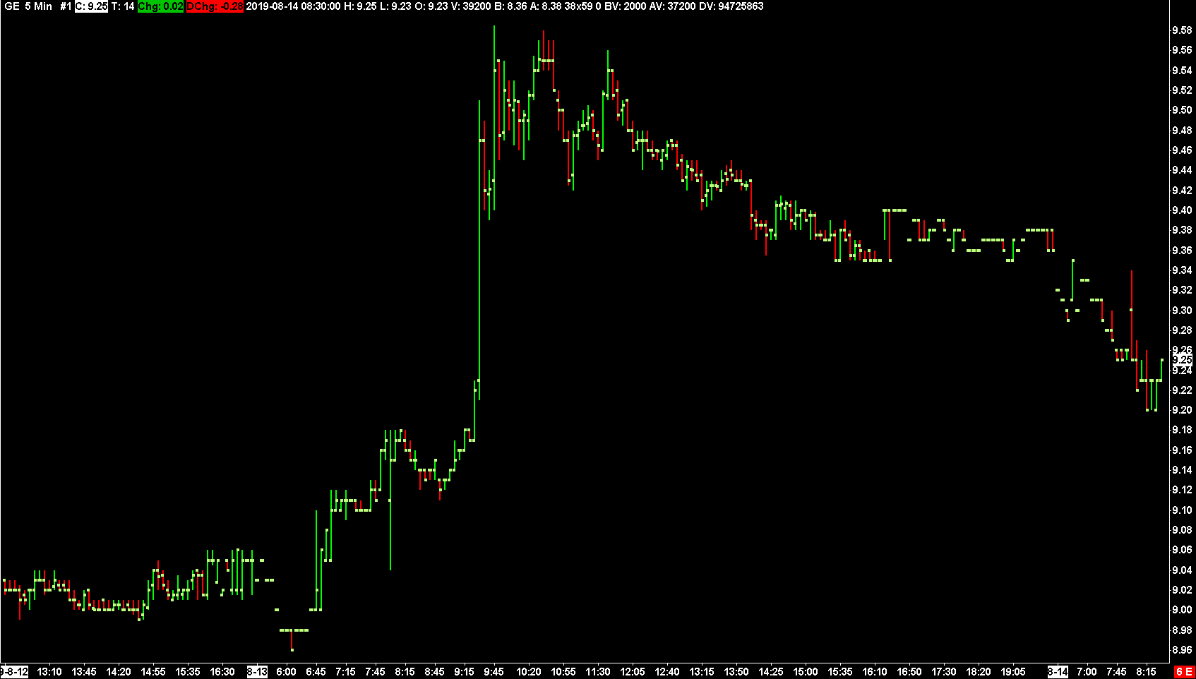

[2019-08-14 13:50:12]
User41727 - Posts: 124
I'm still seeing erroneous data. Check $GE.

[2019-08-17 00:31:15]
Im not talking about RTH, I'm talking about the faulty ETH data from 2019-08-13, the original issue for which this thread was created. I am still receiving bars that are clearly incorrect when re-downloading the historical data. And this does not only apply to GE, but also a number of other symbols.

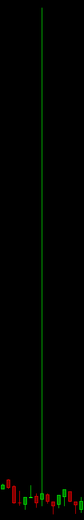

[2019-08-17 00:57:27]
User269983 - Posts: 31
I am having this issue with all stocks on my watch list. FB, NFLX, NVDA, ROKU and TSLA.
Attached is an example
Edit:
Is it possible set SC not to use the SC data to do historical backfill? I don't need to many days, I can use the backfill from my broker.
Date Time Of Last Edit: 2019-08-17 22:05:59

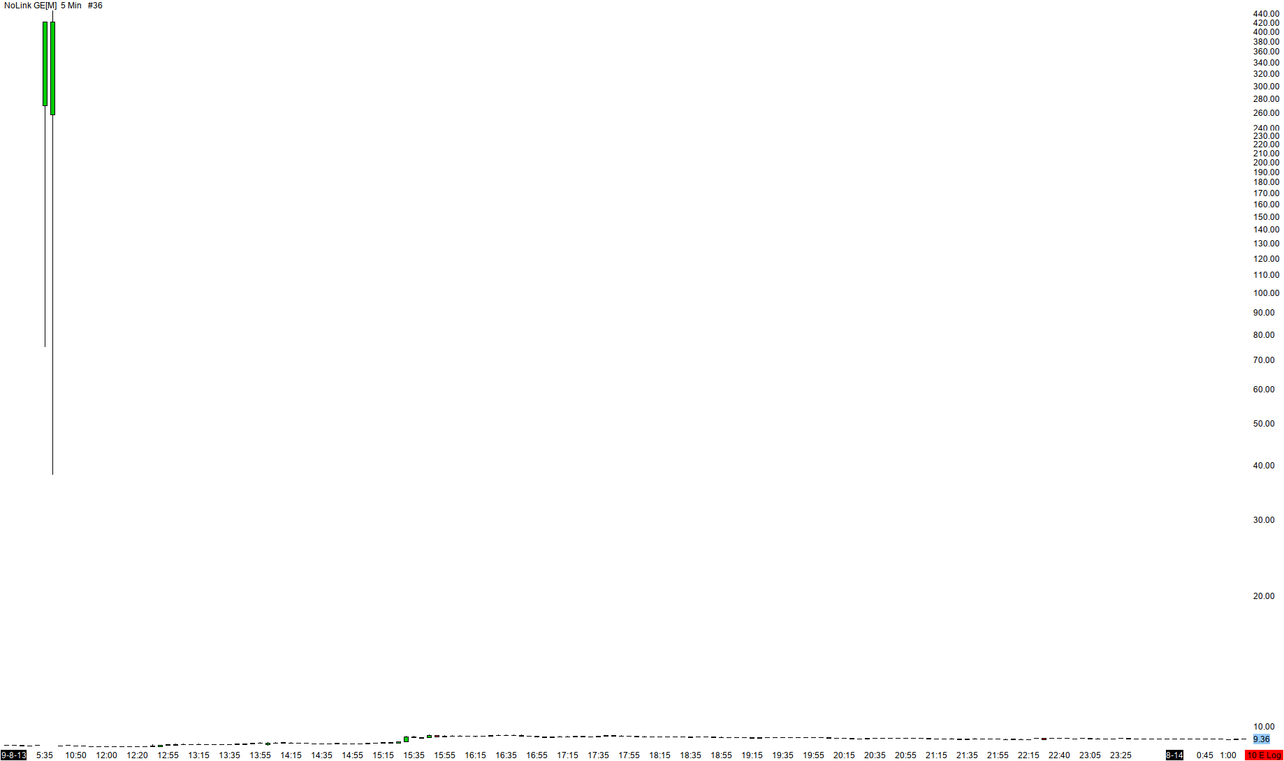

[2019-08-20 21:28:29]
Well, this is what I see. This is freshly downloaded data, and it's not the only chart that looks like this. Times are CEST.
imageGE[M] 5 Min #36 2019-08-20 23_25_43.276.png / V - Attached On 2019-08-20 21:26:45 UTC - Size: 32.21 KB - 477 views
[2019-08-20 21:40:07]
That data just does not exist on the servers and we checked both of them.
Follow the instructions below:
Fully re-download the data in the chart by going to the chart and selecting "Edit >>Delete All Data and Download".
After about a minute provide a copy of the Message Log following these instructions:
Date Time Of Last Edit: 2019-08-20 21:40:29
[2019-08-20 23:40:46]
After some testing I figured out the following: Doing "Delete and Download Data" starting with the first affected bar does not work for some reason. Instead, I had to start with a bar that belongs to the actual evening session (or earlier). Why that would be the case remains a mystery, though.
