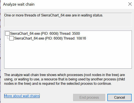

ok here we go we go - new important information available ....
it seems that for each Detached chart, the main SC Process creates a dedicated Thread (all software dev folks know the difference between Process and Thread, that's not for non-technical readers of the forum)
I have identified that there is a deadlock between the Thread of the main SC Process and the Thread of one Detached Chart - see attached the proof ....
Let me describe the full setup
SC version 1882 64 bit
Windows 10 laptop with 32 GB RAM and 6 CPU cores
SC is launched and then I open two different chart books, each with about 15 charts - that still results in only 1 Thread
Then I create 1 detached chart and that seems to spawn a new Thread - so one of the chartbooks contained such detached chart and it was for the same symbol as for some of the non-detached charts in the chart book
Then see the attached screenshot about the deadlock between the two Threads
also see here
https://docs.microsoft.com/en-us/windows/desktop/Debug/wait-chain-traversal
Also note that both Threads seem to be exhibiting some meaningful CPU utilization e.g. about 14% in total, BUT at the same time their state in Windows Task Manager is shown as "Non Responding" ....
I have been using chartbooks with gazillion of Detached charts (in fact with 100% detached charts) but so far have not encountered such deadlock
It may be due to one of the following reasons:

[2019-04-01 21:52:30]
It is not Sierra Chart creating this thread. Not at all. There simply is no separate thread for a detached chart in any way.
Also, if there is a deadlock condition going on, the CPU usage of the process will be 0.
So if you are really seeing another tthread related to a detached chart and if you think the problem is with that thread in some way, then this is going to be an issue specific to your system. We recommend trying a different system.
- Something to do with Detached and Non-Detached charts when they try to e.g. write to the same Historical Market Depth file (that study is on the charts and all charts are intraday)
Charts do not write to a market depth file.
- Something to do with the custom DTC Server developed by me and how detached and non-detached charts use data from it
There is no direct connection between a chart and the external service connection.
Date Time Of Last Edit: 2019-04-01 21:58:08
[2019-04-01 22:37:45]
User12089 - Posts: 386
let me start with the question did yiu see the screenshot and do you see there the name of sc exe and its two DEADLOCKED threads ....
is that "what I see" or what the system is telling US
also see here to interpret the screenshot
also open the Window Task Manager and under the main SC process you will see a number of child instances - definitely one for every detached chart ... that happens on both new and old SC versions - why the the Task Manager doesn't show just one record for e.g. sc.exe ...?
there is nothing wrong with the system - standard Intel and standard MS Win 10, sprinkled for taste with the MS Computer Sciences of the owner and his 20 years of industry experience as a software architect and developer (although mainly on Linux/Unix not Win)
Date Time Of Last Edit: 2019-04-01 22:39:08
[2019-04-01 22:52:22]
That screenshot you provided is not helpful to us.
What is a child instance? And if you see another thread for a detached chart, this is not from Sierra Chart. Not at all. If you do not want to believe us we cannot help with that.
There certainly is something unusual going on if you see another thread for a detached chart. Maybe Windows is doing that for a particular reason. We do not know.
The only way we can analyze this problem, is to reproduce it under our debugger and see what is happening. There is nothing you are providing here which is helpful to us at all. We are only becoming more convinced that this is an external problem which does not involve Sierra Chart.
Date Time Of Last Edit: 2019-04-01 23:34:42
