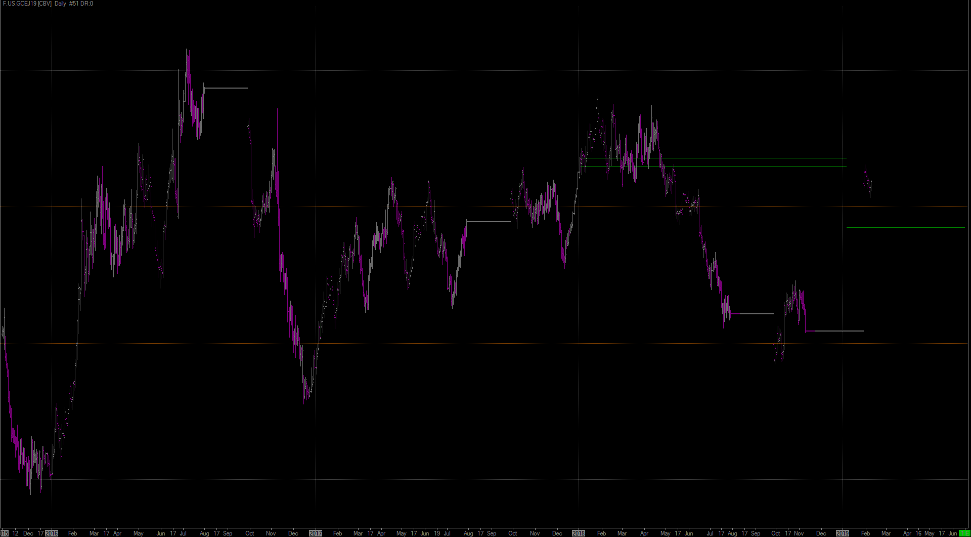

Daily/Weekly back-adjusted charts have gaps.
Intraday charts back-adjusted are fine.
non-continuous charts are fine and show all data - just the back-adjusted charts have missing data
I already did delete all contracts and re-download Daily data.
I already re-download Symbol settings.
The Issue persists.
Please advice

[2019-02-08 20:47:09]
Paul.M - Posts: 115
here

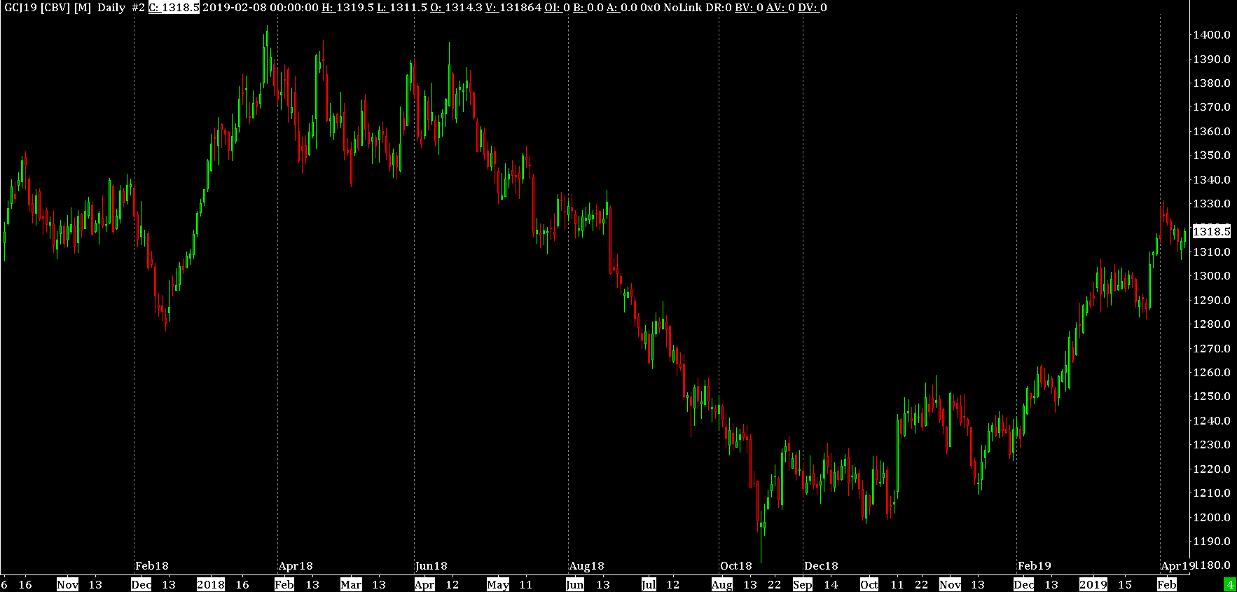

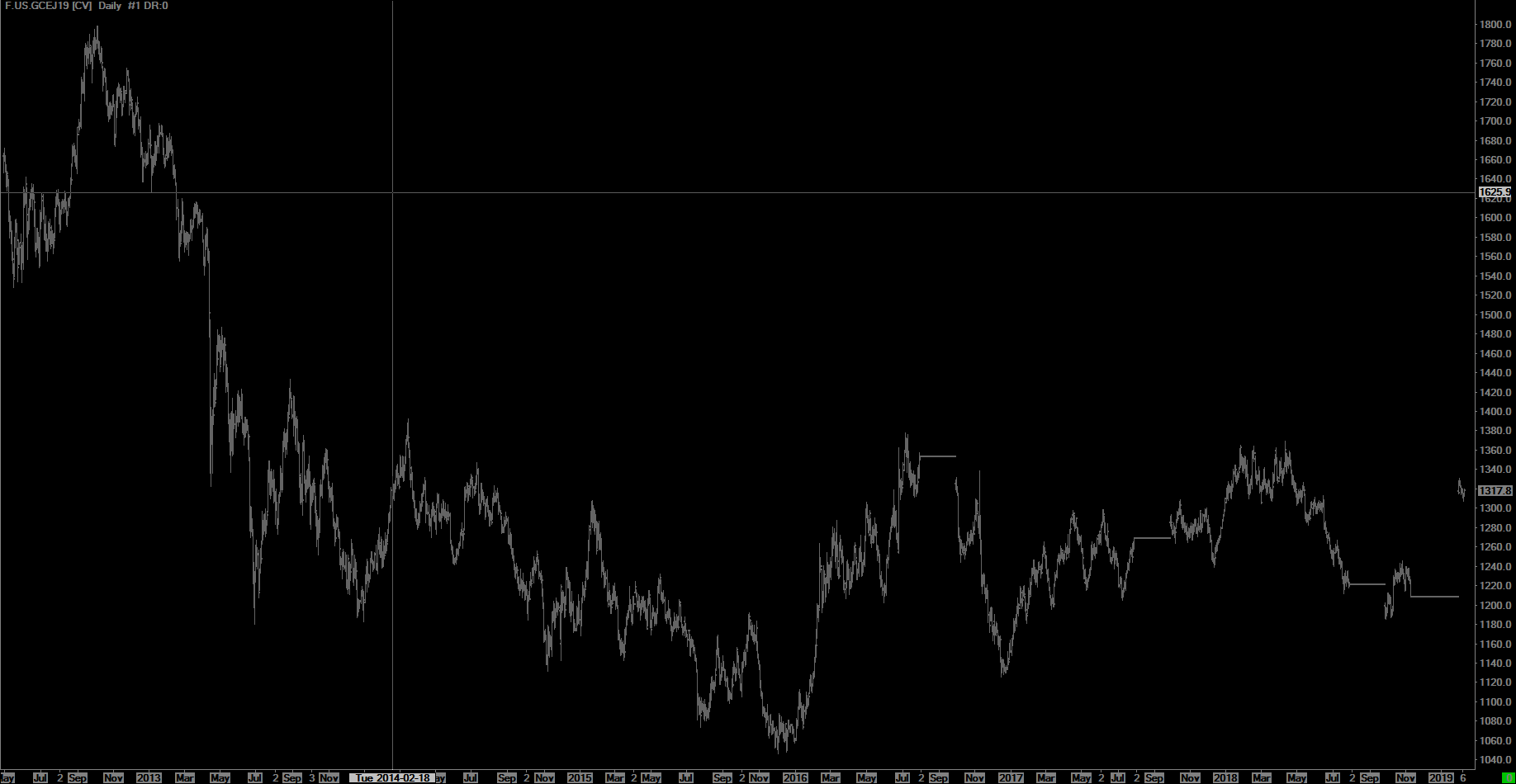

[2019-02-08 21:10:08]
Paul.M - Posts: 115
I did so - again.
no success:
http://www.sierrachart.com/image.php?Image=1549660115717.png
IS there an Issue with your data ? This Chart looks ok before 2016

[2019-02-09 21:57:35]
This is what we see also by including the V contract month:
http://www.sierrachart.com/image.php?Image=1549748983986.png
We wonder if the daily data is getting downloaded from CQG. We have seen this before and not sure why it happens. And unable to reproduce. It is also possible but unlikely you ran into a daily download limit.

[2019-02-10 10:55:17]
Paul.M - Posts: 115
... I also removed by hand the old Barchart.com Daily GCxx data from the Sierra Data folder - as well as the GQC Daily F.US.GCExxx
then again I deleted all via Edith -> Delete all Data and download
this time only on daily bar is shown of back adjusted contracts
2.
I know you have a limit for my subscription regarding downloads .
But I have old history files of futures and stocks on my PC.
It would be nice that I can display the long term history again. (for EoD and intraday 1Min data)
TY
[2019-02-10 19:57:32]
Okay the symbol settings that you have for some unknown reason are causing the historical daily data request to go to CQG mistakenly. Last time we saw this, we asked for the symbol settings file from the user and we could not reproduce so it is unknown why it is happening.
On the rare chance that a Sierra Chart update will help, update Sierra Chart and see if that resolves the problem:
After the update re-download the data again. If that does not help, then perform a Full Reset of the Symbol Settings:
https://www.sierrachart.com/index.php?page=doc/GlobalSymbolSettings.php#FullResetSymbolSettingsSteps
Date Time Of Last Edit: 2019-02-10 19:57:58
[2019-02-11 06:30:49]
Paul.M - Posts: 115
update to 1870 and FULL Reset - solved the Issue.
TY
