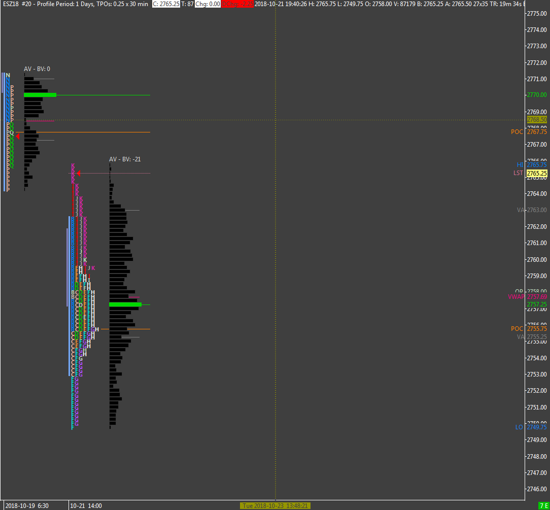

Getting a "unknown symbol" message. Looks like it is effecting SC. Should I just change the symbol to esZ18 and hope for the best?

Now it works if you change the symbol to include the 2 digit year. However, I'm not able to execute any orders through Sierra
[2018-10-22 00:07:00]
User750920 - Posts: 297
Are you saying change the symbol manually by adding a 1 - and would I have to do this for every chart manually?
[2018-10-22 00:09:50]
User244592 - Posts: 53
You will have to add in the 1 to make the year 18 for each chart but the new symbols will not backfill any data. hope they fix that!
[2018-10-22 00:10:45]
I just did that for a chart and yep no historical data. Without historical references I cannot trade.
Date Time Of Last Edit: 2018-10-22 00:11:20

This is what I tried. I entered and tried the Demo (SIM) Account credentials. When I add the 2 digit code it updates and shows all the data for this evening so far but NO historical data. It is also updating real time.
Second observation. When I leave the data set to the 1 digit code it is updating live but also the data for this evening is only as far back as when the Sierra was opened and the chart was active (when the chartbook containing charts is opened). SO at this point I have a gap in data from when I started Sierra. If you exit or close the chartbook and reopen with the 1 digit code all the data for this evening (since the change in the date code) is lost and the program starts collecting data from there. So the solution imo is (if historical data is needed at this point - which it is for me) open the chartbook and DO NOT close it or exit Sierra. I will have to see tomorrow morning if this behavior continues.
Also hoping I get no issues where Sierra or my system hangs and I have to close Sierra - then all relevant data since the change will be lost.

Historical for how far. I did the delete and download and the data goes no further back than this evening and about 1-1/2 hours further.
I have 30 days to load. http://www.sierrachart.com/image.php?Image=1540176030701.png
Also when I look at the symbols under Find Symbols the data code is still one digit.
Date Time Of Last Edit: 2018-10-22 02:48:09
Still not Working and the 2 digit date is not in the Symbol list

[2018-10-22 03:08:03]
This indicates some problem with the requesting of symbol settings. At this point we recommend performing a Full Reset instead:
https://www.sierrachart.com/index.php?page=doc/GlobalSymbolSettings.php#FullResetSymbolSettingsSteps
The two digit year symbol settings must be present in order for the historical data request to be routed properly. Otherwise, it goes to the gain capital server and you are only going to get about an hour of data. That is the problem.
Date Time Of Last Edit: 2018-10-22 03:08:55
[2018-10-22 03:08:58]
I think it is working now - It just started after I updated the symbols several times and repeated all the processes in sequence several times.. it finally took
