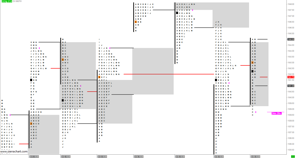

Please post an image of one of the charts, by following these steps:
https://www.sierrachart.com/index.php?l=PostingInformation.php#Image
[2013-06-13 21:17:32]
User77503 - Posts: 48
http://www.sierrachart.com/image.php?l=1371158189474.png
[2013-06-13 22:10:18]
We were expecting a chart with standard price bars and also the symbol at the top. We do not know what the symbol of the chart is..
In any case, contact IQ Feed about this.

I followed the instructions exactly as described on the link. the chart is an ES#C. are you sure this is an IQ problem?
[2013-06-14 01:10:27]
There is no doubt that there is some data problem for sure. So therefore it must be on the IQ Feed side or some sort of connectivity problem.
Open up a normal chart for that symbol and if you see the same problem contact IQ Feed. Also try once again re-downloading the data with Edit >> Delete All Data and Download.
