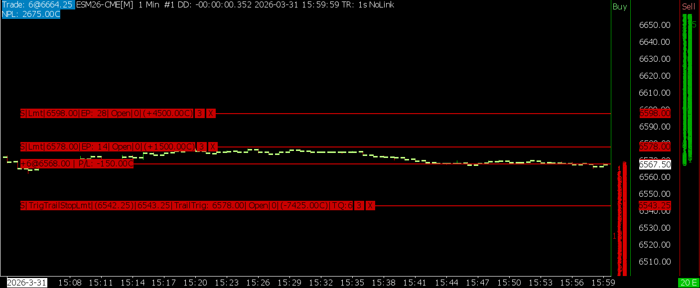

I've gone through your documentation and I'm still having trouble having success with 2 types of oco orders.
#1. for example 6 contracts. 2 targets. target 1 10pts, target 2 30pts. Stop loss is same for all contracts. Target 1 is reached and 3 are sold and 3 contracts remain and go to B/E. then trail 1pt after target 1 reached and target 2 remains.
#2. same 6 contracts stop loss for all contracts Target 1 10 pts 3 contracts off. target 2 20pts and 2 contracts off. remaining 1 contract trails 1 point after target 1 and trails 5pt after target 2 hits. last remain contract is manual exit.
Lastly, sometimes when I have simple OCO bracket with two targets, sometimes there remains open OCO order after I'm flat. I'm unable to figure why this is happening?

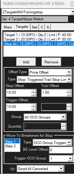

[2026-03-31 18:15:06]
Attached is an image of the setup you would use for Situation #1.
Situation #2 can not be done directly with the attached orders, as you can not have a trail of 1 point and then a trail of 5 points. A single trail of 1 or 5 can be done, and would be the same setup as we give for #1, but you would have a different quantity for Target 2.
The only way to get exactly what you want for situation #2 would be to create a custom study to control that Stop.

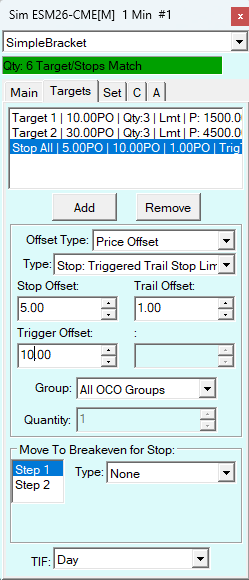

[2026-03-31 19:23:37]
User473031 - Posts: 73
I followed the image you provided with the following results. the only change I did was change the stop loss offset from 5 to 10. It created an additional oco order. After the position went flat , the oco order remained live. I have send this happened on many occasions with different configurations. Is there a setting in global settings or else where that is causing this to happen? I've provided two images for you to view.
imageScreenshot 2026-03-31 151651.png / V - Attached On 2026-03-31 19:23:21 UTC - Size: 28.3 KB - 146 views
imageScreenshot 2026-03-31 151703.png / V - Attached On 2026-03-31 19:23:27 UTC - Size: 20.36 KB - 109 views
[2026-03-31 19:33:59]
You have two Stops and a single Target. You should have 2 targets and a single Stop. The targets are standard Limit orders each with the offset you want.
Then there is a single Stop setup as we show in the image we provided. The Group for the Stop needs to be set to "All OCO Groups".
[2026-03-31 20:40:08]
you can see by the screen capture. there are two different targets and 1 stop.
imageScreenshot 2026-03-31 163833.png / V - Attached On 2026-03-31 20:39:10 UTC - Size: 25.43 KB - 164 views
[2026-03-31 21:15:06]

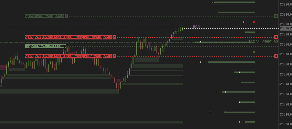

You do not need the "Move to Breakeven settings for the Stop, as the Triggered Trail Offset will move it to within 1 point of the current price once the price has gone up 10 points, which is also where the first target is located.
But that does not explain what you are seeing. It should work just fine. Attached is an image of what we get when we do this setup. We did move the Stop down a bit just to make it more obvious.
Something is not showing correctly. The Stop orders showing in the chart are "Triggered Step Trail Stop Limit". But your Trade Window shows it as a "Triggered Trail Stop Limit" (not a Step Trail). We wonder if that is the correct Trade Window for that chart.

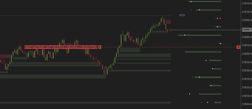

[2026-04-01 13:42:55]
It happened again. I had a series of successful trades. Then after 6th trades, i'm flat and it left trailing stop. Price came down and it didn't trigger an execution but it remained. I've attached a single image
imageScreenshot 2026-04-01 094214.png / V - Attached On 2026-04-01 13:42:32 UTC - Size: 144.27 KB - 170 views
[2026-04-01 16:41:00]
Make sure you do not have linking for the "Trade Window" between any of your charts.
You should definitely test the orders you are setting up in Simulation Mode and ensure they are working as you expect in Simulation Mode. If everything works correctly in Simulation Mode, then the issue would have to lie elsewhere. So this is the first thing to test.
Although given that you are saying that this only occurs once in every 5 or 6 trades, it does sound like it is a Rithmic issue. It is not unheard of that Rithmic is not responding properly that an order has been cancelled, therefore Sierra Chart will continue to show that order. We have no solution to this, as it is Rithmic not giving the proper information.
