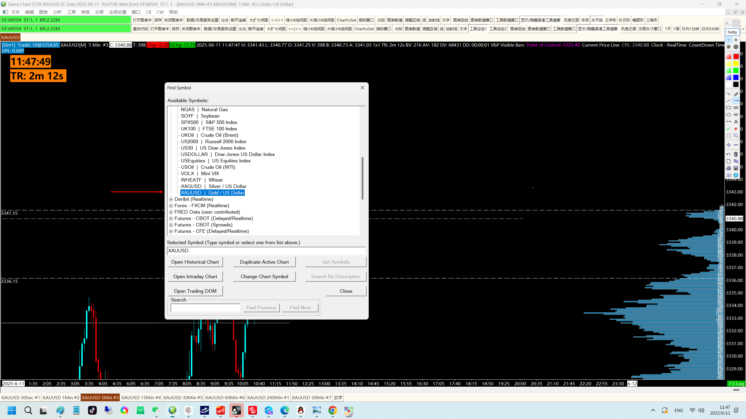

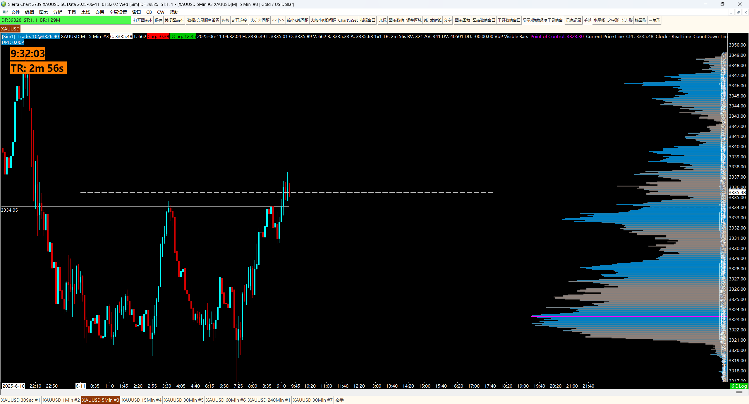

User660904 - Posts: 58
你好!我没有要求TMGM与Sierra Chart联接,我只要求用Sierra Chart来分析黄金,MT4下单,现在已经在用Sierra Chart,26美元/月等级套餐,现在只能用能量分布,显示的价格与TMGM基本上一样的,只要求提升到能看提到的Sierra Chart三个图,显示的价格和现在一样基本上同步,如果还是用原来的数据链接,只要提升套餐等级,这样要求可以达到吗?

1, for Denali Exchange Data, to get streaming data, a user still has to have a live account with a futures broker? Not sure if I understand it correctly.
2, Denali Exchange Data Feed does not have Forex and CFD data?
3, I am now able to get streaming CFD data by select "SC Data" and select symbols under "CFD -FXCM", can I also get footprint, DOM and T/S for those CFDs?
Thanks !
你好!回复:1、2我不需要开期货真实账户。3.我现在用的26美元/月,可能等级不够看不到足迹、DOM、T/S。
现在要确认看这三张图需要什购买什么等级的?原有SC Data-CFD-FXCM-XAUUSD链接还能用吗?

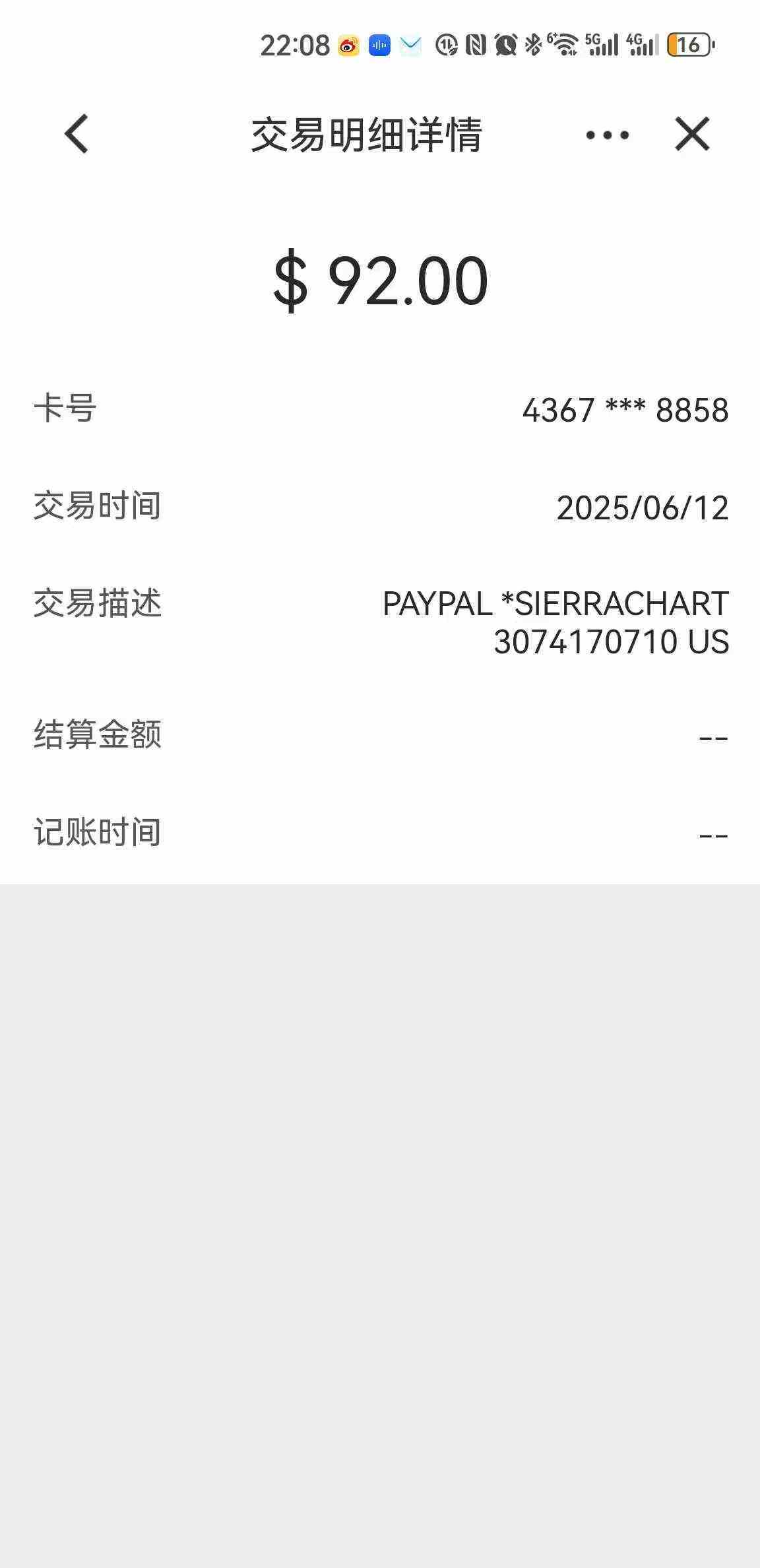

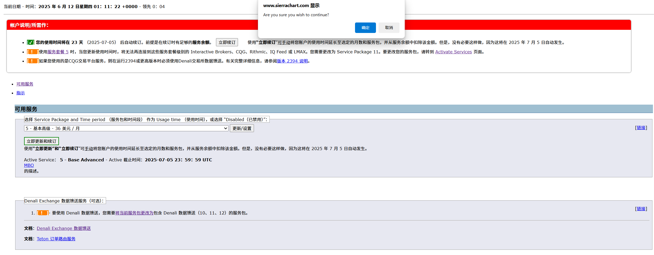

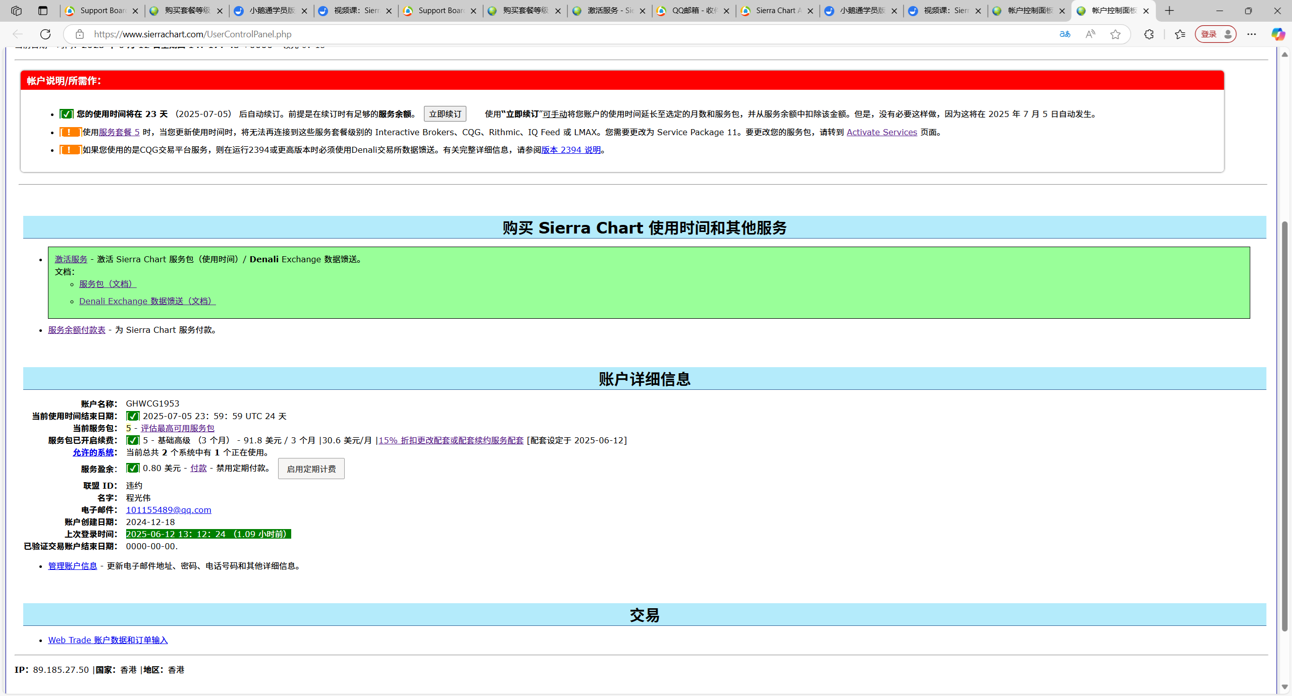

[2025-06-12 14:15:59]
你好!已付款账户没有看余额?

[2025-06-12 15:12:18]
Tony - Posts: 732
兄弟,付款询问以及其他私密问题,尽量用 Service Ticket。如果发在讨论区,不相干的人都可以看到了。
@John, the question was:
"I made the payment and attached a screenshot, I didn't see any update of my balance"
Date Time Of Last Edit: 2025-06-12 15:18:09
[2025-06-12 17:17:22]
John - SC Support - Posts: 48408
We checked our account on PayPal and the only payment showing from "wei cheng guang" is from April 11, 2025. The recent payment is not showing.
We do see an attempt was made to make a payment for $92.00 on 2025-06-12 at 13:33:29 UTC. But there is no information on why the payment did not go through.
You need to check with your bank to see if they declined the payment.
