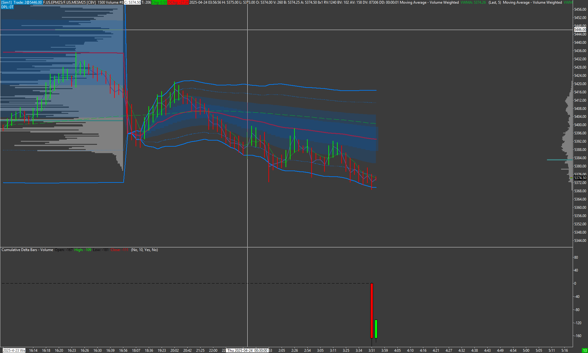

Contract data is only loading from when I open SC. Using CQG and activated Denali excahange.
Been through the support guides on this but nothing is rectifying it.
https://www.sierrachart.com/image.php?Image=1745481419362.png
Please advise.
[2025-04-24 14:44:25]
The image you provided does not show any missing data.
If you are missing data, then follow these instructions to redownload what is missing:
In general, you should not have this issue. When you open Sierra Chart, the data from when you were not connected should download. Let us know if you continue to have this issue. We would need to see an image where you have missing data in your chart.

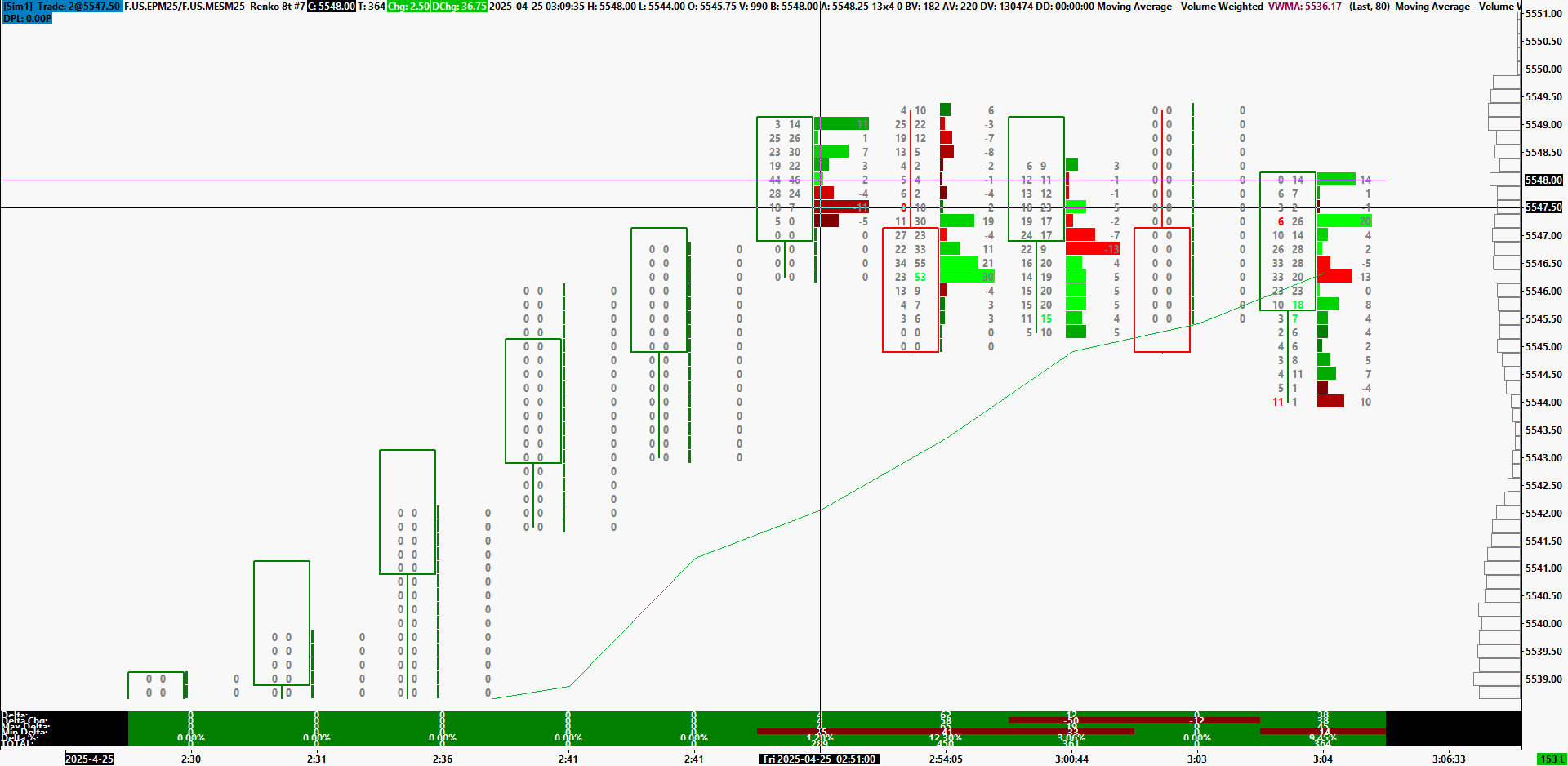

The continuous contract data is not loading
It's more obvious on a footprint chart
https://www.sierrachart.com/image.php?Image=1745564976436.png
[2025-04-25 14:13:51]
Please get us your Message Log by following these instructions:
Close all of the Chartbooks with "File >> Close All Chartbooks".
Open a single chart for the symbol you have an issue with through "File >> Find Symbol". Tell us that symbol of the chart. Tell us about *one* symbol only.
