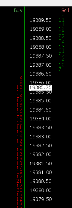

hi John so my bid column and ask column the digits are single digits but when I look at other DOM, there’s three numbers or two numbers kindly advise

John basically on YouTube I look at the Sierra chart DOM and there’s multiple numbers it’s three digits usually in the bid and the ask volume bars online. It’s only one digit it’s either 1 5 8 single digits on every level sorry my computer is getting repaired right now so I can’t do the screenshot or how you told me to do it I really hope you can figure this out because I don’t know if I should be trading that way thanks man sorry to bother you with all this stuff
imageIMG_5277.png / V - Attached On 2025-04-25 03:46:03 UTC - Size: 12.99 MB - 514 views
[2025-04-25 14:01:55]
John - SC Support - Posts: 48555
Most likely it is just due to differences in the liquidity of the particular instrument. We really need to know what symbol you are looking at so we can see for sure that we are getting the same data. Please let us know what symbol you are viewing.

Attached is the MNQ M 2025 contract DOM at this moment (around 11:20 Central US time). You should be seeing something similar, but it depends on the time of day.

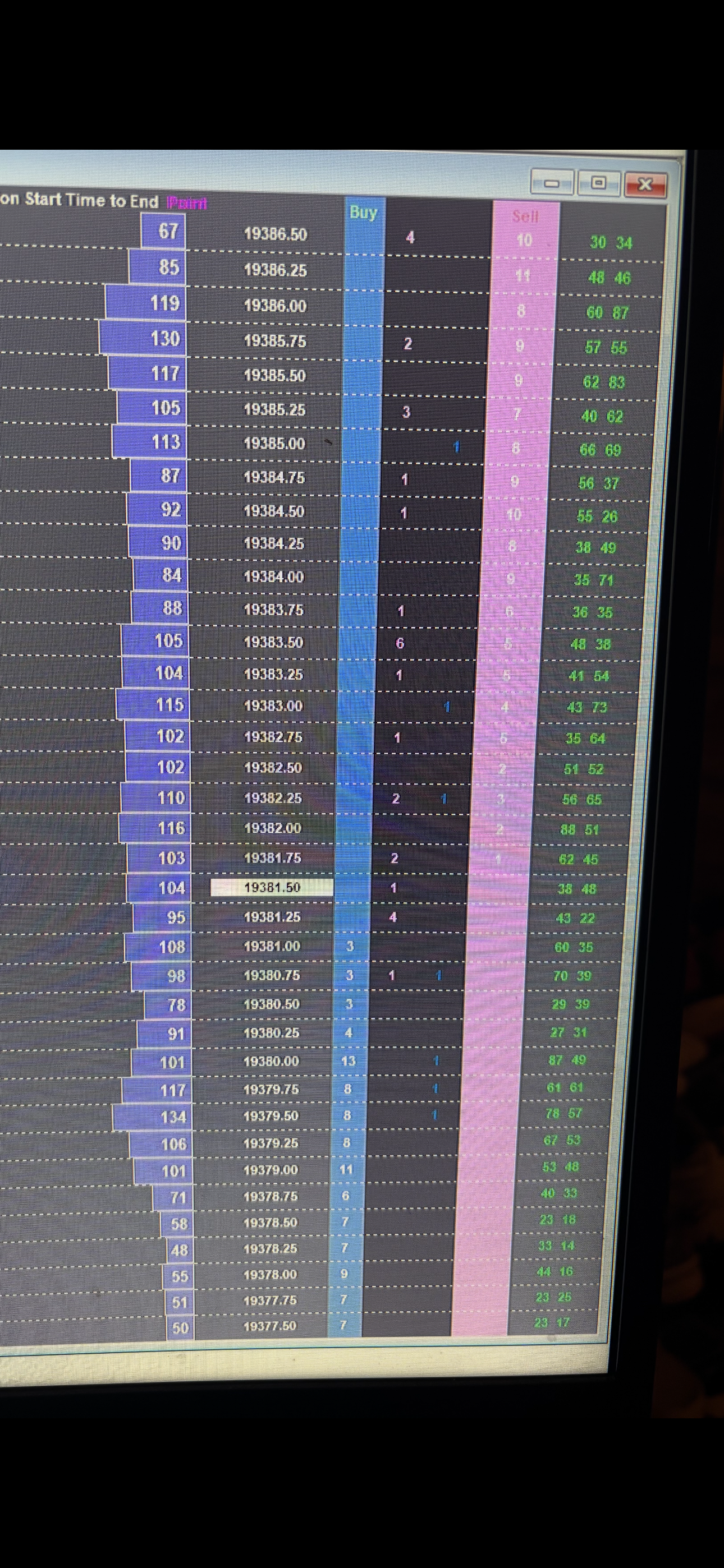

Hi John, good morning hey, can you do me a quick favor and let me know how to get rid of that black box in the DOM trade box above main targets set
Private File

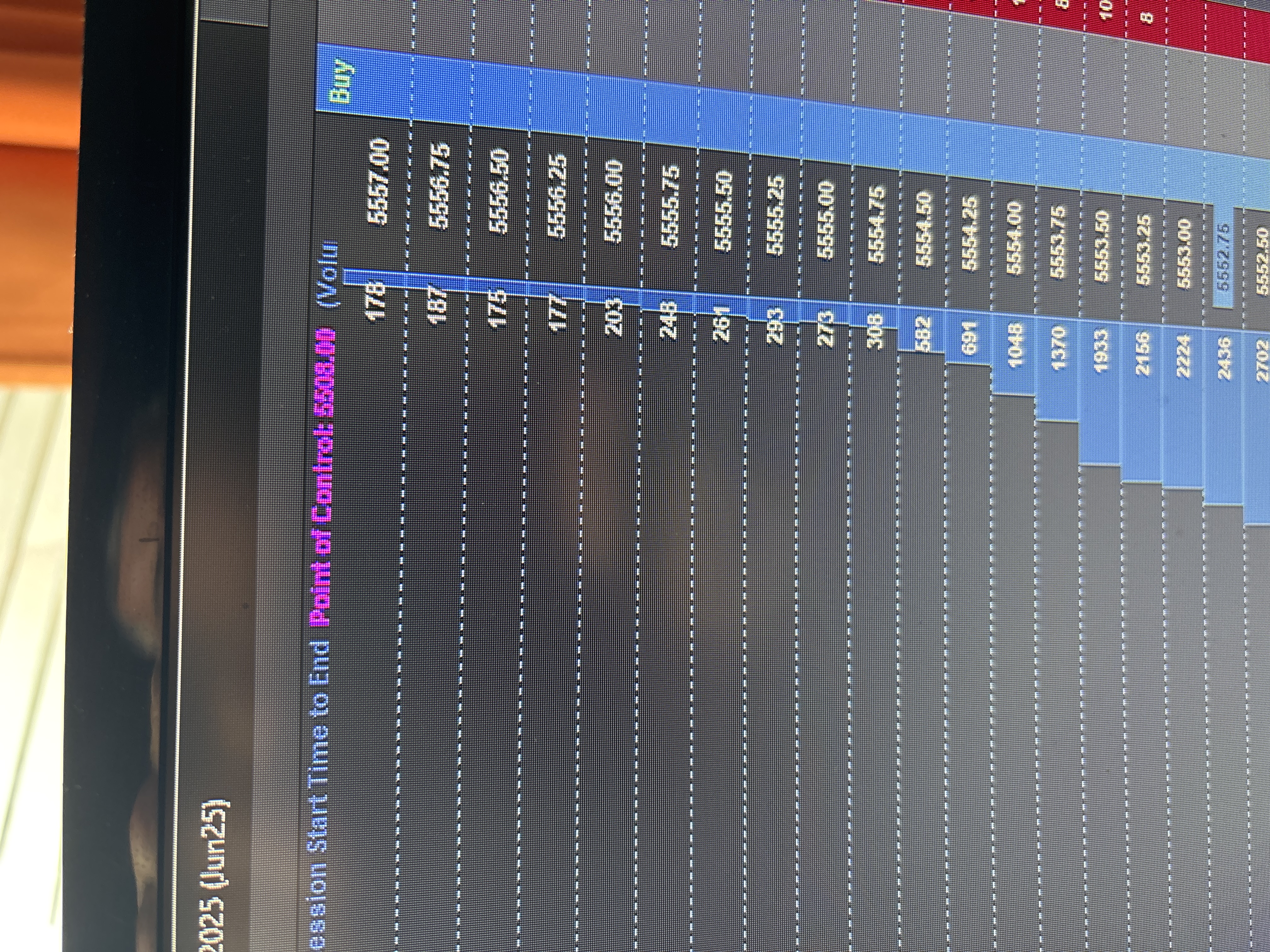

Also, how do I remove the point of control text on the top? Or change the color
imageimage.jpg / V - Attached On 2025-04-27 16:06:23 UTC - Size: 5.93 MB - 444 views
You cannot remove that. It is the Status area for whether you have quantities matching between your parent order and the attached orders.
That is displayed as part of a study. It looks like that is a Subgraph, but refer to the following that controls the display of the items for a study in the Region Header:
Chart Studies: Subgraphs Tab >> Display Name and Value in Region Data Line
Chart Studies: Subgraphs Tab >> Display Study Subgraphs Name and Value - Global
Chart Studies: Subgraphs Tab >> Display Study Name
The color of that item is going to be the color of the subgraph that it is referencing. So you can change the color of the subgraph to change the top text.
