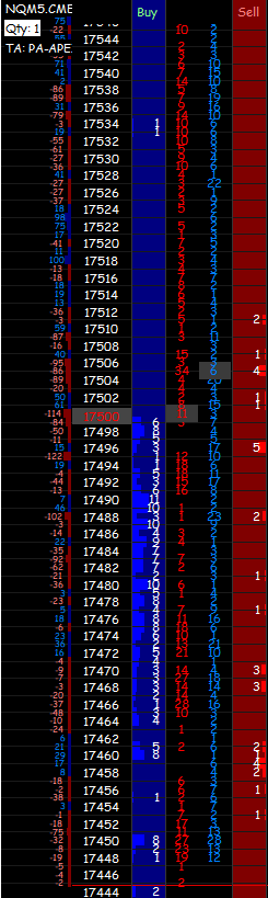

Hi, market depth on my NQ dom is not working properly. Market depth numbers, especially on ask side are not showing and re-centering the chart does not move it to current price https://www.sierrachart.com/image.php?Image=1744128626308.png |

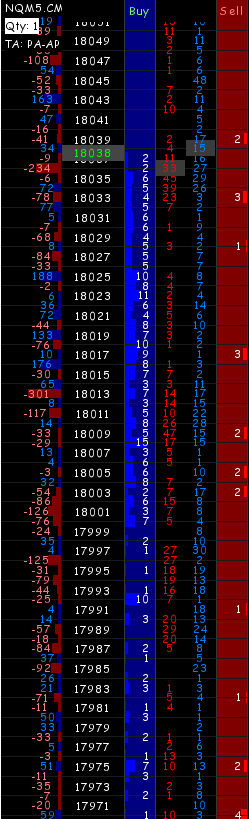

Hi, I've set scale to automatic and tried resetting and it still doesn't work https://www.sierrachart.com/image.php?Image=1744138486988.png |

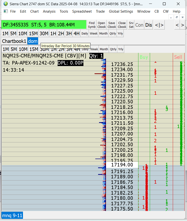

I've removed all studies and now nothing is showing on the dom https://www.sierrachart.com/image.php?Image=1744141902857.png |

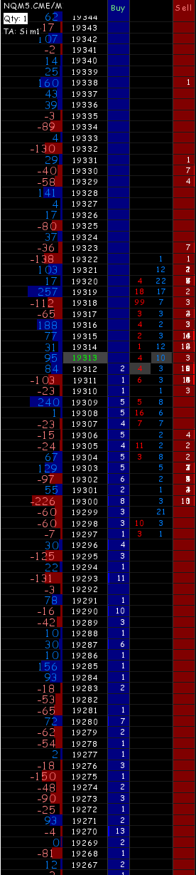

I've gone through the documentation. I'm receiving data from the market depth window. I think the issue is with the ask side of the DOM. On the screenshot below, you can see the ask side of the DOM has overlapping numbers all over, which is consistent with what I'm seeing from the market depth window. That could also explain why re-centering doesn't work properly for me either. https://www.sierrachart.com/image.php?Image=1744231552888.png |
