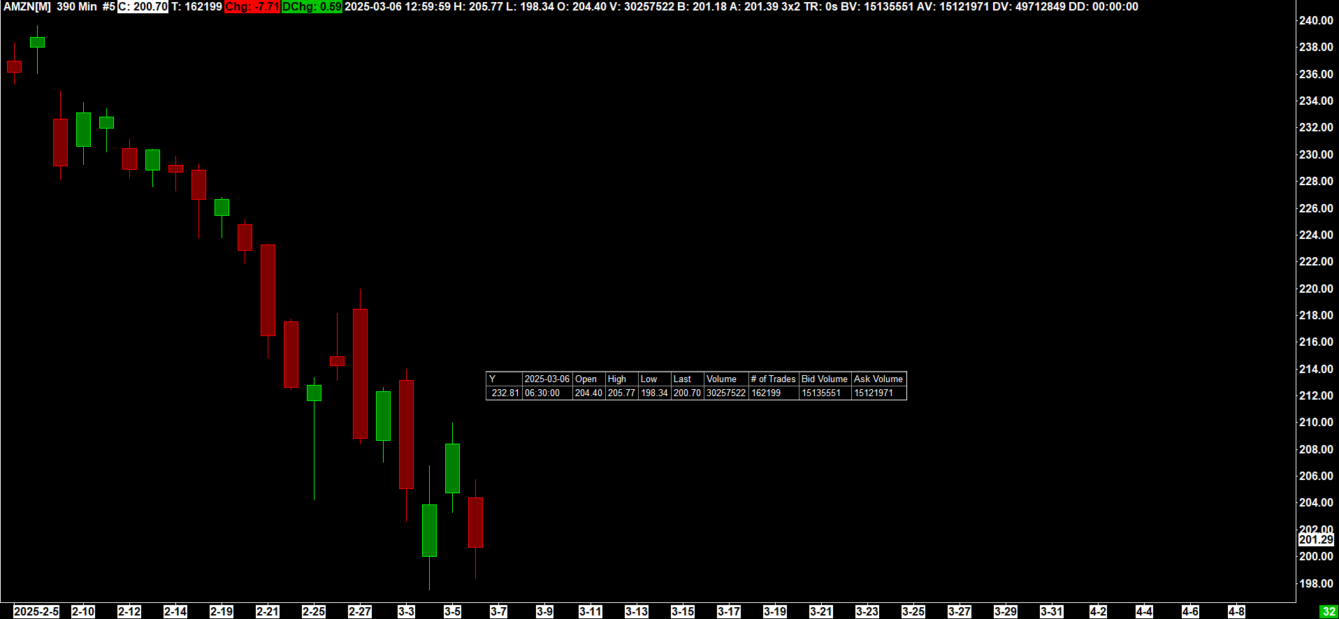

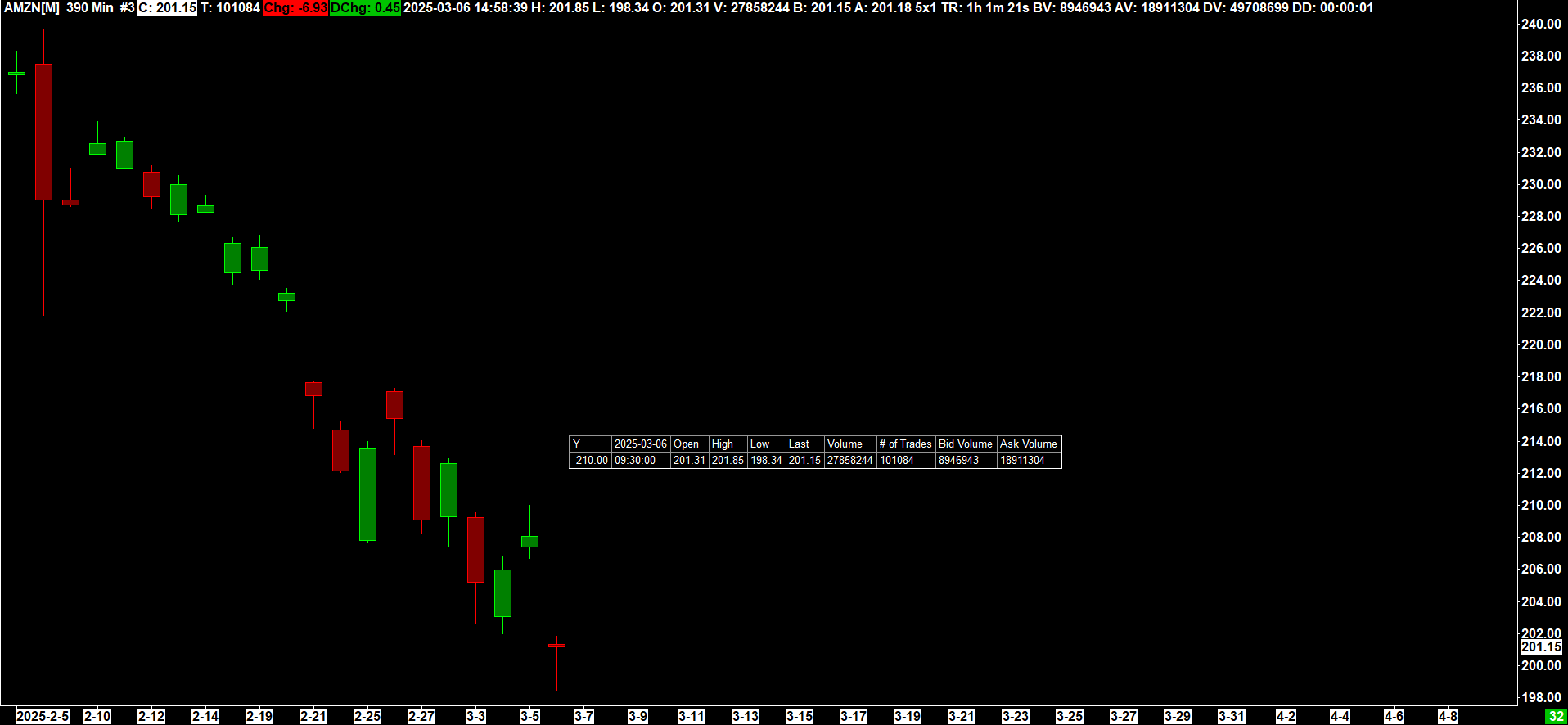

Hi. The two charts for AMZN must have different settings, but I'm not sure what those differing settings may be. I see the time stamp under the date in the chart values window are different. Could that be it? Also, what do those times indicate? Screenshots attached.
I used 390 minutes to create daily bars on an intraday chart, as I understand Ask/Bid Volume Difference does not work on daily charts?
AMZN 1: https://www.sierrachart.com/image.php?Image=1741301920920.png
AMZN 2: https://www.sierrachart.com/image.php?Image=1741301955411.png
[2025-03-07 14:03:57]
Your Session Times are different, to start with. Refer to the following:
Chart Session Times
There could be any number of other chart settings that can also cause differences, but we know the session times are different due to the times of the bars.
The times of the bars are the starting times for each bar. This is determined by the Session Times and the Bar Period.

Refer to:
Working With Charts: Resolving Differences of Chart Bars Between Charts
There could also be a difference with the Time Zone setting of those charts:
Time Zone Setting: Using Different Time Zone in Individual Charts
