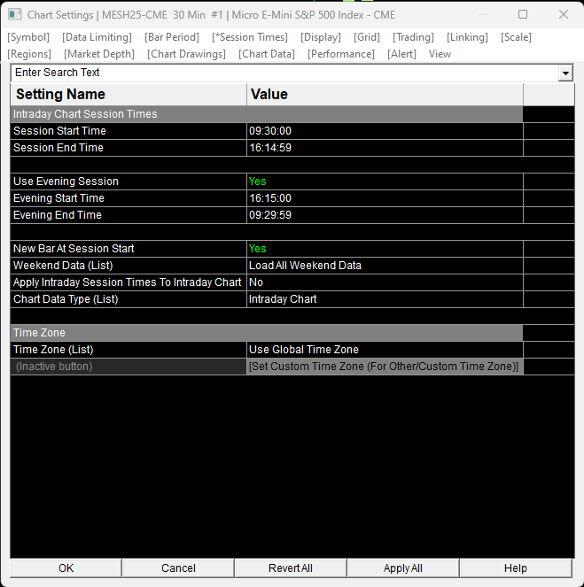

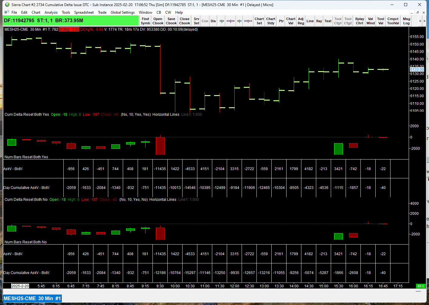

I am guessing that I am missing something trivial, but I have been searching and reviewing the documentation/support board for help to resolve this and cannot figure out what I am doing wrong. I have added "Cumulative Delta Bars - Volume" and "Numbers Bars Calculated Values" studies to my chart and expect the cumulative delta value to reset at the start of my session time (09:30:00, see Chart Settings image), but instead it only resets at the start of the EVENING session (16:15:00; see graph regions 4 & 5, where values continue accumulating at 09:30 but reset at 16:15).
The only way I can get values to reset at the start of the regular session is to set the "Reset at Both Session Start Times" study input to Yes, which I did on the duplicated studies in graph regions 2 & 3. Data Configuration is set to Tick by Tick.

The only way you would be able to do this would be to setup a separate chart with a single session time (no evening session) that covers the 24 hour period for which you want the Cumulative Delta Volume. For instance, set the following Session Times:
- Start Time: 09:30:00
- End Time: 09:29:59
- Use Evening Session: No
Then you can use the "Study/Price Overlay" to overlay that Cumulative Delta Volume to the original chart.
