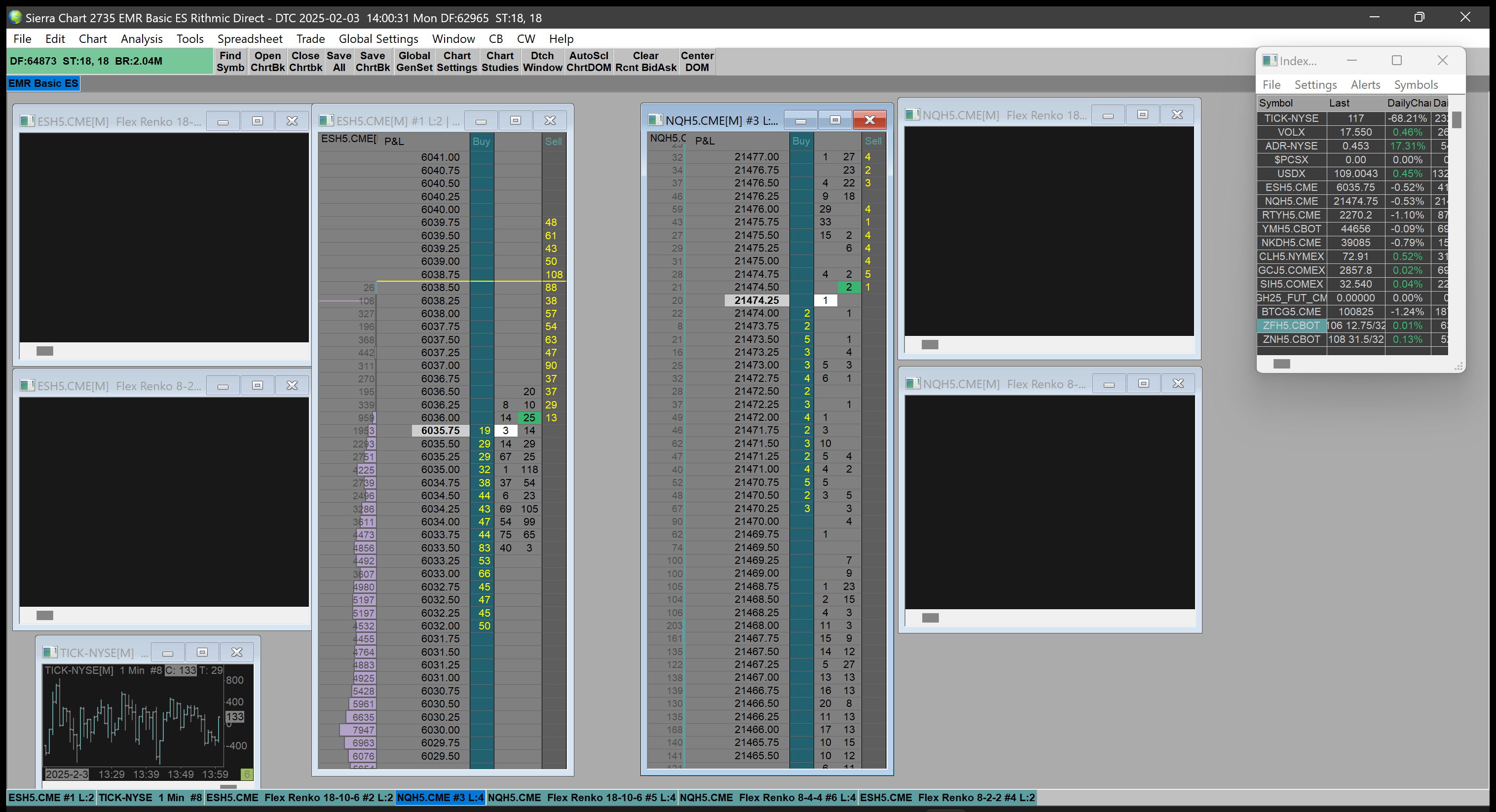

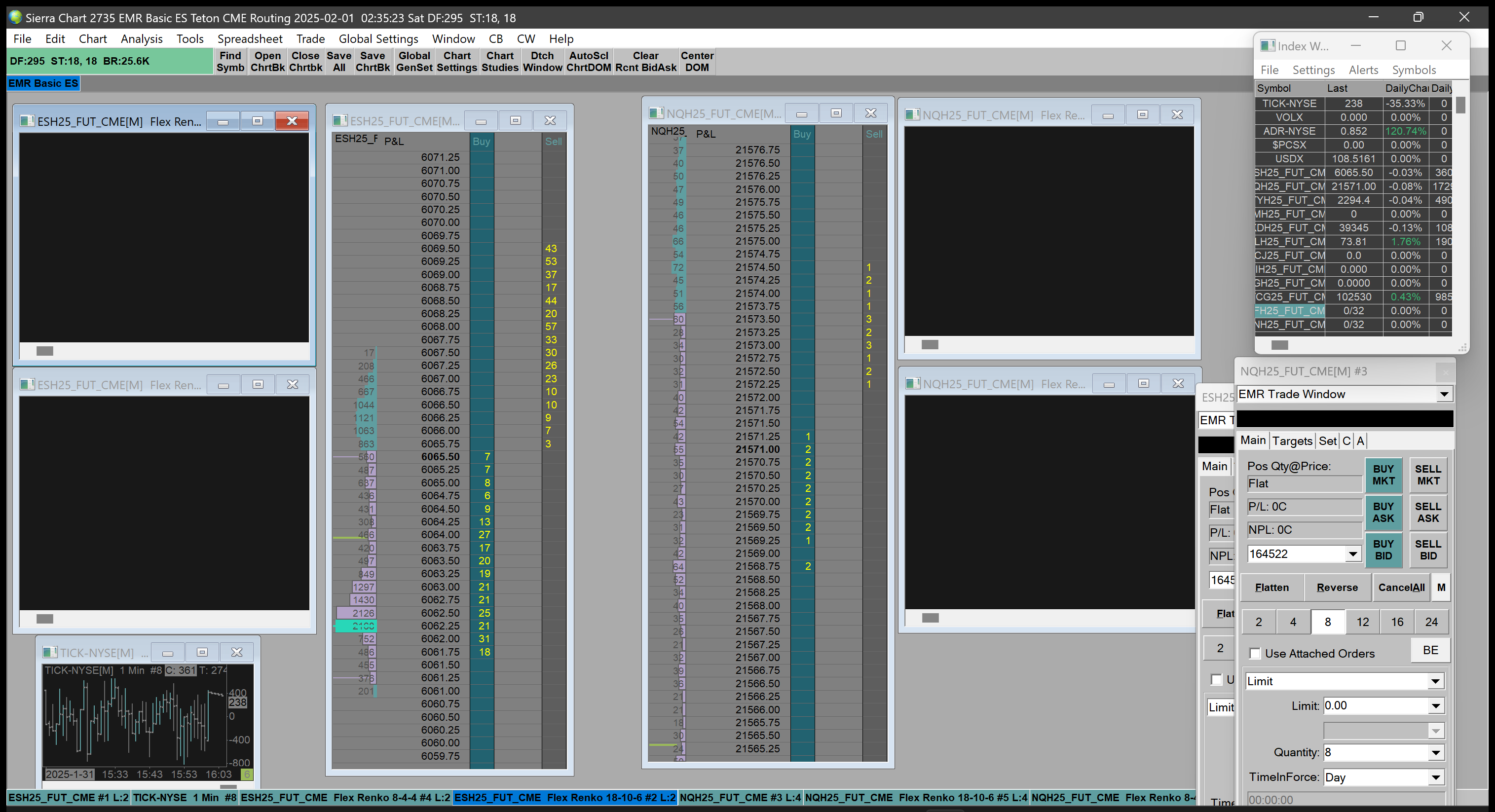

Good morning, Just updated my Sierra Chart to version 2728. I am receiving my usual DOM market depth data but my Renko charts don't seem to be displaying anymore. I've attached the screenshot below (taken Saturday morning so it's resting orders but it serves the purpose). I'm subscribed to Denali data and have an AMP futures trading account. My charts are simple flex Renko bars without any real indicators. Nothing complicated. I checked my account and logged into my AMP account and everything seems normal. I've been subscribed to package 10 and Denali data for a long time without making any recent changes. Lastly, I did some extra work on this and it seems that it's specifically the Renko setting that isn't working. I'm able to load all other Bar Period types except any of the Renko settings. It's not just Flex Renko that I use but I am unable to load any of the Renko bar periods. Can you please advise if you have any recommendations? Thank you for looking at this. https://www.sierrachart.com/image.php?Image=1738395325863.png |

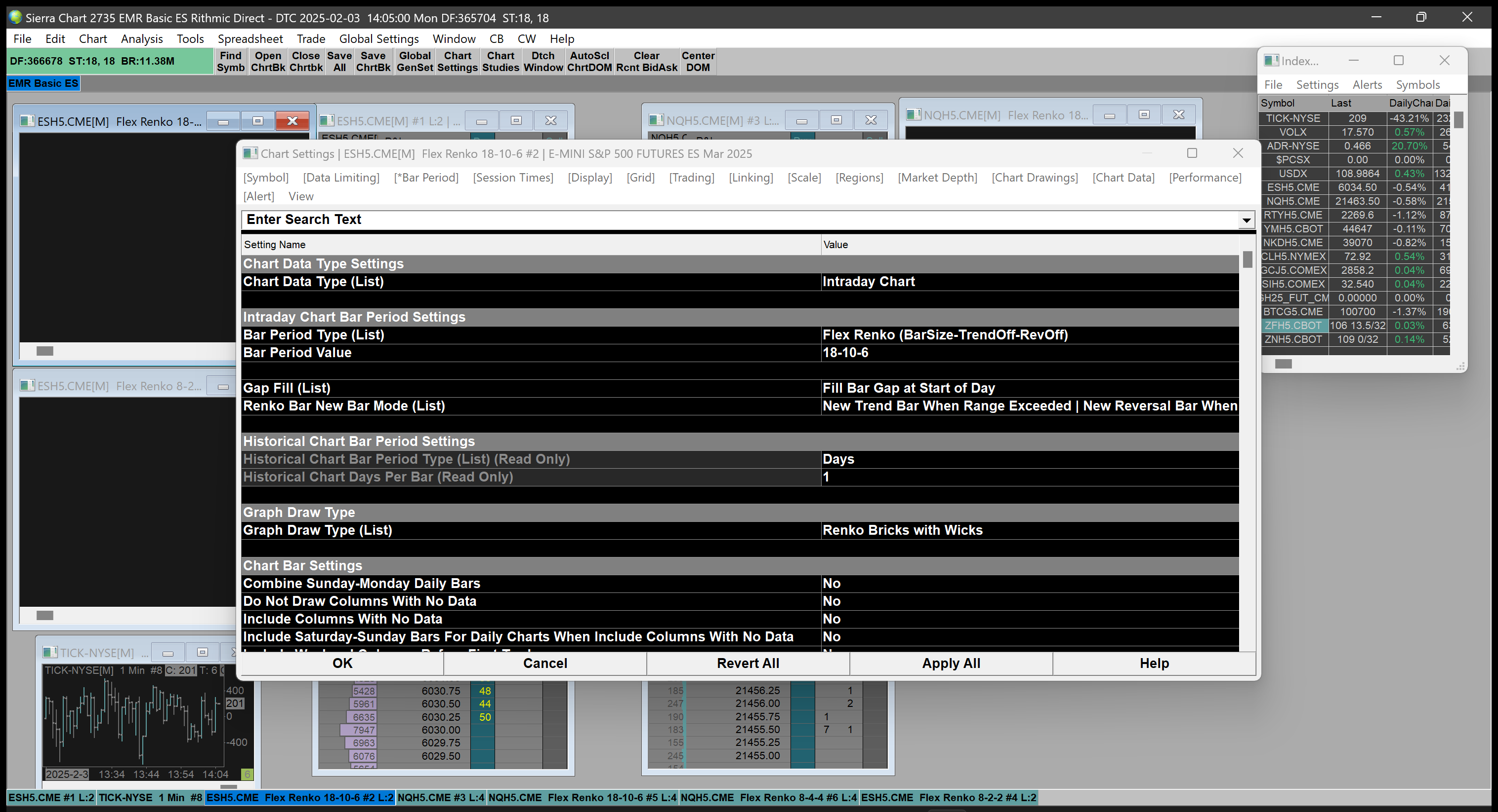

Thank you for the follow-up. I forgot to mention in my original post that the Renko charts returned to normal functioning when I reverted my Sierra Charts back to the previous version. Additionally, it is not only the Flex Renko that isn't working on the current version. It is all Renko bar period options. Attached is a screenshot with the market open using the current version. https://www.sierrachart.com/image.php?Image=1738609231449.png This is a screenshot of my current chart setup https://www.sierrachart.com/image.php?Image=1738609502895.png |

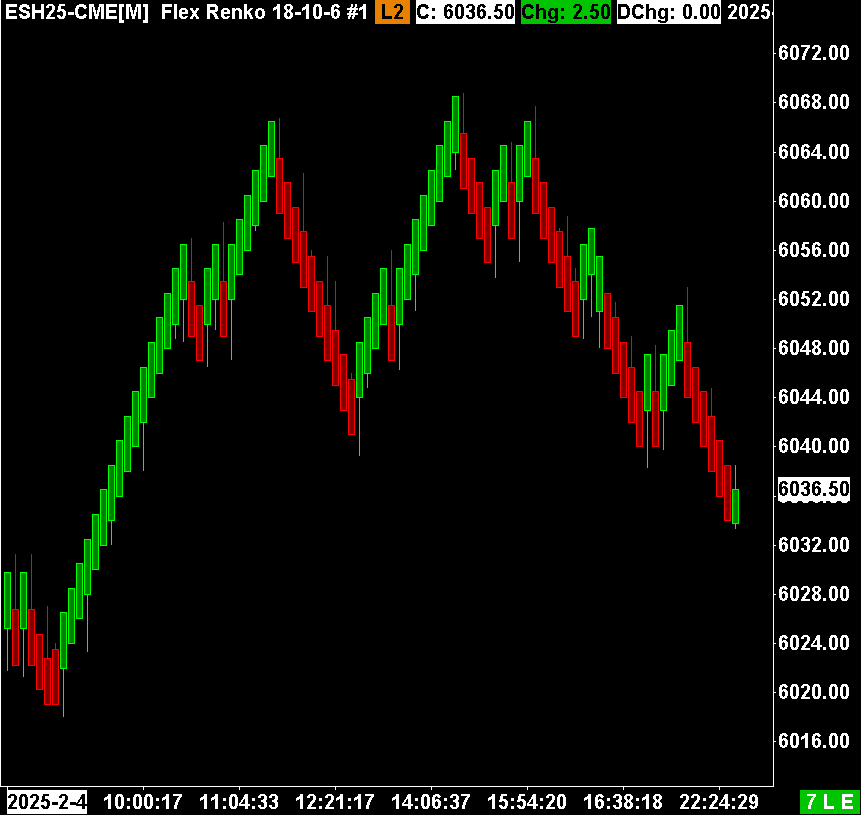

We do not see any issues, both of the charts load just fine. This is one of them: https://www.sierrachart.com/image.php?Image=1738733301563.png Sierra Chart Support - Engineering Level Your definitive source for support. Other responses are from users. Try to keep your questions brief and to the point. Be aware of support policy: https://www.sierrachart.com/index.php?l=PostingInformation.php#GeneralInformation For the most reliable, advanced, and zero cost futures order routing, use the Teton service: Sierra Chart Teton Futures Order Routing |
